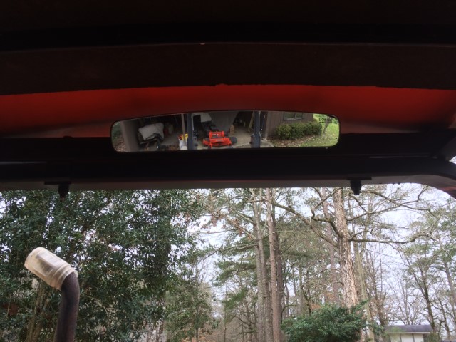

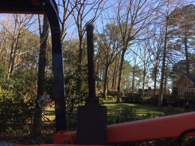

I like that exhaust flapper!
Yup, that exhaust is my next project. Dogleg it over to the canopy post and then a full 90 degrees outward.

After I added the 4 post canopy it seems logical to me to use the strength of the front post to support the unsupported exhaust. Just gotta be sure that the exhaust does not interfere with the FEL.

Magicman, I would be inclined to not attach the exhaust to the canopy support. Let them both be independent and not put torque on each other if something does move a bit.

I understand and that is a subject that my son and I have been discussing. I was considering the rubber thingy that is on a tailpipe hanger. The objective is to keep a limb from bending it back.

You could get a bearing race just a bit larger then your exhaust pipe. Have the exhaust come up through it and out here you want it. The steel race would be welded/attached to the canopy to you liking. This would give protection to the exhaust and still not be attached. Mount the race up high to give max support.
