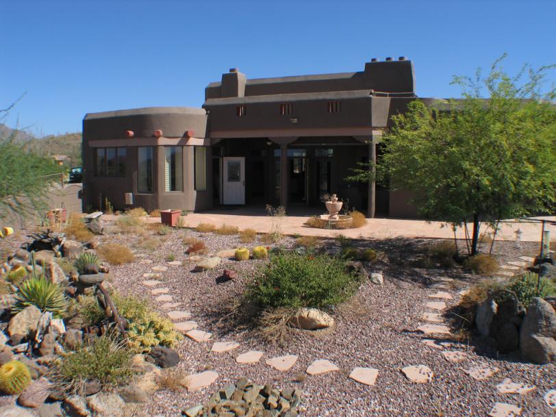

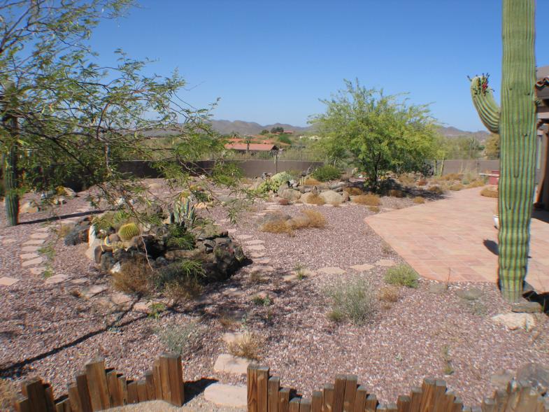

My Kubota helped turn this... (gack)

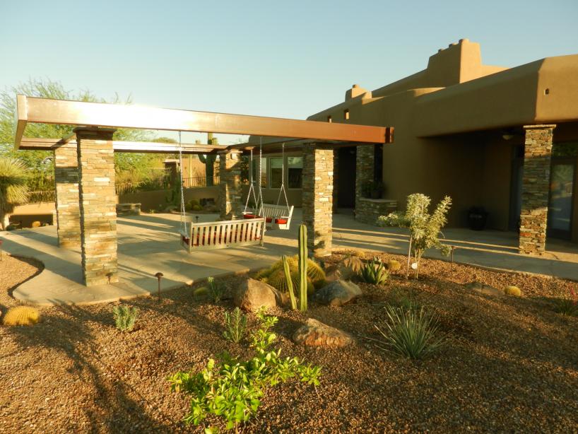

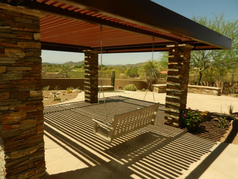

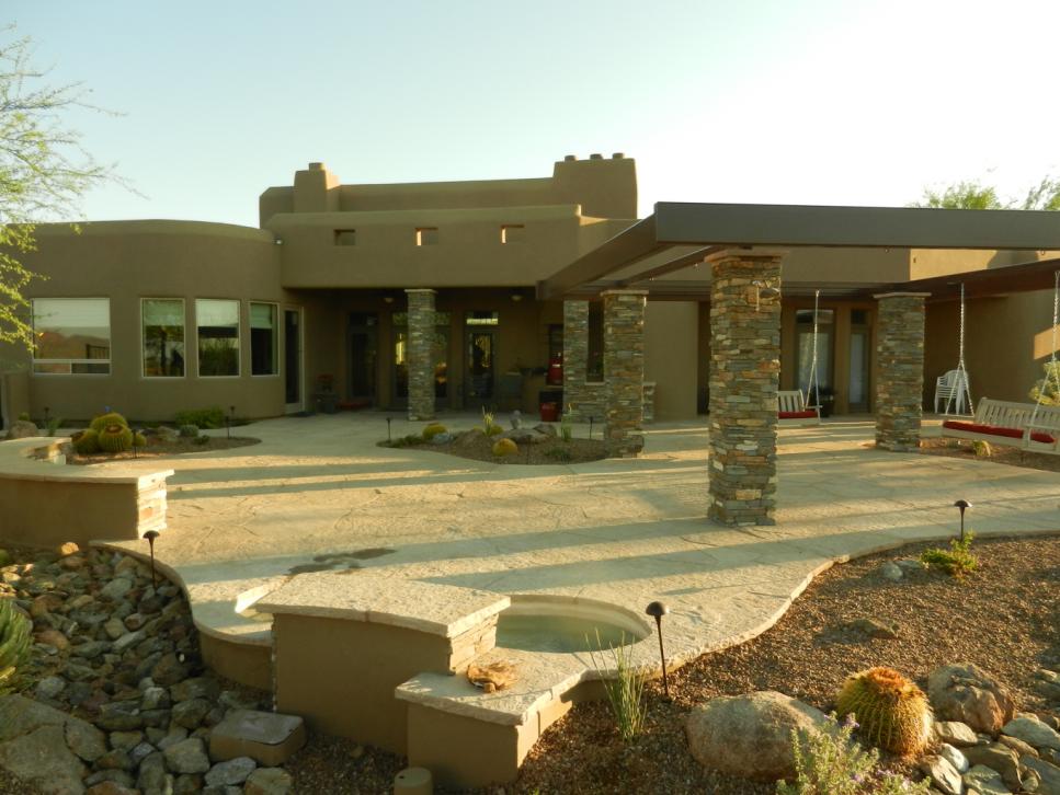

...into this...
My Kubota "disassembled" the old yard, both by moving boulders and some large plants. I also raked up and hauled away 25 tons of existing rock to be used elsewhere on the property. It hauled out tons of jack-hammered concrete I cut from the old patio. It graded the location for the new concrete addition. It hauled in a few tons of fabricated steel for the shade structure then, It raised the steel in to place so the welders could weld it up. It hauled in 80 tons of flagstone and 30 tons of dirt and another 30 tons of finish rock. It hauled in all the new plants as well as some old ones that were too heavy for us to pick up.
In doing all of this, it nearly paid for itself in this one job. We will start on the front yard this Fall.

Thanks guys...
Nope! Haven't had the pleasure of meeting Bill yet. I'll have to hook up with him this fall...

Looks awesome,Ray! Now go park that machine, put your feet up and enjoy your hard work. You earned it.
