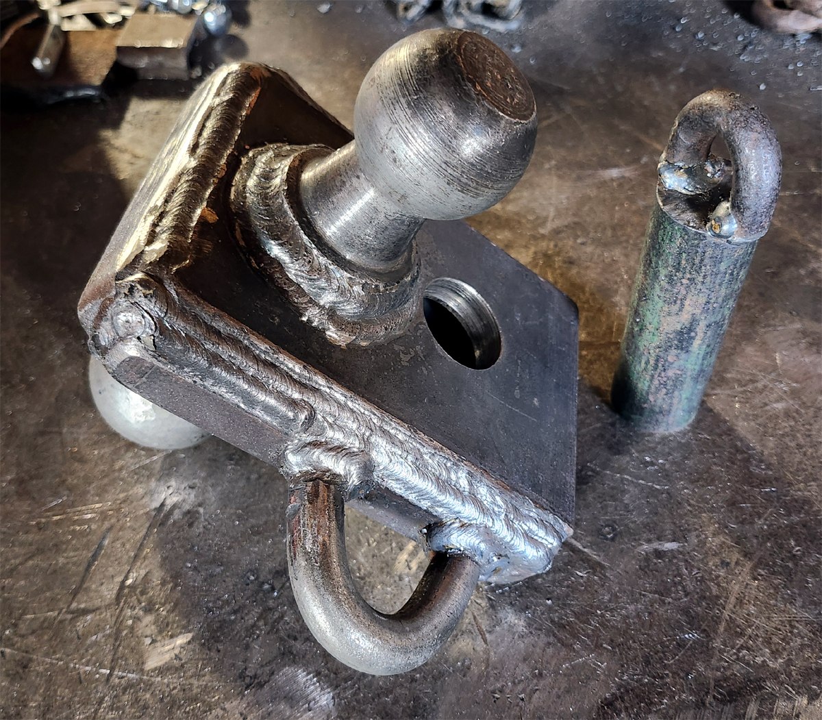

I made a "turnover ball" this evening for the pallet forks using 1/2" plate and some 2" and 2-5/16" balls I've been tripping over for years (don't know where I got them). Last year I cut an 1-3/8" hole in one of the pallet fork tines so that I could mount ball hitches that have a threaded shank and nut, but it's annoying to change them out when I'm moving trailers with different sized couplers.
The hardest part of the job was cutting and attempting to drill the 1-3/8" round bar that I took off a very old JD coulter. It's as hard as anything I've ever encountered so I gave up on the idea of drilling a hole for a spring loaded clip, and welded on a low-profile loop instead. I added a link from a piece of old chain to the front of the hitch so that I have a place to connect safety chains.
I'll test it out tomorrow when I move a couple of trailers around, but it certainly fits on the tine, the pin drops in and all is good. It takes all of 10 seconds to switch from the 2" ball to the 2-5/16" ball or vice versa.

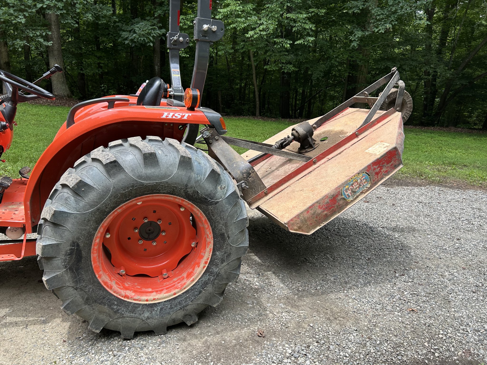

It has rained so routinely this spring/summer it’s been near impossible to do much past mowing the yards in the tight windows where that’s possible. Mostly been quick little jobs in between storms.
Some of the stuff on the sewer line was getting a bit high for my liking being we use it for a Mule road and I prefer trees not take it over. It wasn’t as dry as I’d like, but I have a front wheel assist tractor with a differential lock for going straight and split brakes for turning. No point in having it and not using it.
Most of my implements that are actually used are on dollies in the concrete floored shop so they’re easy to hook up without a quick hitch. The bush hog lives in the dirt floor pole shed. I have at least a fleeting thought of a quick hitch every time I hook it up. It weighs a bit over 500lb so I can’t exactly toss it around, but I can scooch it around a bit to line it up. Today, had my Apple watch on and decided to time myself from this point to hook up without rushing or intentionally being slow. Over 10 minutes, get a quick hitch. Under 5 minutes, no quick hitch. In between, maybe.
Just under 5 minutes later… Was conflicted on whether to be happy or disappointed. Either way, no quick hitch in the near future. Top and tilt speeds the process. Not sure how much but definitely some.
Fuel up. Loader on for front weight and front bumper. ROPs up. Seat belt engaged. Some of the area we’re going is flat, some not.
Some stuff was 6” high, some 7’ high. As expected, a few places were softer than ideal. 4WD and brake steering were both required. Wasn’t bad enough to ever need diff lock.
Better. Didn’t do the entire sewer line. Some was too wet to mow without tearing it up. Some didn’t need it as bad as this section. Got the worst of it, though.
Back home to reconfigure for the flat areas with trees near the houses. Loader off to fit in between trees.
ROPs down to fit under trees. Seat belt doesn’t go with folded ROPs so no seatbelt this time.
Started with the old section of the field in front of our house.
Ran out of time before making it to the front fields. Maybe later this week if we catch a couple days without rain.

I'm sure we've all rushed a job trying to get it done and made a bad decision because of it. I didn't like the safety chain "loop" that I added to the turn over hitch. I knew it last night and didn't like the appearance or functionality, and in the cold light of morning I thought "hell no!".
I found a piece of bar stock in my scrap pile, bent it into a loop with the hydraulic press and welded it in a much better position. I used the plasma to burn off that hideous piece of chain link on the end and cleaned it up with the grinder. Now I'm ok with the finished product. I'd still like to drill out the pin for a retaining clip so that when it's not being used, the hitch and pin will stay together. No doubt I'll be using the Drill Doctor quite a bit to get that done.
By the way, it would have been more work than needed to separate the balls from the steel that they were originally welded to so I used a grinder to make the bases as circular as possible with the original plate adding a little extra height, hence why the welds look the way they do.
I'm going to move two trailers later today and will take a photo or two showing this thing in action.

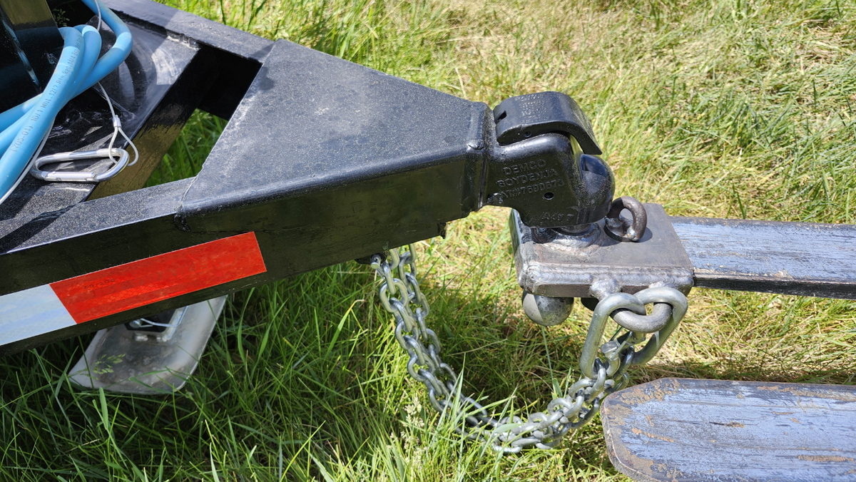

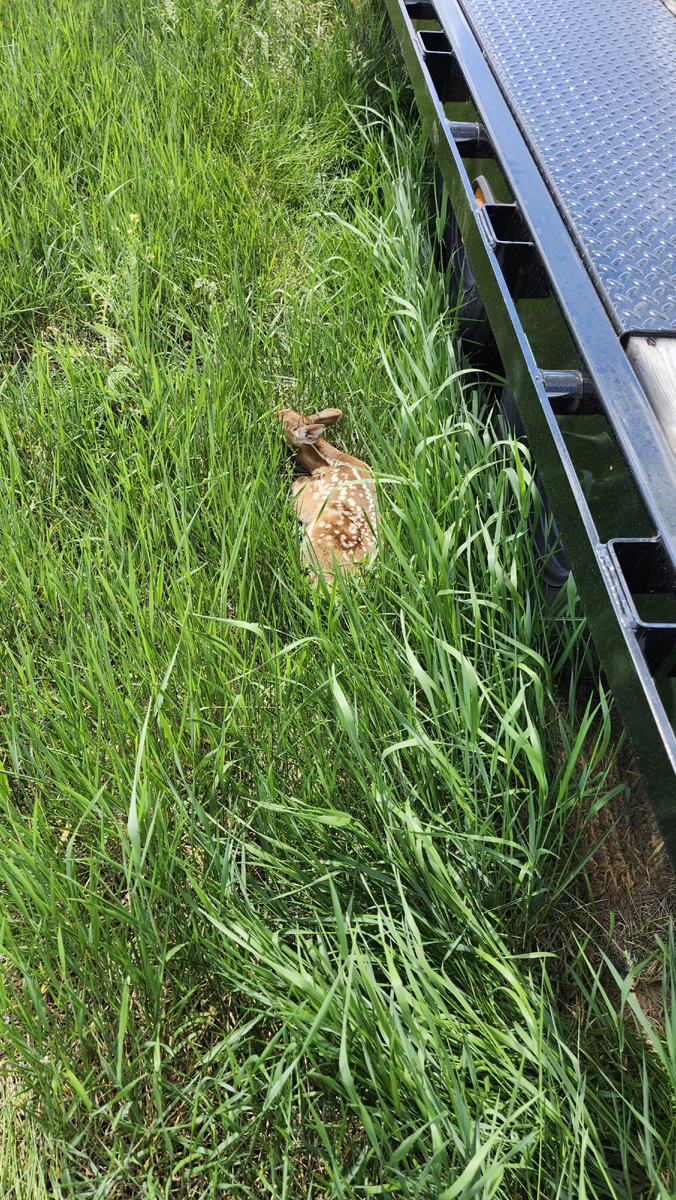

I got the smaller trailer moved, but as I was about to move the bigger trailer a fawn hopped out from underneath. Thank goodness I didn't injure him/her! :oops: The bigger trailer will be staying put until the fawn has moved on.
I placed a large piece of plywood up against the trailer to keep the fawn out of the sun and protected from attack from above. I'm sure he/she was nicely tucked away in the tall grass under the trailer until I came along. I filled up the water troughs that I take care of for deer and such since I'm sure that mum will be thirsty.
You can see how the turn over ball hitch works. Overall I'm pleased with it and will call this one done.
V2 looks a lot cleaner and nice save with the fawn.

When the little guy hopped out I had two thoughts since all I saw were the tops of two ears. My first thought was that it was a big bunny rabbit (I have one or two around), and then when I got off the tractor and investigated I was concerned that I might have run him/her over.
I went out this evening to check on the fawn and all appears to be ok. It's still next to the trailer and under the plywood and appears to be fine. Mum should be around later this evening. I think I saw her a few days ago under the kitchen window looking as round as a barrel.

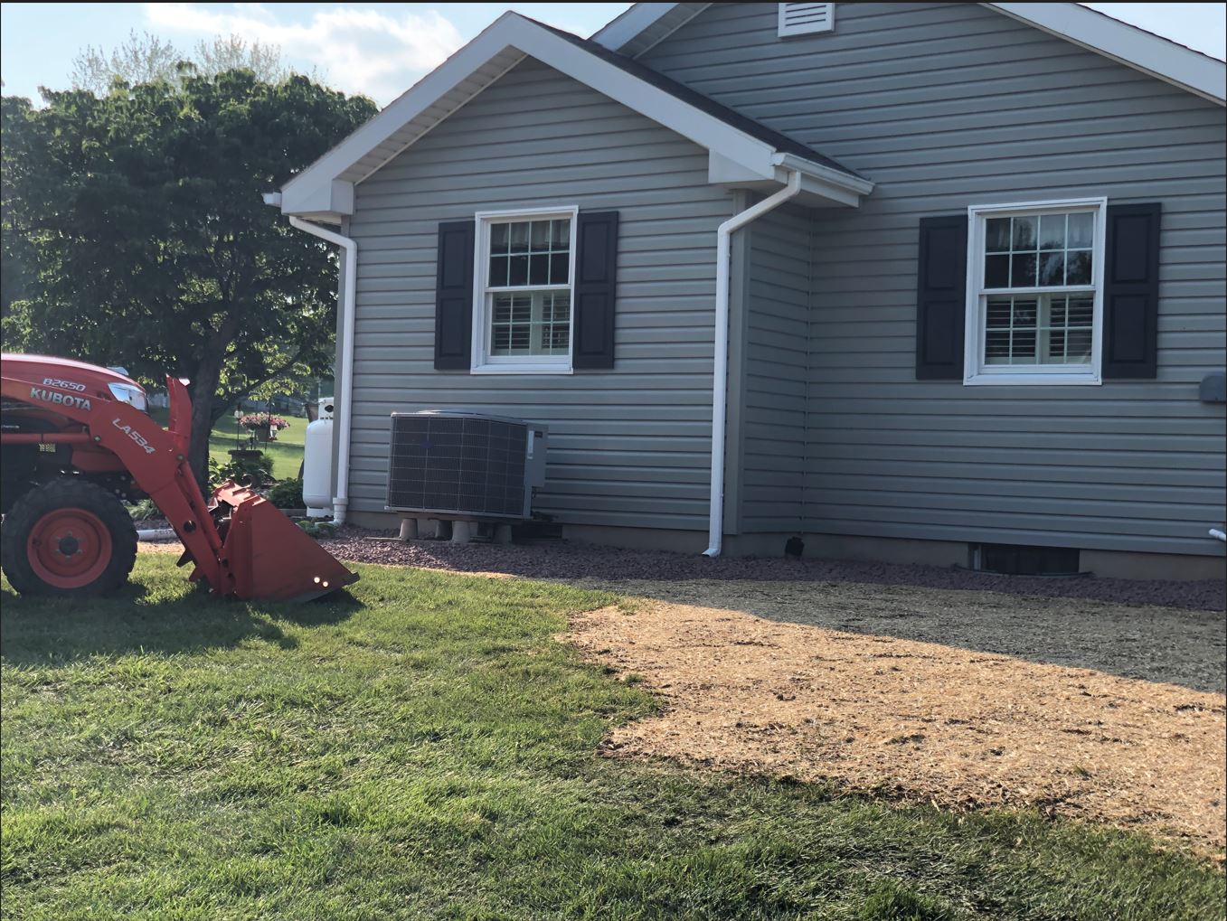

Did a little "landscaping" job today. It was hot, and it wore me out. anyway...here it is:
Start...yuck..I left it this way last fall after pulling out shrubs and lots of "ugly" stone.
another shot at the start this am
stone (yes, had to offload into the bucket from the truck :()
Fabric, edging and stone done... 5 yards of topsoil to go.
seed fert and straw in.,
done: clean install, time to go home.
