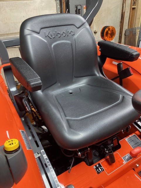

I added the arm rest kit to my new L2502

The new seat and suspension system is so much nicer than the seat on my L2501.

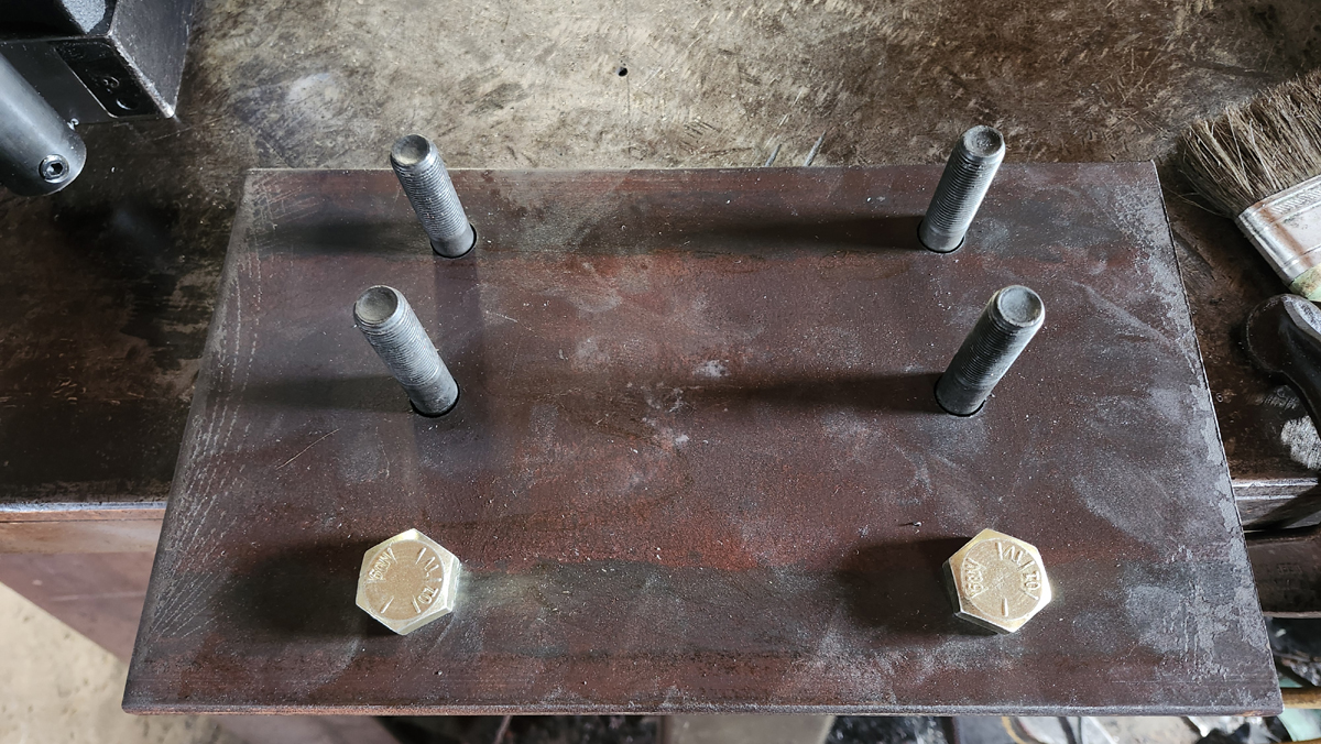

I also picked up a piece of 8"x5/8" flatbar that I had the steel supplier cut to a length of 14". I drilled three sets of holes in it. The top four holes are for 16mm bolts that will pass through the front weight bracket, the spacer plate and brush guard, and thread into the frame on the front of the tractor. I'll weld the plate to the front of the brush guard tomorrow. The bottom larger bolts will be used to bolt the front weight bracket to the brush guard so that they're a single unit which will make it much easier to bolt the entire thing to the tractor. The 5/8" plate acts as a spacer to provide clearance for the suitcase weights. Without the plate spacer there's no way to get the weights on due to interference between them and the brush guard. Thanks to @Russell King who suggested I do this almost two years ago! 😂

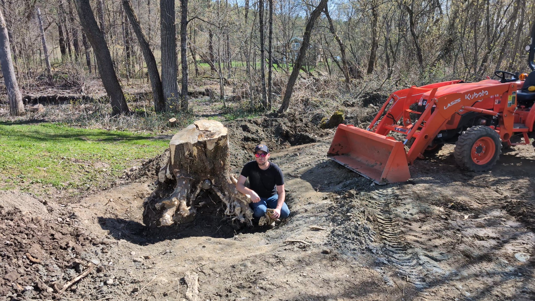

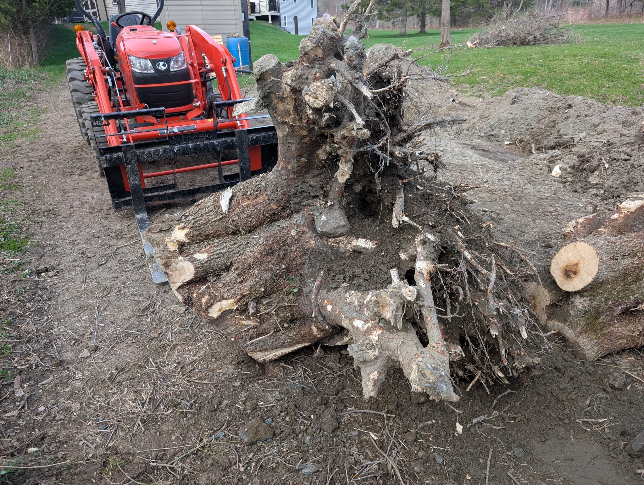

I can't believe, but I got that big ol' stump out!!!!
It took me a week worth of digging with a shovel, swinging an axe and using a wrecking bar. The tractor couldn't lift it very well but once I removed most the dirt from the stump I was able to move and lift it a little with the bucket. I never dug out a stump this big before.
it's so satisfying to get it out after all this work.
Smoothed out the area after, need to get some clean fill but I need get a couple more drainage pipes to finish extending the drainage line from the house and then top soil it all and seed some of it. Part of it's gonna be my parking area from of the tractor attachments. Going to relocate my shed to somewhere in here at some point.
Things are looking better each time!

Try cutting vertically with chain saw to split the stump in half and then quarters. Do your best to keep chain out of dirt/rocks. Then concentrate on removing one quarter at a time. Or make friends with someone with an excavator. Good luck.
