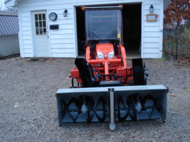

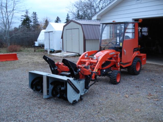

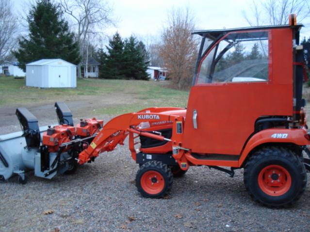

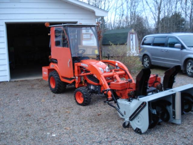

Hi all, new to the forum so thought I'd share what I did.
I reworked two "walk behind" Craftsman snowblowers into one to quick attack to my new Kubota BX2370 front end loader. The two blowers worked out to a total of 60" wide and have their 10 HP engines running them. I removed the drive wheels and the drive mechanism and built a three wheel center caster to support the rear section with castors and skies on the front. The engines now have 12 volt starters, chute rotation, deflectors and auger engagement all have 12 volt actuators controlled from the cab. The Kubota loader handles the weight great although the blowers will ride on the ground with the tractor just pushing and steering them.

Its time you learned rule #3.pictures or it didnt happen. Lol
Sounds like something i wanted to do a while back, except hang it on my truck.

That's a wild looking set of blowers Russie it must have been a lot of work.
I just finished my own little mod on my blower except for paint. I put actuator on deflector chute and motor on rotator.

Yes a lot of work, hope they get the job done !!! It will be nice to have the actuators on your chute !! Good luck !

Clever! And very professional-looking.

Nice fit up Russie you'll be stylin' this winter. :cool:

Nice job on the dual setup. Looking forward to some action pics or maybe some video action.
