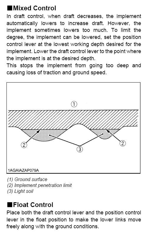

For those of you that might be interested in using draft control for grading purposes. I will explain how I set my tractor up when using draft control.
First off, you need to know the tractor's capabilities. So with the implement that you are using, how deep of a cut can it make without ever stopping in the ground that you are working in?
I have a 9' blade that weighs in at about 1200lbs. I use it behing a 75HP tractor that weighs just over 12,000lbs as ballasted not counting the rear blade.
I have 3 sensitivity settings for my draft control, I use the most sensitive for using my rear blade.
On my tractor that is the top pin position for the top link
I can pretty much cut 3" anyplace on the property.
So I set the position control for a 2" cut. 2" doesn't sound like much, but it loads a blade up pretty quick.
Then with the tractor stopped in place with the implement in the ground making that 2" cut, raising the draft control lever up from being all the way forward very slowly I watch for the the first sign that the hitch wants to lift. At that point is where you want the draft control lever to be set.
The draft control is now set to go to work.
You do not move the draft control lever while you are doing said task. You can move the position control for when you are positioning the tractor, but you need to besure that the posion control lever is put back to the location allowing for your desired cut depth.
The position control lever stops the tractor from cutting to deep and the draft control keeps the load on the cutting edge from increasing beyond what the tractor is capable of moving.
I have excellant results using the draft control for grading with all 3 of my grading implements as well as ripping with my scarifers. My box blade scarifers go in the gound 10", so it can be a real load on the tractor, I set the sensitivity for the least sensitive setting which is the 3rd hole down on my tractor.
The tractor is never bogged down when using the draft control feature.
Once you get use to setting this feature and make use of it, you never have wheels spinning digging in making a mess. You simple set it and go without all the inconvienances there are without making use of this wonderful feature that so many of our tractors have.
People think that it is just for plowing. Think about the load that it can put on the tractor when a cutting edge is in the ground a few inches and cutting 7, 8 or 9 feet wide. 7 or 8 scarifires in the ground 6-10 inches deep. It can be as much or more than a plow would be.
I hope that some of this helps out those of you that are interested in making use of the draft control feature. (y)

That’s a great explanation! 👍
Would be a good “Sticky” in the Implement or Operating sections (?) of the Forum…I could easily envision someone asking the same question in the future....😉

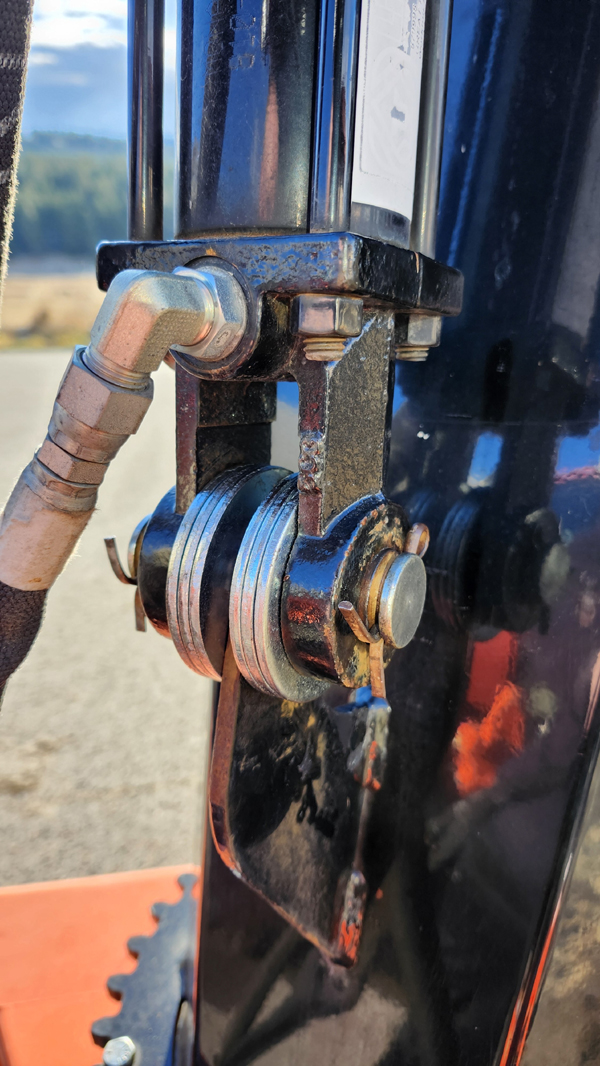

I couldn't leave well enough alone so one final tweak this afternoon to the snow blower. Ever since buying this thing a few years ago I've been a little annoyed by the amount of lateral play that the chute deflector cylinder has. I'm talking about an inch of left to right movement!
A simple fix was to stop by the hardware store and buy twelve 1" washers. About $20 later the cylinder has just a bit of play left to right, so not an expensive tweak to improve function and pride of ownership. :)
I like your solution I’ve got a few sloppy attachments.

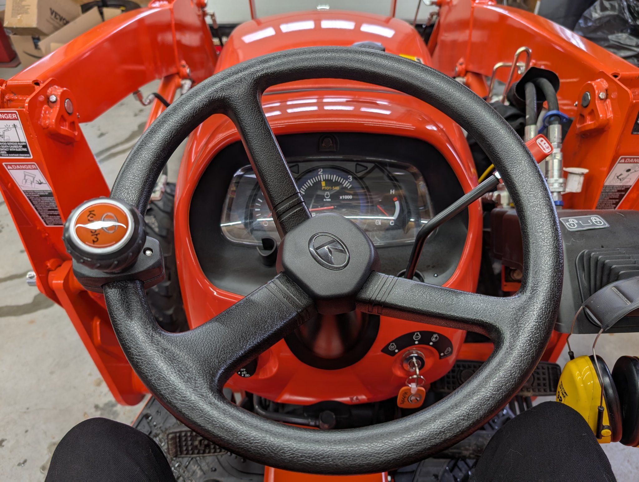

Went to the Kubota dealer today and picked up some more accessories. Got a steering knob, I'm not 100 percent sure on it yet but I'm gonna give it some time. It will definitely make it easier to use when I have winter gloves on and I'm sure it's gonna be better when I'm doing loader work but I feel like it's almost too easy.

Your going to like the knob for steering. I never have used one in my many vehicles. But tractor came with one. Just easy when running FEL. Know what you mean at equipment dealers. Want a mini ex but not going to be a dealer purchase. Nice to see features before going on the hunt.

Congrats, if it's like most other kubota tractors, don't get hung up on where you place the spinner. It will be located in another position on the wheel next week. The wheel doesn't return to the same position like a car.
Not wizzin on your parade...it's just the the way it is.

I think because the L2501 has regular steering box instead of hydrostatic it's gonna return to the same spot. But I don't know for sure.
