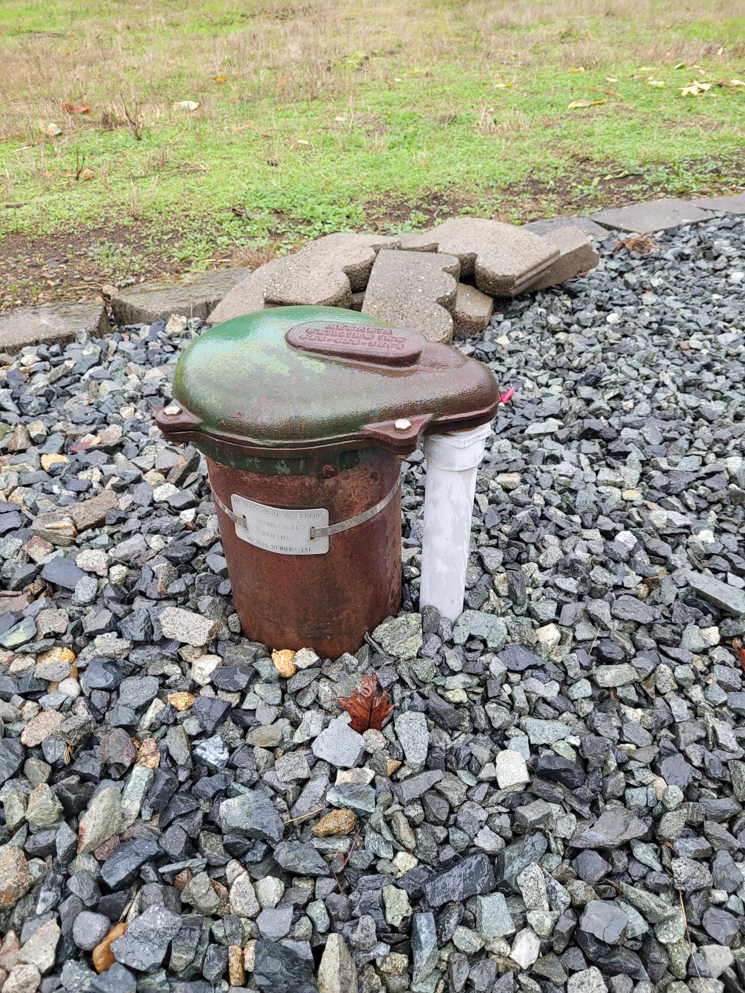

BTW, in case anyone is interested, here is a picture of the well head a few minutes ago.

Looking at the picture I posted of the well head, Can you tell me where the pitless adapter is? It is my belief that the wiring for the well pump is located in the white PVC pipe that is connected to the wellhead. I have never taken the top off the well head because I was advised not to by my general contractor friend. I really don't want to doubt anything that he has told me but he is not a well driller, he subcontracts them when he builds houses around here. He has built many of them through the years so I guess he know something. See post #68 for a picture of the well head.
34,315
9,535
The pitless adapter will be 3' or so down in the ground connected to the well casing.
And yes the PVC pipe is just the wiring.
You can safely and easily pull the cover off the well head and have a look down in there.
Thank you!
8' to 10' is standard here in WI, below the frost line and deep enough to not get dug up (unlike my gas line). :mad:
So, yours may or may not be deeper than 3', and if it is that's not uncommon.
You might put a strap on your flashlight and any tools you use, because once they get loose of your grip they're headed for the hole....

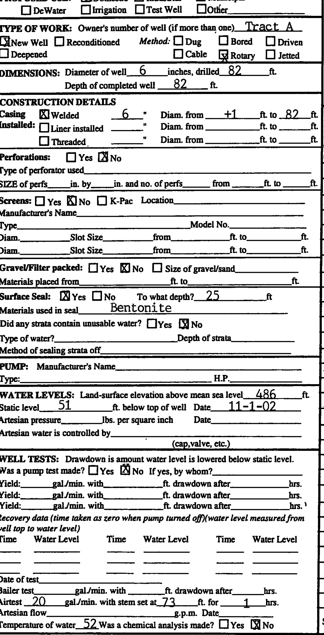

I have water that is naturally high in magnesium. My water is also very soft with a PH of 6.8, without treatment. I have measured levels of 6.6 on at least a couple occasions through the years. The only reason I have measured the PH of our water is to make sure the balance is correct for our hot tub. I measure the ph after a complete drain and refill of the hot tub twice per year.
Off subject, but an observation, your water is very acidic, do you know if your casing is metal all the way down? It could prematurely eat thru the casing, just something to be aware of. I have naturally soft water with a PH of 8.4, my neighbor 1/2 mi. away has a PH of 7.6. He let me buy a 1/4 share of his super well, so I trenched 1/2 a mi. put my own elect. meter on his well house, now I have plant friendly water.
armylifer
Mar 26, 2013
2,240
1,001
Thurston County, WA
I am aware that my water is acidic. I think that my well casing is metal all the way down. The well casing is pretty thick and I expect that it would take several to many years for it to erode through. The well was drilled on Nov 1, 2002. I have the original well report. The report says that the casing is +1 foot to 82 feet depth. It does not list a lining inside the casing. It says the well was rotary drilled and lists the type of soil and depth of each change in soil composition. The report is pretty thorough and detailed. There are no screens used and there is a surface seal of bentonite to 25 feet, if that means anything. Here is a portion of the report. The other portions contain personal data and extraneous information that is probably not relevant to this thread. If any of the information below is helpful, please let me know.

1' casing, very impressive. If you did notice any deterioration of the metal casing, I would believe that a smaller, poss. 10" or 8" PVC might be able to fit inside. When you put a new pump in, which might be many years, have a camera dropped to asses' potential damage. My pump was replaced 25 years ago which is unusual, prob. the high PH and my metal storage tank is 40 yo with no rust.
armylifer
Mar 26, 2013
2,240
1,001
Thurston County, WA
I think the casing is 6", not 1'. I may be reading the report wrong but that is what I see. To be clear, the casing is 6" diameter and stands 1' above ground to the depth of 82'.
