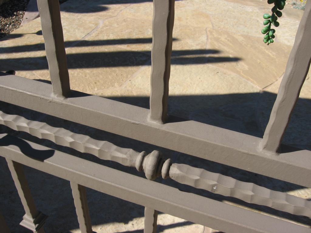

Wish I did live closer! I can always use more advice. This was my second project (the gates I mentioned) two years ago and the quality improved somewhat once I got the gas turned on! LOL...

That looks pretty good, Ray! Your at the point where the more you weld the better you will get.

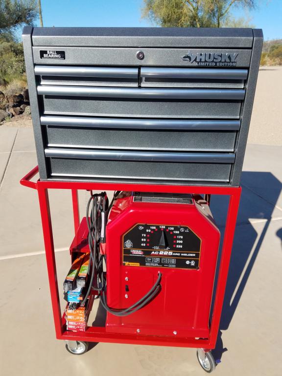

Got the latest welding project done using some of that super sweet "Eye-talian" wire. I welded up a cart to hold my tombstone welder.
The upper box was $45 new. I think it's a second but it looks and works great. I moved a lot of tools for my MIG into it. The roll-around handle is made of a section of one of my old down rods from the old ceiling fans in the living room. The side pieces of the handle are 1/4***8221; plasma scraps that work really well for all kinds of projects. The welding shop throws tons of this stuff away. The Lincoln is the AC only model but I have a MIG for most stuff. This will be for heavy material like welding on the hitch to my tractor box. For $200, I couldn't pass up a brand new stick welder.
Used ammo boxes for rod storage. The cart has a small footprint but rolls easily. Much easier than lugging it around...
Now on to the next project...

Very nice Ray!
I have wanted a tombstone for a long time and have used several of friends and/or work owned. A few years ago my neighbor up north (same one I bought my B7100 from) let me weld something for him, using his VERY old Lincoln tombstone, and it spoiled me for anything else. I don't remember the particulars, but it was huge, probably twice the size of yours. He says the wiring, bus bars, and everything else inside is also huge, which accounts for it's very smooth arc. Even I made pretty decent welds with it. I've told him that if he ever sells it, I get first shot.
