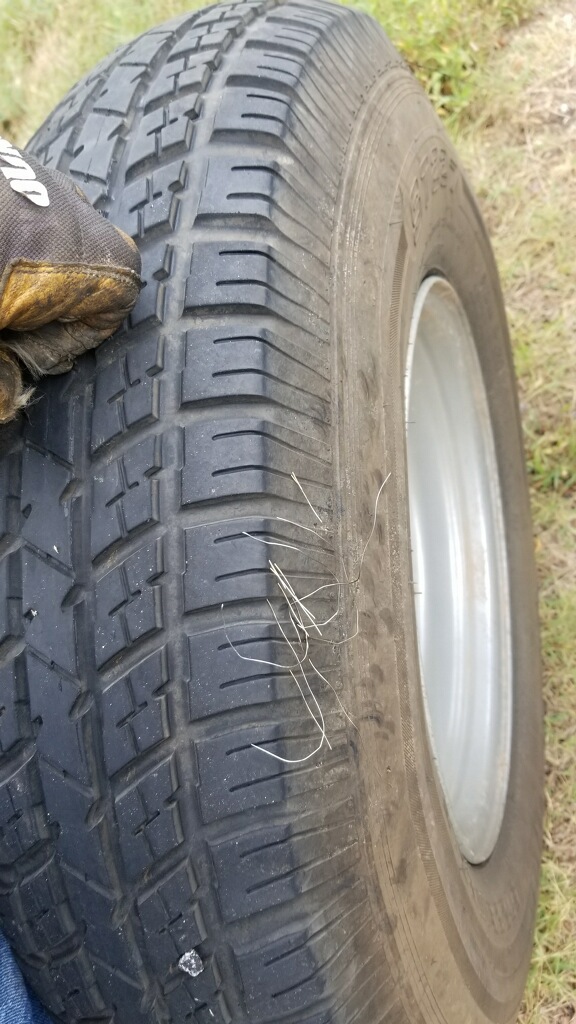

so today was a first. I was hauling a piece of equipment to a jobsite.
Noticed some vibration as I was driving. But that stretch of interstate was rough anyway. When I was was taking off at an intersection after exiting the interstate I noticed the equipment hoping on one side like the tire was flat.

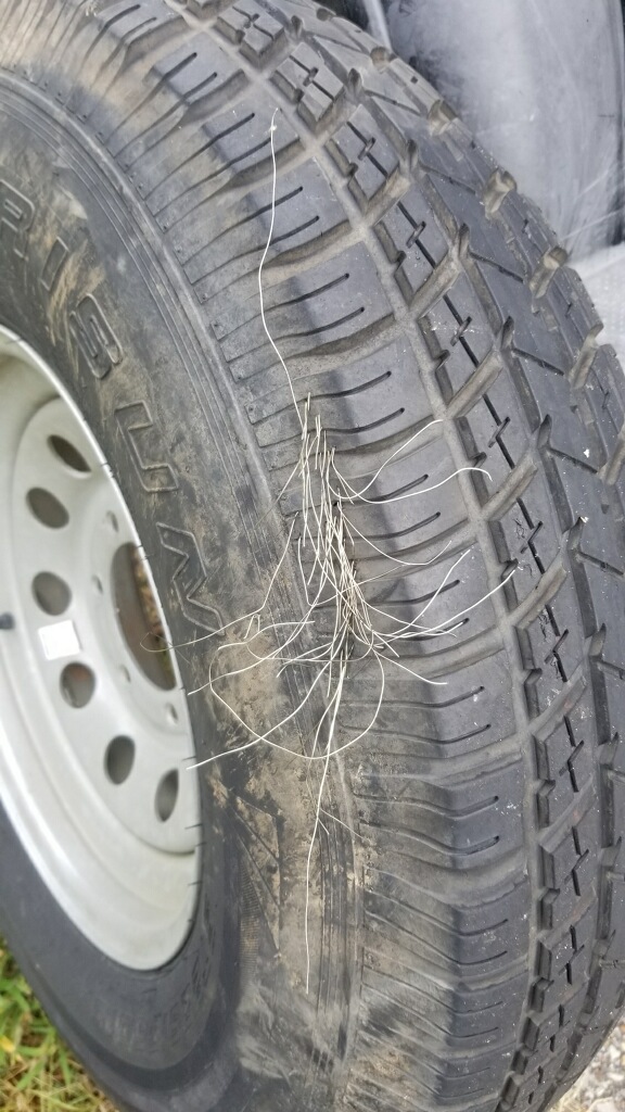

Well I pulled off the road and checked the tires. The tires were still good. But one of them sprouted wire 🤔🤔🤔🤔 And I don't mean that the cords were showing, or the tread was separating. The tire actually sprouted wire.
I changed the tire and it ran nice and smooth down the road afterwards.

Are you sure it is coming out of the tire? Could it be from a tire gator on the interstate? Take it back to where you bought it and they might road hazard it for you. Worth a try.

That was my thoughts also, is it an outer or an inner. Whatever you made me look, I have the same rims on my trailer but different brand tires.

It appears you have a ply letting go. The tire probably isnt round anymore hence the vibration.

My first thought was hitting something on the interstate as well. But I actually took a pair of pliers and wrapped them around one of the wires and tried to pull it out without any luck.
Tire went out of round, and I'm sure it was seperating. I had to swing by the tire shop to pick up a load of tires. Showed it to them at the shop. And that was their conclusion as well. Tech said that they had only seen one other tire that sprouted wire like that in the 15 years he has been doing tires.
As far as road side warrantees, it's a little different when your a commercial transportation company then it is for personal use. And the equipment may spend 6 months in this state, 6 months in another and tires installed in a third state. It would have to be an immediate issue in order to get any type of roadside warranty on it.
