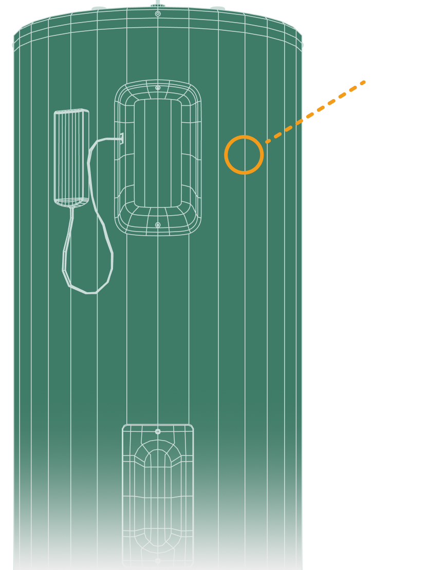

However, your description of the problem tells me that you have a hot water heater that is in its way out. How do I know this? Because I had the same thing happen to me 2 months ago. I'd get occasional pockets of air especially when running a shower (ie. hot water).
Wife is the GM of plumbing company. They came out and swapped the electric water heater. No issue since then. If your (electric) water heater is really 30 years old, it's a ticking time bomb.
have you purged the air from the water heater recently? see here for possible causes...
edit: just re-read your description and saw that you have a propane heated system. I thought that you had an existing electric water heater. I don't really know much about propane water heater systems. My suggestion was for electric water heaters creating hydrogen when they are on their way out.
