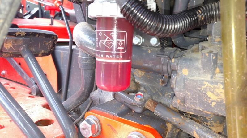

NIW, I think he does have water in there, judging from how different his bowl looks from mine. I have been looking at mine off and on wondering if I was going to be able to see the float move etc. I think the water interface is where the medium red line is. If I can ever get the picture posting back under control, will post picture. It is great to have OP's pic for reference.
Coach, only ultra low sulfur S15 is recommended for these tier IV's, don't know if any of the biodiesel's meet these requirements, but my dealer told me not to use it for whatever reason.
The supplier says it is Supposed to be the ultra low sulfur i am buying, thanks for the tips.

From what I'm seeing, is your seeing the red on the filter and thinking that that's a water line, are you using off road diesel? If not then the fuel will have the color as it does in the bottom of that separator/ filter.
But by all means open it up and dump it into a container and see for yourself, sometimes pictures can be an illusion.
Yes it is off-road

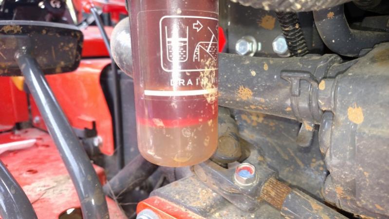

ahhhhhhh.... mucho better. Before couldn't tell if lower part was background light reflecting on part of the cup and not on top part... or if it was fuel/water separation. Tis very obvious now.
Do you store tractor under a roof, tarp?? Do you always get fuel from the same place? How long has it taken for water to build in separator?
No roof to put it under, no tarp. get off-road ultra low sulfur from the bulk plant. around 38 hours at the time of that picture.

Just cleaned out water separator at 39 hours, and followed instructions on page 62 - NOT a word about the spring that is inside? Bled the fuel system per page 86 and started right UP :D can't believe how much water and dirty film was inside there:confused: Picture before and after changing much better now.

Big difference in the before and after picture. Maybe you'll be lucky and this was a one time thing. I know you said you get your fuel from a bulk tank and like all of us we are at the mercy of our fuel supplier. A lot of the bulk tanks out there don't get the attention they really need to maintain clean water free fuel. I have both my tanks set at a slight angle with drains on the lower side so I can check for water and drain if needed. On top of that all my tanks have filters. No fuel goes in my equipment that doesn't get filter first. Since you mentioned getting 5 gallons of fuel I assume you fill with a jug and not your own bulk tank. Might be worth the money to get one of these to help insure you have clean fuel. Keep us posted on how it does now that you have it clean.
Oct 8, 2014
623
oregon
Ouch. I'm not trying to beat up on you but that much water is bad. I mean bad as in very costly when it starts running through your fuel pump and injectors.
