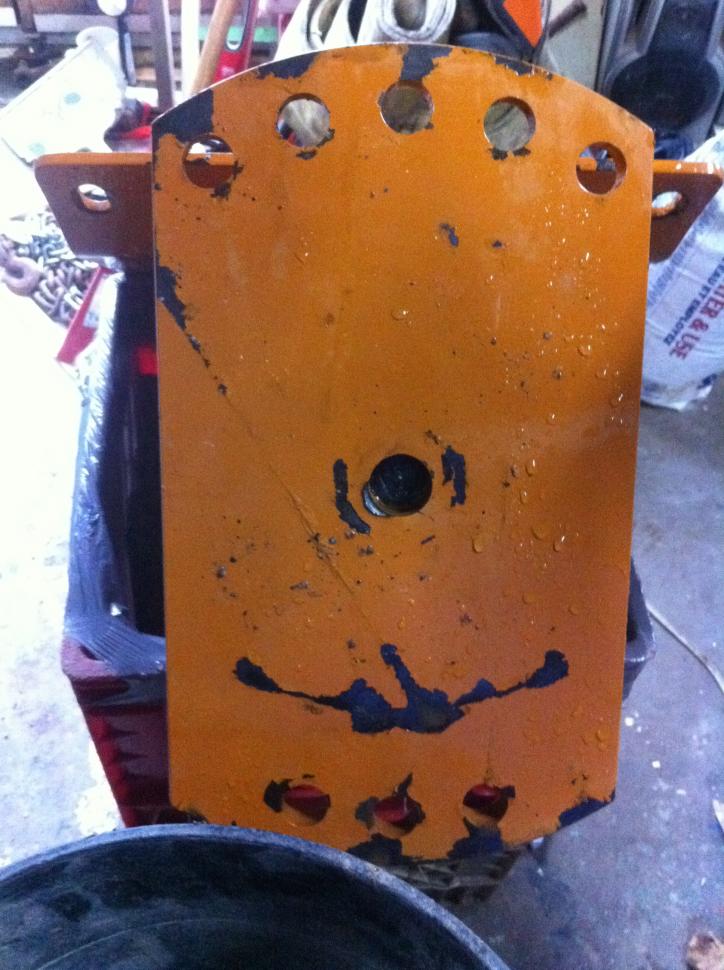

Just purchased a Woods RB 84, 10 days ago, worked great for moving snow, from the two recent storms. However, yesterday while doing a little clean -up, the main bolt, (1" / 7") broke off, leaving the blade dangling from the three-point hitch.
Not a problem, ah yes the design problem with 'Woods RB84' ! The nut is welded on to the blade carriage, now with a broken off piece of 1" bolt stuck in it. This broken piece has now, to be extracted, at a machine shop. I had the problem of breaking bolts with other rear blades, but you simply replace the the nut,bolt , lock washer, etc. , and keep going. A trip to a Machine Shop, for what should be simple maintenance is very disappointing.
My other option is to have the nut cut off, then I can use nut and bolt assembly? Regardless I'm looking at $100-200 fix, for poor design.

What's on the backside of this plate? the nut? is the bolt sticking out of the nut?
Either way, you can't get the bolt out? can't drill and easy-out? can't get Visegrips on the rest of the bolt and turn it out?
Get a good grade 8 bolt next time.
Get on with life....
And don't over pay for Woods.

If that bolt is an 1" diameter, you should be able to take a smaller diameter bolt and weld it to either end of the broken piece and turn it out. With an inch, there should be room.
Or, take a nut that will fit down in the opening, and weld the center to the broken end, then thread a bolt into the nut and tack weld that. Then back the broken piece out.

i've got an older blade only 72 inches. i repainted it so had to take that bolt out. the original bolt was "seized" to the welded on nut and took it to dealer when 10 minutes of 1 inch drive impact wrench finally loosened it. I bought new 1" by 7" bolt for $21 plus tax and re-assembled with anti-seize compound. Could you drill out the old broken off bolt?

Just an update, had someone weld on a nut , and then extract broken piece of bolt, got a used 'Cat' 1"/7" bolt from friend , and back up running. I did send an email to 'Wood's' , no response! Poor design and no response to customer concerns, I ll think twice about the purchase of any future Woods Equipment.

I too broke the bolt on my Woods blade (RB60) just the other day. It caught one too many cracks in the driveway. With the bolt seized, and 2" sticking out of the nut, I discovered the easy removal solution by accident. While tapping on the bolt (not real hard either) to jolt the threads a bit, I discovered that the nut is only tack welded in place. A few taps and the nut and broken bolt fell into the area under the pivot plate. So now I just need to put a new nut and bolt on and tighten it up. Tacking the nut in place should be very simple, if it evens needs to be tacked. Just an FYI. :)
