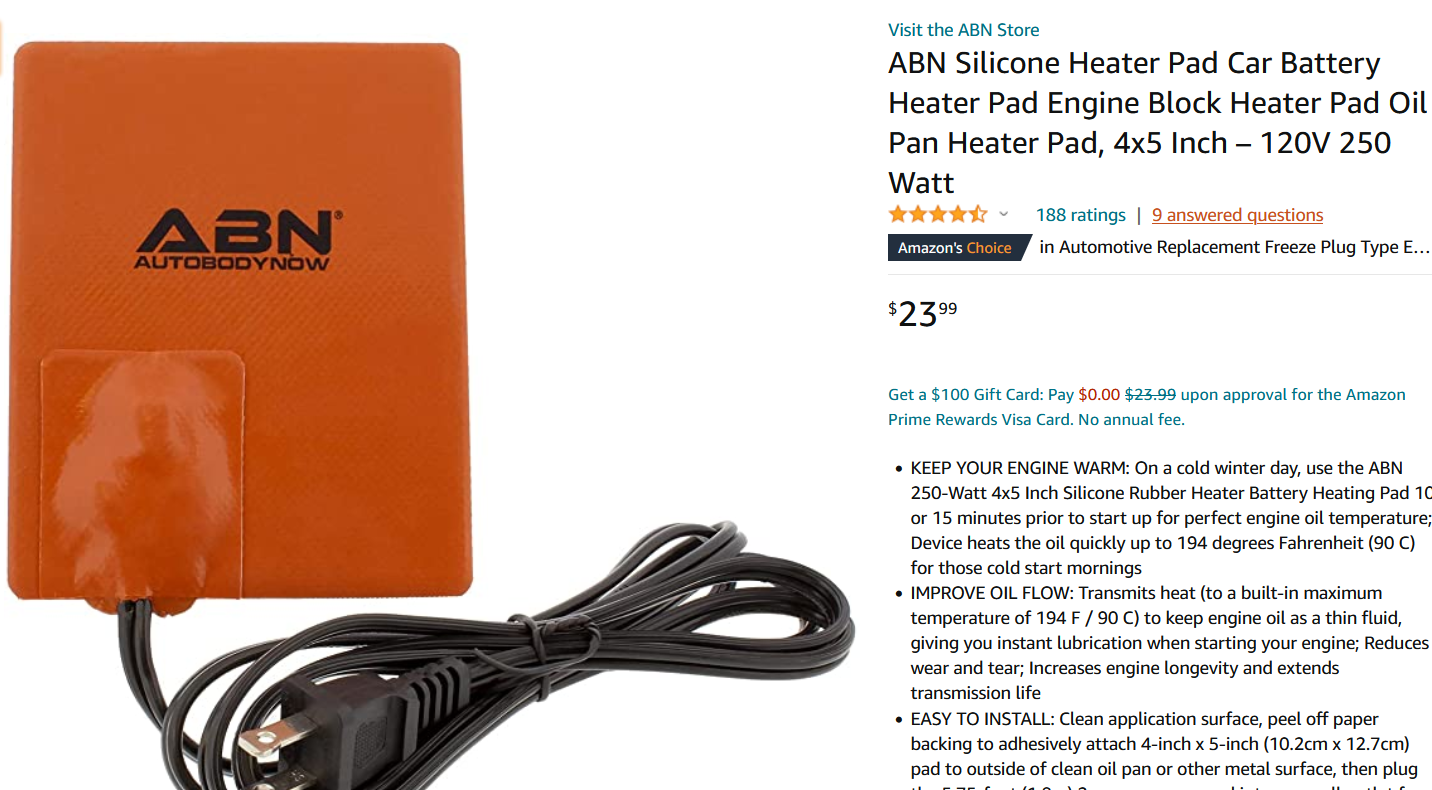

You could put a magnetic heater or a silicone heater under the transmission. Letting the PTO run while you are warming it up will also warm up the hydraulic/transmission fluid.
"device heats the oil quickly up to 194 degrees fahrenheit".
I say.....advertising BS !!!
"On a cold Winter day" a 250W rubber heating pad will not do a meaningful heating job, on oil in "10 or 15 minutes", that has been stuck on the pan of a cold soaked engine block.
A few hours, or overnight.......likely, but certainly not, "10 or 15 minutes".
Some of those pan heaters have been known to cook the oil. Pay attention to the wattage, but pay closer attention to the temperature. If they don't say what the max temperature is, pass.
I took an opportunity* to crawl under my Kubota and look for flat spots to adhere an aftermarket heater. While looking at all of that metal I was thinking that the (cast?) tranny housing is a lot thicker than a sheet-metal oil pan on a car. I'd end up putting a lot more heat into the casing (with lots of surface area for it to bleed out) than into the oil. Does anybody have any feedback on how well this actually works with a generic NAPA stick on/magnetic heater?
And don’t forget that most trannys and hyd systems utilize the transmission case to dissipate heat. Those glued-on silicone heating-pads behave as insulators in summertime.
