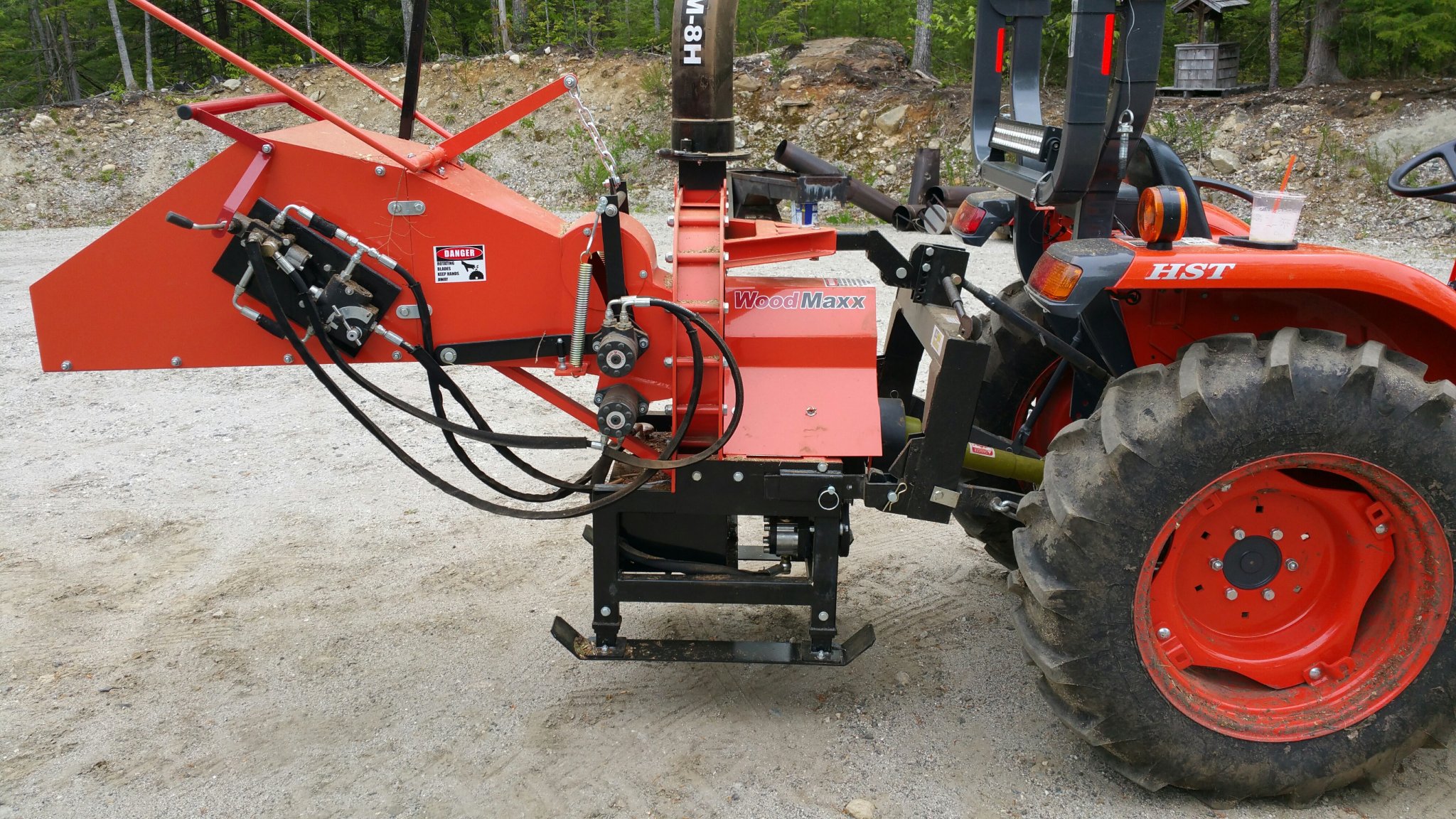

I have a WoHoo China made WoodMaxx chipper with hydrolic feed. And your tractor is alot bigger. I'm a poor bastard and couldn't afford to buy any brand so I bought WoodMaxx. I use it about 4 or 5 hours a year and it will certainly chew up the brush and trees. Another reason I bought it was its self contained. As my tractor doesn't have rear hydraulics
I just hook up the pto and it cranks.

I have a WoHoo China made WoodMaxx chipper with hydrolic feed. And your tractor is alot bigger. I'm a poor bastard and couldn't afford to buy any brand so I bought WoodMaxx. I use it about 4 or 5 hours a year and it will certainly chew up the brush and trees. Another reason I bought it was its self contained. As my tractor doesn't have rear hydraulics View attachment 67305 I just hook up the pto and it cranks.
Similar design to my Jinma but yours looks a lot better design wise i.e. round and rotating exit chute, double hydraulic infeed.
Lately I've been running mine 4-5 hours per day. I'd get more hours in if I could except I lose a lot of time doing field disassembly to clear the chute clogs, or driving back to the barn to re-weld handles, chute deflectors, etc. Last week I discovered my flywheel was stopping but my engine wasn't bogging down. I discovered that the main pulley was installed without a key or retaining set screw and the pulley was spinning on the shaft. Cheap F's saved $0.10 and now I'm going to have to buy a new flywheel drive shaft to fix the POS. Oh well, penny wise and pound foolish. Got what I paid for.
At least I don't get bored using it. I'm just waiting for the 200 lb flywheel to explode one day and I just hope I'm not walking beside it when it does.
BTW, do yourself a big favour and buy a PTO safety clutch if your unit doesn't come with one. Cheaper than splitting and repairing your tractor PTO.
