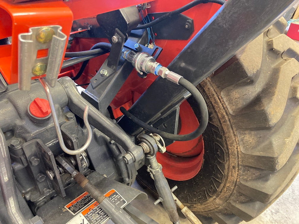

Thank you. So the owner of the company suggested an alternate installation under the seat. I suspect that connection supplies, the three-point hydraulics so if I went that route., same accessible port at the back for the splitter, but I’m thinking you can only use one or the other, the splitter or lifting the splitter to move to another location, which would entail disconnection of the hoses and doing the loop back.
am I seeing this right?
4 Power-Beyond tube that will be removed 2.JPG 6 Fittings connected to power-beyond circuit.jpg
