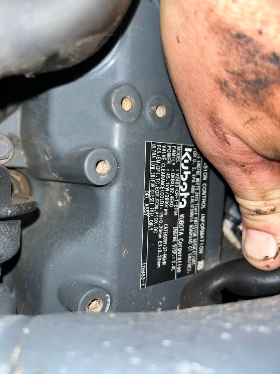

So, I'm new to all this Kubota world and I've learned it's a bit difficult to find information on their engines or so it seems to me. My L6060 ran hot (thanks to a friend) and after pulling the head, the engine is toast.
My thought is instead of rebuilding, I want to replace the engine as I have a company locally that put Kubota engines in generators and air compressors that sale the "COZMETIC" damaged NEW engines at descent prices with sales paper work for warranty purposes.
My model number is V2403-CR-T-EF04.

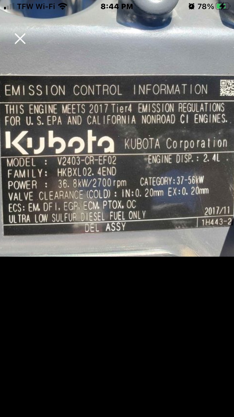

The one they use the I believe will work (with changing over all my turbo stuff) is, V2403-CR-EF02.
My question is, with only needing the engine and not the turbo etc. am I correct in saying if I transfer all my V2403-CR-T-EF04 engine’s extra's to the V2403-CR-EF02 engine I’m good?

It might and it might not, being an emissions engine I would be very leery of that swap.
If not everything matches up that computer may not like the engine.
There is V2403-CR-T-EF04 available for around $8K.

The 2018 is a M and not a CR so its different as I saw that one the other day.
The 2015 is a TI and mine is a T so again I wasn't sure if my ecu would run the engine as I don't have the intercooler. I would assume the engine itself would not care but..... I would also assume the none turbo basic engine would all be the same from a manufacturing ease of build for multiple apps.. but I have no idea. But if I knew the TI would be a drop in I'd do that. Plus that engine is only $4k more than the one i can get locally. I'm not against the $4k more engine but, $4k is $4k.
I just wish I could find the parts breakdown of the turbo-ed vs the none turbo-ed. if all internals are the same that would mean the basic engine (V2403) is the and I'm good.

I think if you were to change out the injectors and sensors for all of yours it shouldn't know the difference.
Let me dig into this a little more and see if I can give you a better answer as to the parts differences.
