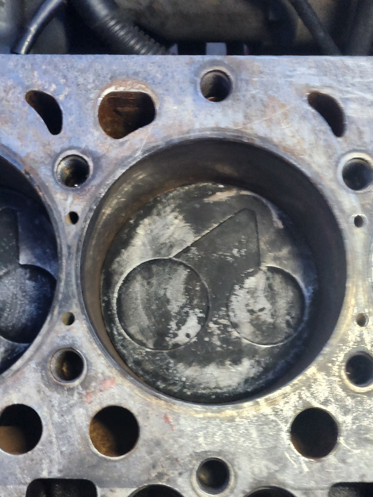

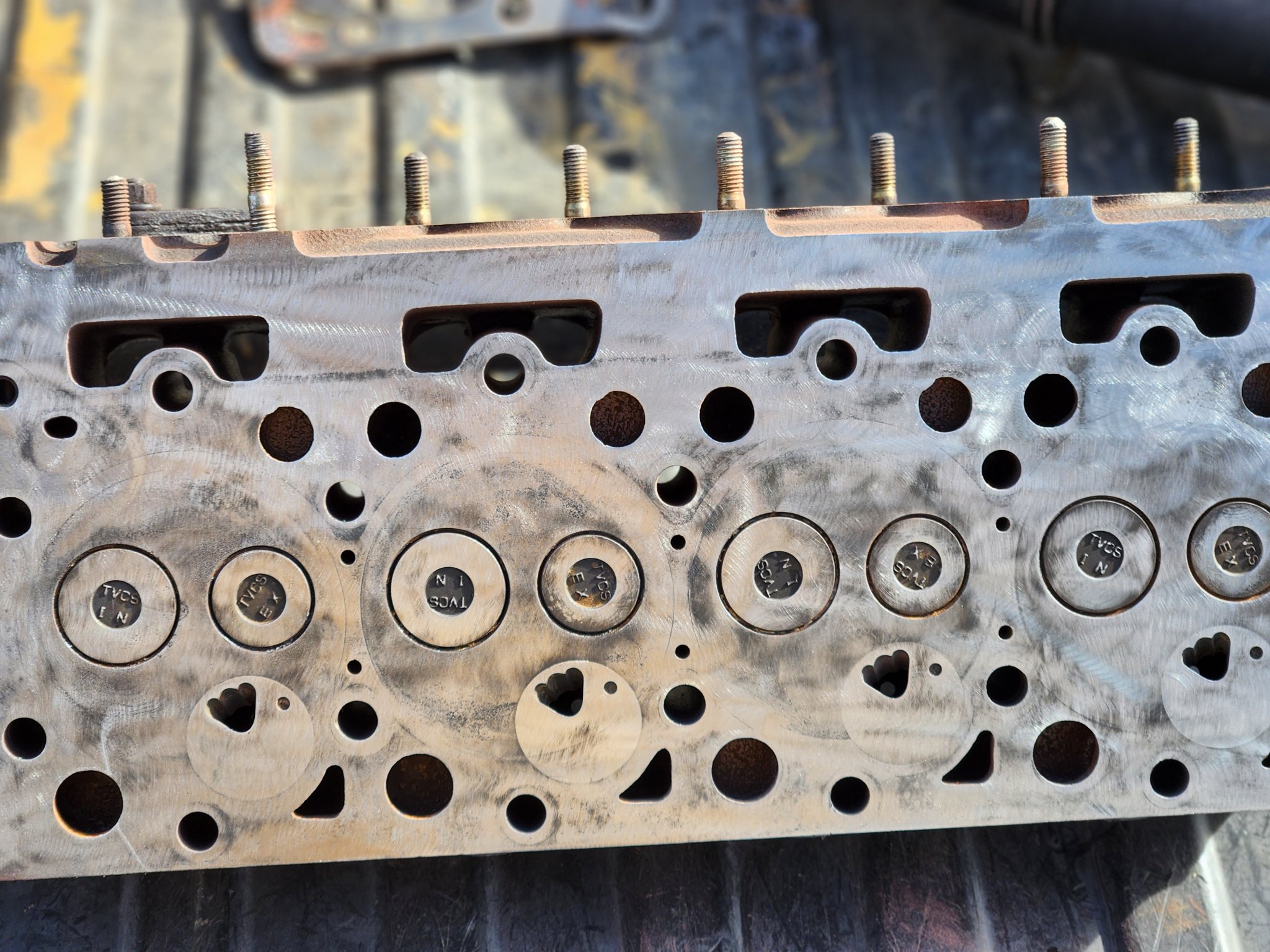

After pressure washing, guess I didnt dry it enough. It was dark, had to clean it. I see nothing. Head pics. Will get block too. Inspected head gasket coolant passages again see no reason...

BTW I used a plastic wheel on a die grinder. Clean but doesn't eat metal like 3M Rolocs do.

I really wish I could have seen it dirty, would have told me more.
I don't like the look of #4.
You're going to have to have that one magna fluxed to be sure.
Still want to see the top of the block and pistons, Uncleaned if possible.

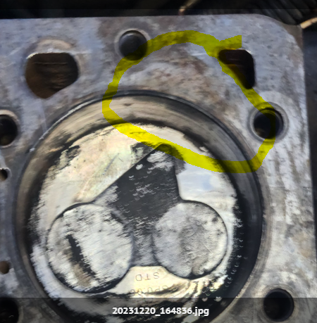

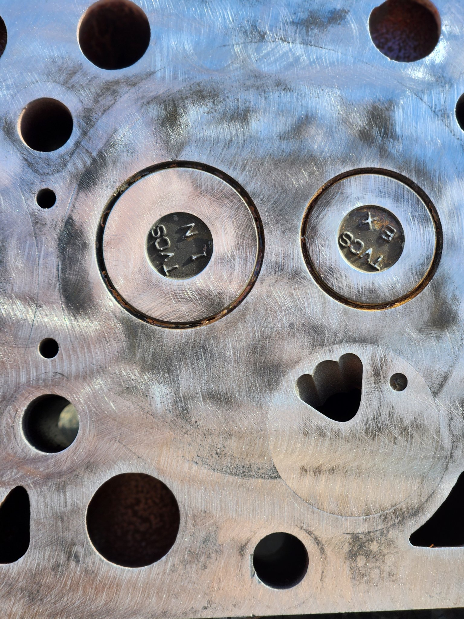

Had to scrape the remaining gasket off. Honestly never seen a head gasket like this. Lots of paper. Although I still don't see a cause. No possibility it froze, I mixed it recently with distilled. Pictires are 1, 2, 3, 4. Forgot an overall, it's tarped again. It's dark now.

Sorry they are too blurry to give you a really good answer.
But this is definitely a non seal point from the water jacket to #4
If the gasket came apart in shreds, it was junk to begin with!

Sure is! Just scraped it right before dark. Pulled the tarp back and lighted it. 100% its that. Ill straight edge it and measure extent. Worst case I'll pull the engine and strip it. likely full rebuild if I pull it. Danggit, sometimes molehills actually become mountains instead of making it that way. Even a cheap rebuild kit with liners isn't cheap. +machining. I am the labor, but we bid engine at least $1000 dollars per hole... 15 YEARS AGO!
