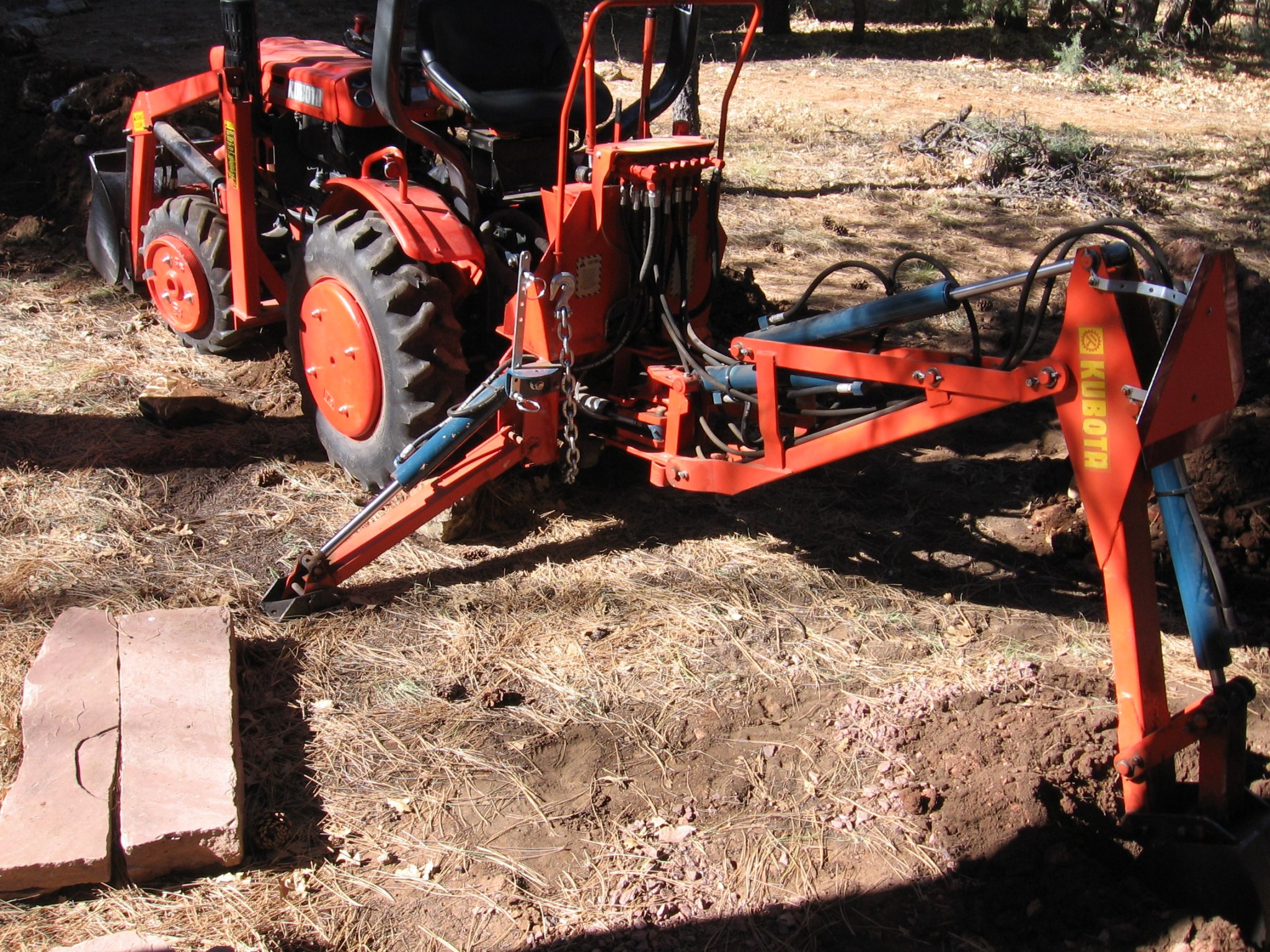

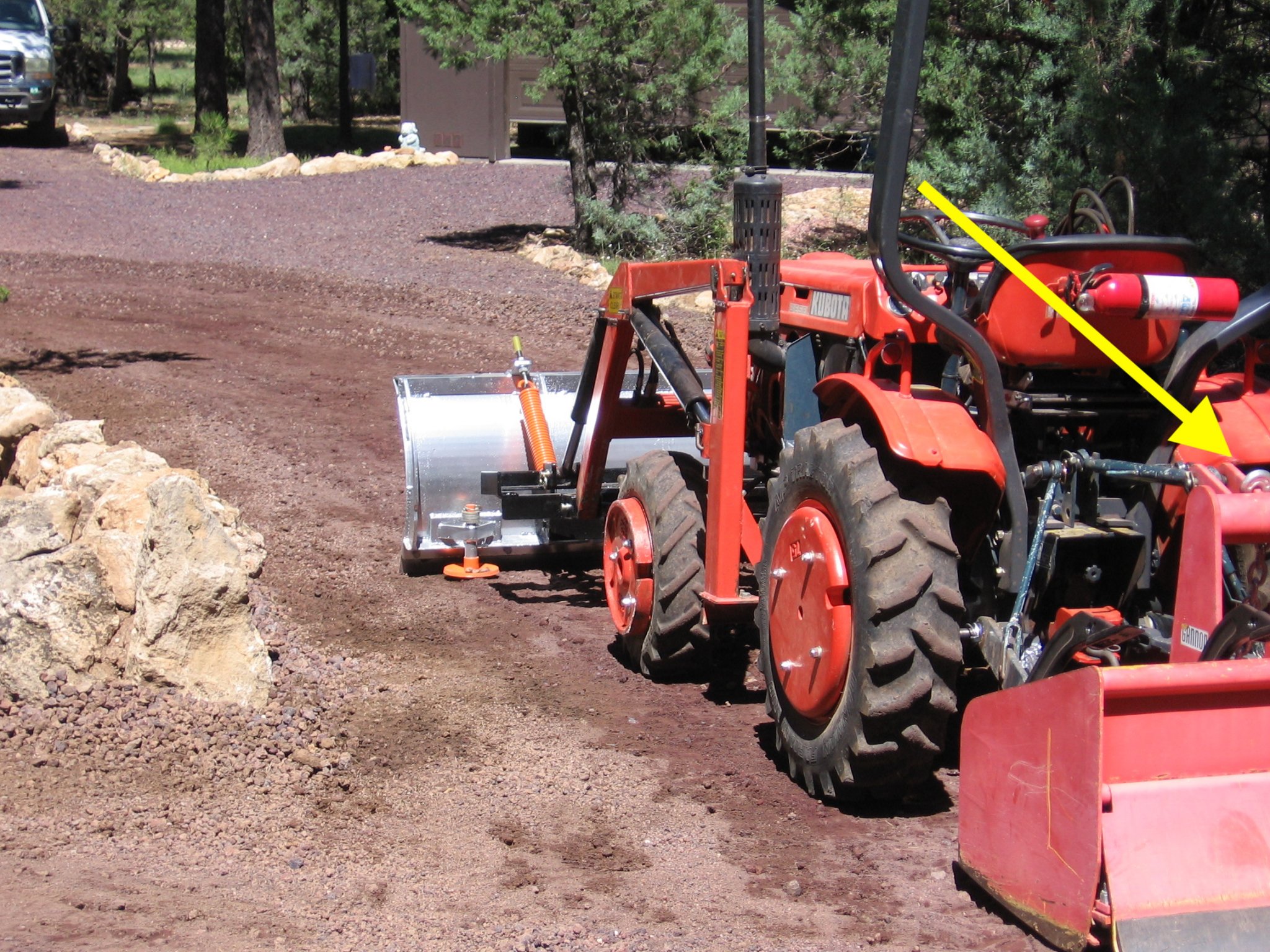

I leave a heavy chain with a grab hook permanently attached to the drawbar of the tractor all the time.
It stays hooked to the backhoe when not in use, and even stays on with the box blade in place.

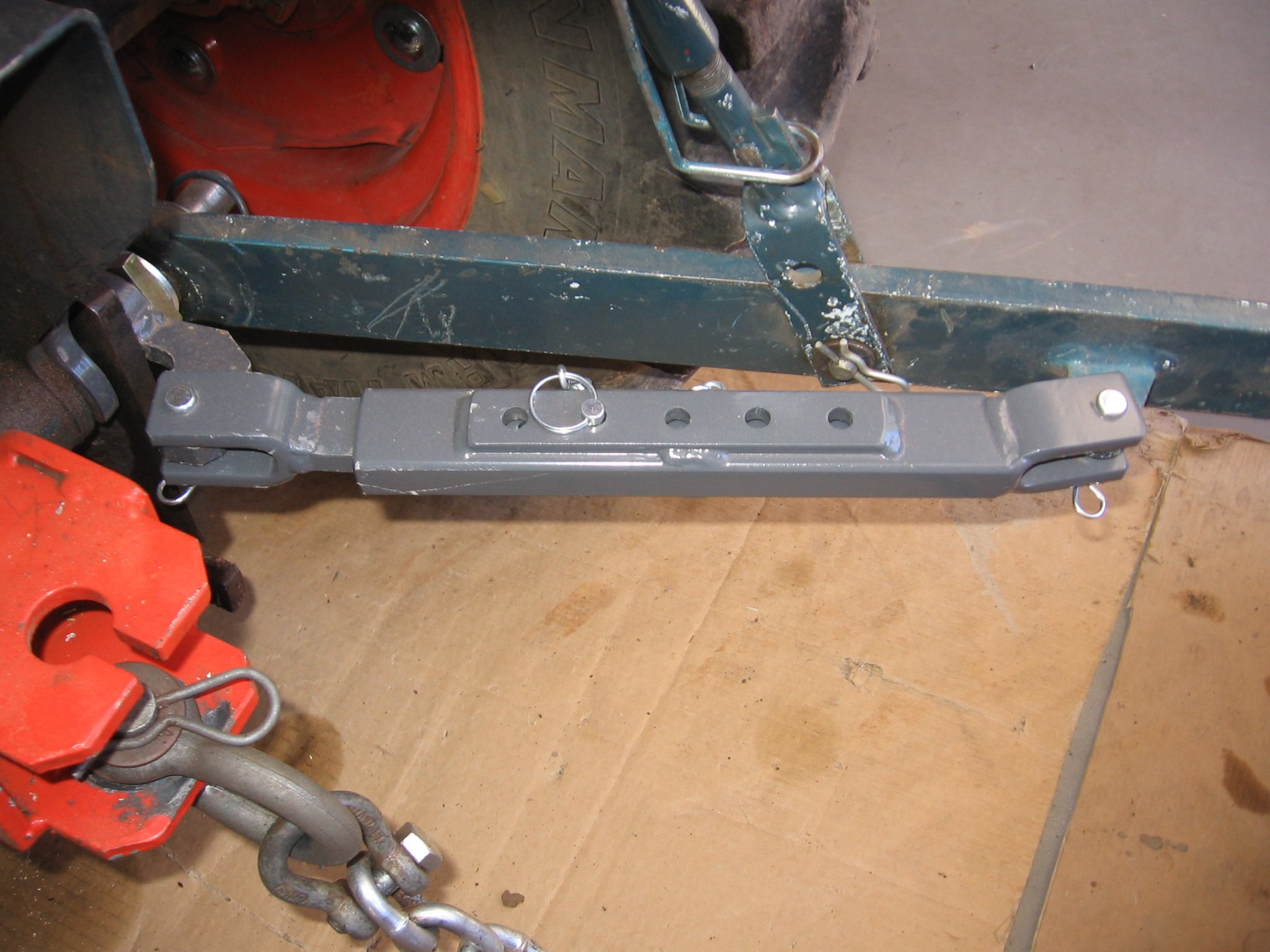

I would not tow anything from the front of any tractor. The rear is the recommended place (drawbar preferred) -- I also used this and they're easy to fabricate, but now rely more on wireless winches to move vehicles short distances -- the wireless on these winches (Smittybilt, Warn, etc) typically operate around 35'-50' so it gives you plenty of room to maneuver. Have also used pulley arrangements (as mechanical multipliers) to pull the really heavy stuff (e.g. stumps even my JD410E couldn't handle).
