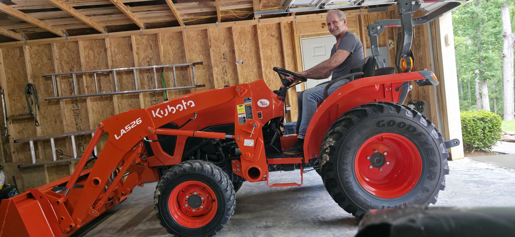

Well thanks to all you guys it's finally here. Love the new L3902HST functions and especially the upgraded power from my old L2501HST. Can't wait to use it. We got a week of rain here in South Carolina. So the best I can do, is visit it in the second garage. I guess I have to change my profile picture? Also notice the new R14 tires these are the 8600 group.

Nice upgrade, what made you get the smaller R14 tires?

Cool, thanks. I will only be using the front loader. And the PTO implements and attachments, rake tiller and will not be using anything that uses hydraulics in the rear.

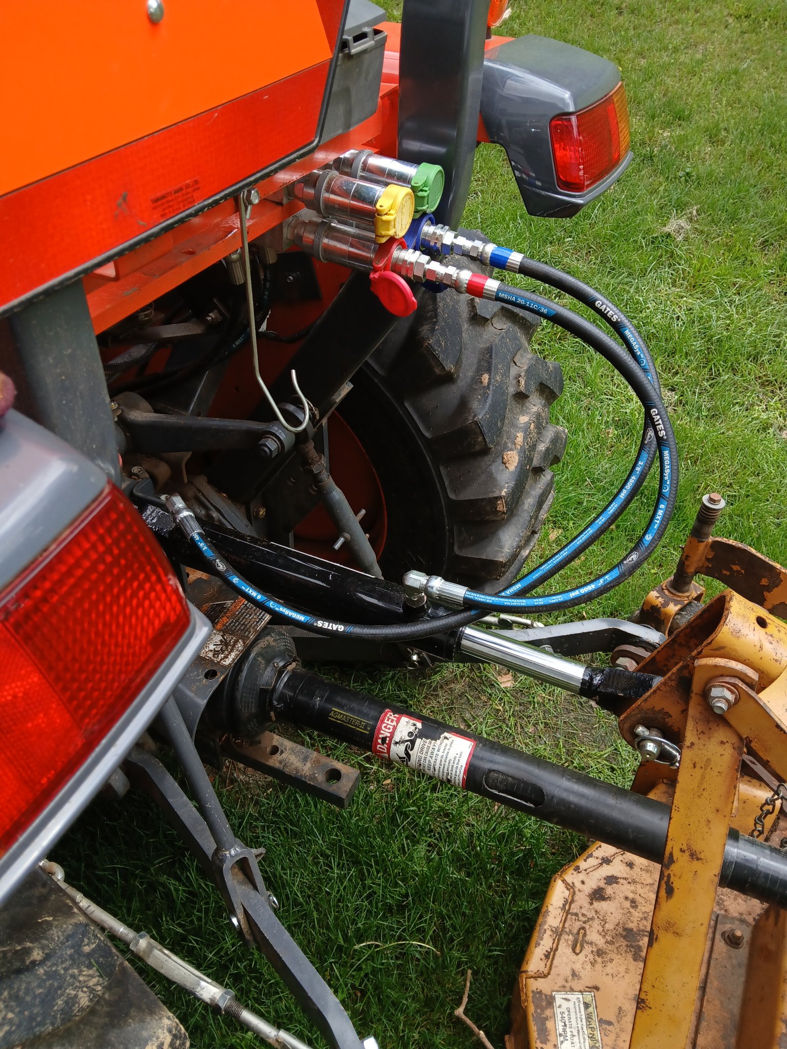

Wanna bet? I think you will find that a minimum you will want a hydraulic top link.
Plus many three point implements have hydraulic cylinders - hydraulic angle on a rske or blade for example.

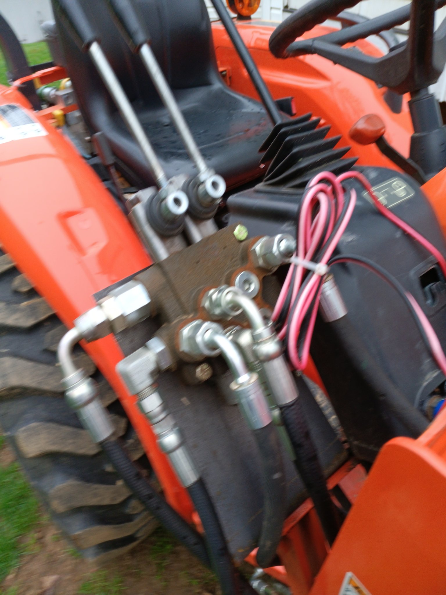

Now as to when, where, and how to add remotes or a third function. Factory option is easy and very "pretty" but quite pricey. Adding your own after purchase is easy and much less expensive but not as "pretty" as OEM.
Here is a picture of DIY dual remotes I added to my L3901 for less thsn 1/4 the price of factory remotes.
