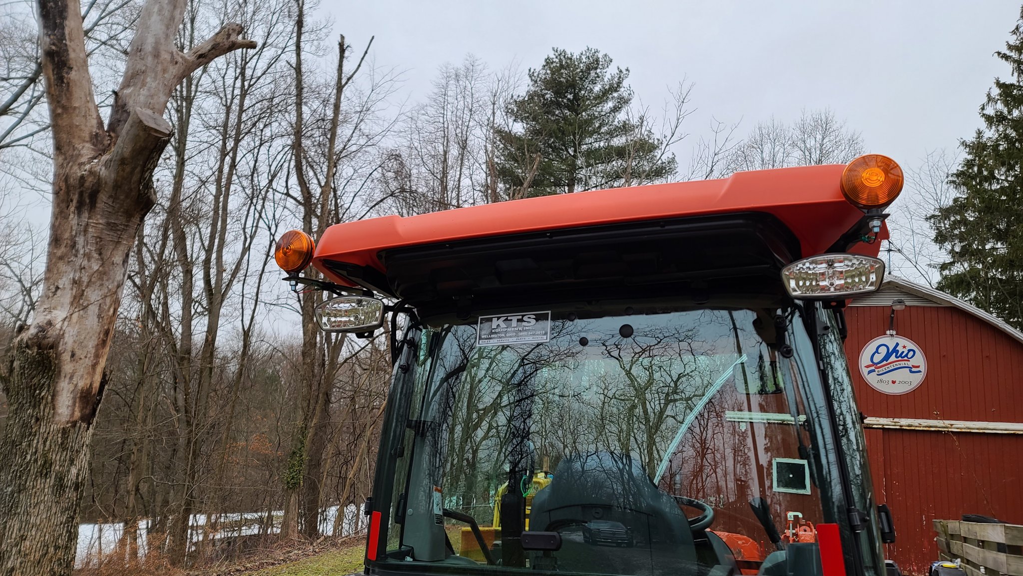

I got my rear light kit installed today. Switches go in the pillar. Note when you fish those plugs out the blue is for the rear, White is the Front. Waiting on Pigtail to finish the Led install on the front.
The Rear kit L8333 has everything including the rear switch. very good value at 146.00 bucks.

I plan to install some LED's I already have, so just need the brackets. I will know more when I finally get the tractor next week. I have a set that will go by the front amber lights by the loader frame, and once I get the brackets, I can check to see if the ones I have on my B2410 will fit and order a couple more pairs of those. They are extremely bright and well focused. I made a light bar to mount them on that have a pair pointing forward and one backwards, and lights up the entire back so I can hitch at night if needed.
If you look up the individual parts, the lamp alone for 1 is $107 from Messicks, but the kit from elsewhere is $146. I may get the kit just to have everything and go from there.

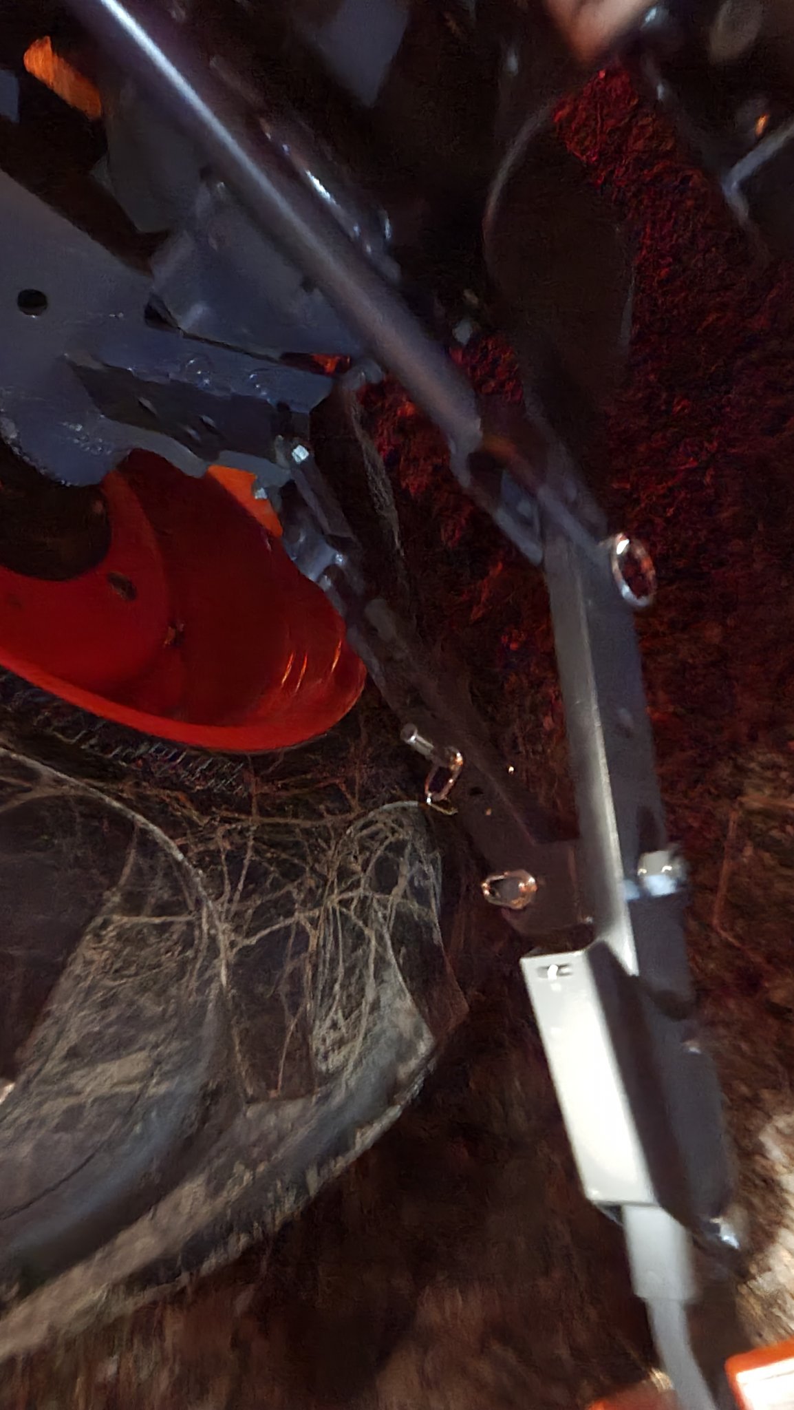

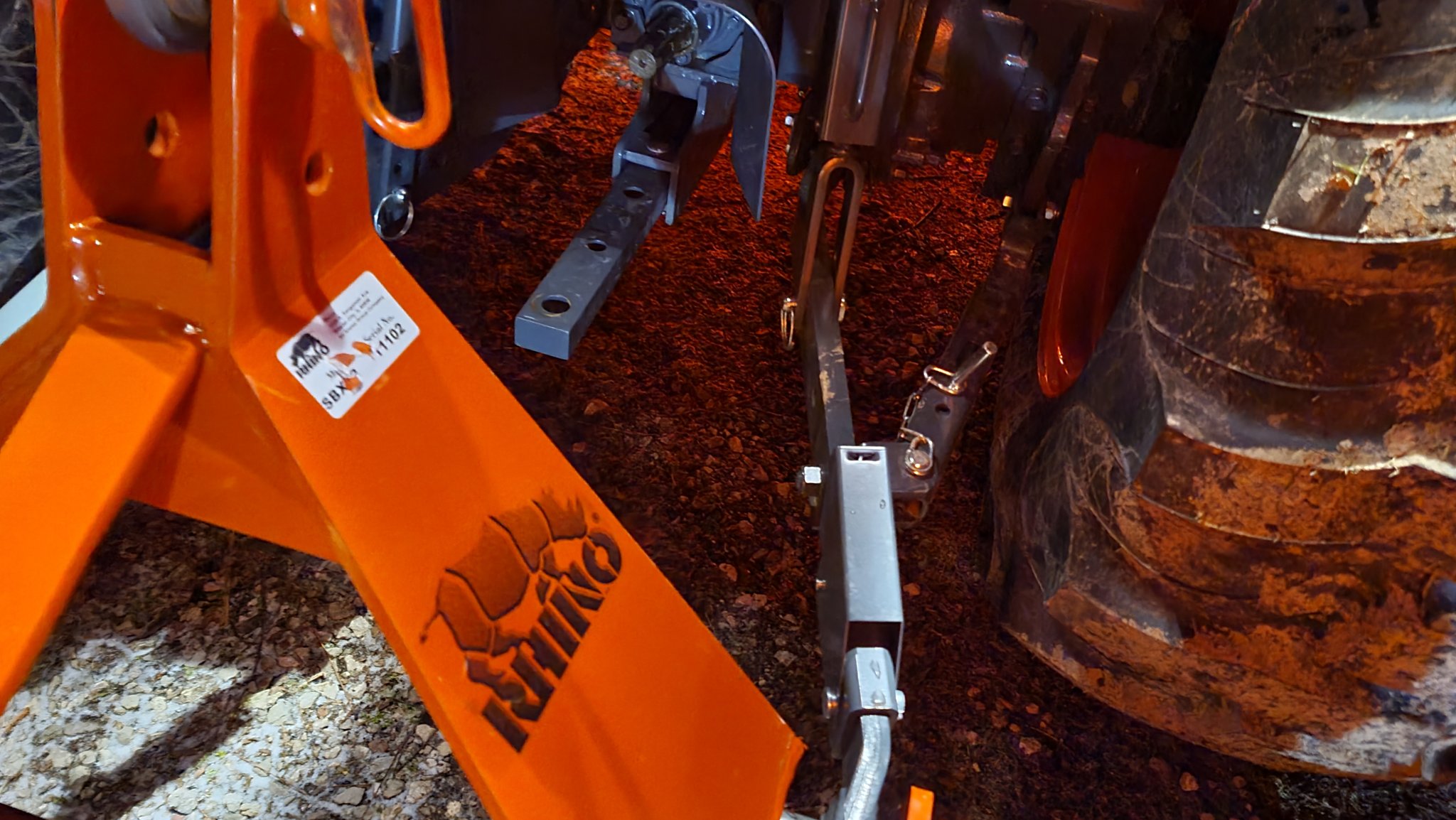

I haven't seen mine yet, but does yours have the telescopic lower link ends? A comparison chart shows they do, but have not been able to confirm. I think the stabilizers are turnbuckles on the LE, but not sure on that either.

Yes, mine are the telescoping i was suprised and i bought that rear kit for 146 from Messicks. Same exact lights as standard frints for 107 bucks each. Kinda strange plus the switch which is the same as well except it has a R on it.

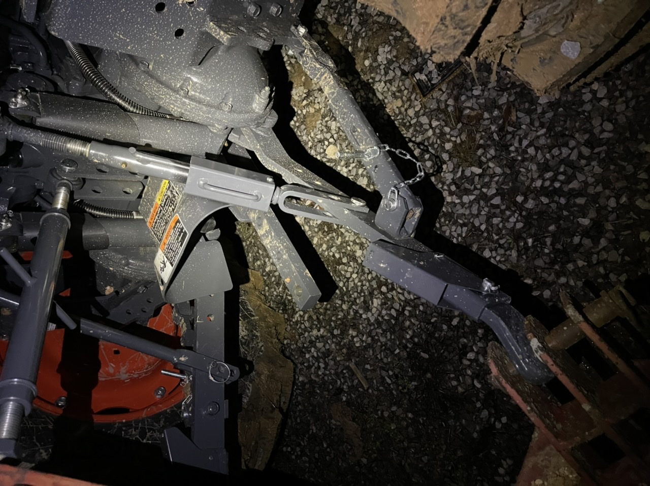

Here you go. Mines a limited too.

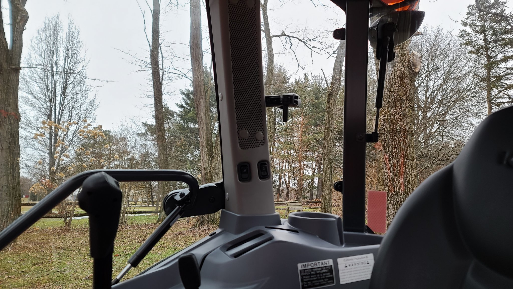

I have the right side grab handle for my l3800. I find it useful when going down some of our steep hills and I hold onto it and the steering wheel. To many items on the right side to enter the open platform from the right.

Don’t know why everyone saying it’s so hard to use the right side. With the control lever next to the seat I find plenty of room. Can’t wait to add the grab handle and step to that side. Even without them it’s not that bad and I’m crippled lol.
Kubota: HANDLE, Part # T4365-71110
That is the correct part number if you want that handle. I agree, with the step and this handle I can get in easily. Really aided in removing outer roof to get the wiring harness out for the front lights. Only thing I had to watch was the hydro pedal on the floor.
Took me a minute to figure this out, got a huge handle first go around. Price is 45.82 Messicks. If you paste that and search you will see our models listed.
