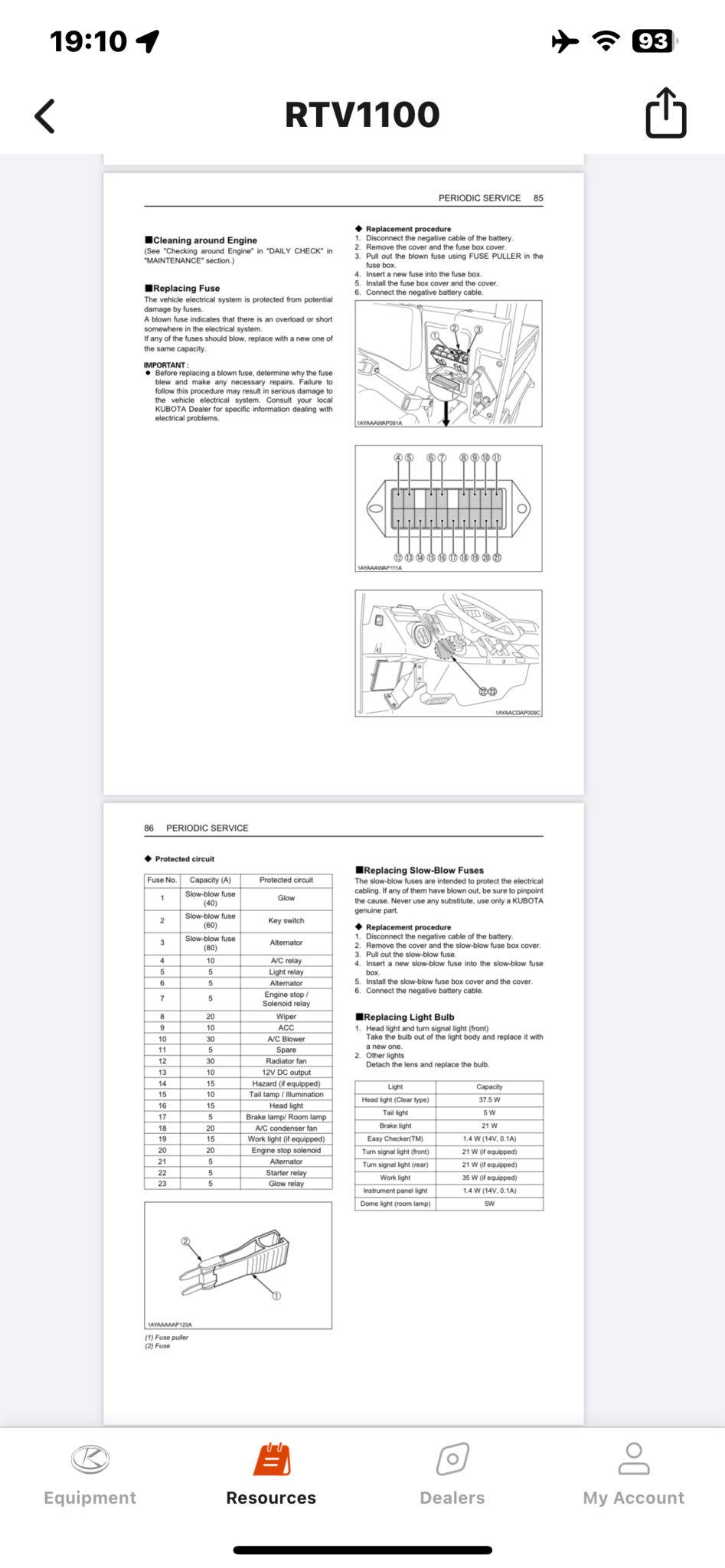

2. I also own and older RTV 1100c (not an X1100). There is no voltage to the tail lights. I have checked all of the fuses that are in the block, but there are two open slots. Does anyone have a fuse block placement diagram?

re: 2 follow the wires ! maybe some 'bullet connector ' has come apart, perhaps no ground at lights ?
