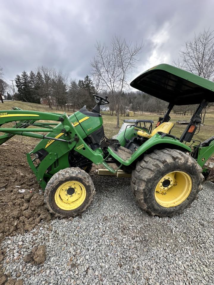

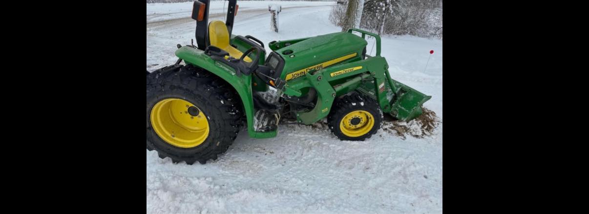

From another site- both tractors had the hydraulics turned up. I know no other details, so it's no use asking. I'm just posting them to contemplate the end results.

dear oh deere....... green machines have 'split' personallties !!!
if you need more lifting power, buy 2 sizes up tractor OR move somewhere your current machine performs just fine.....
