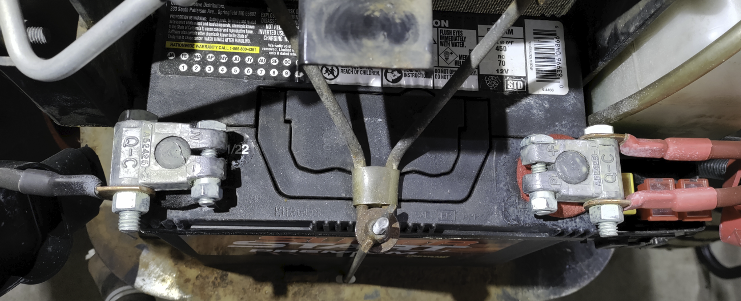

I can't see if that's the negative or positive but if it's the positive then vice grips are going to be a bit risky.
I would cross drill it right through the battery post and put a nut and bolt through it.

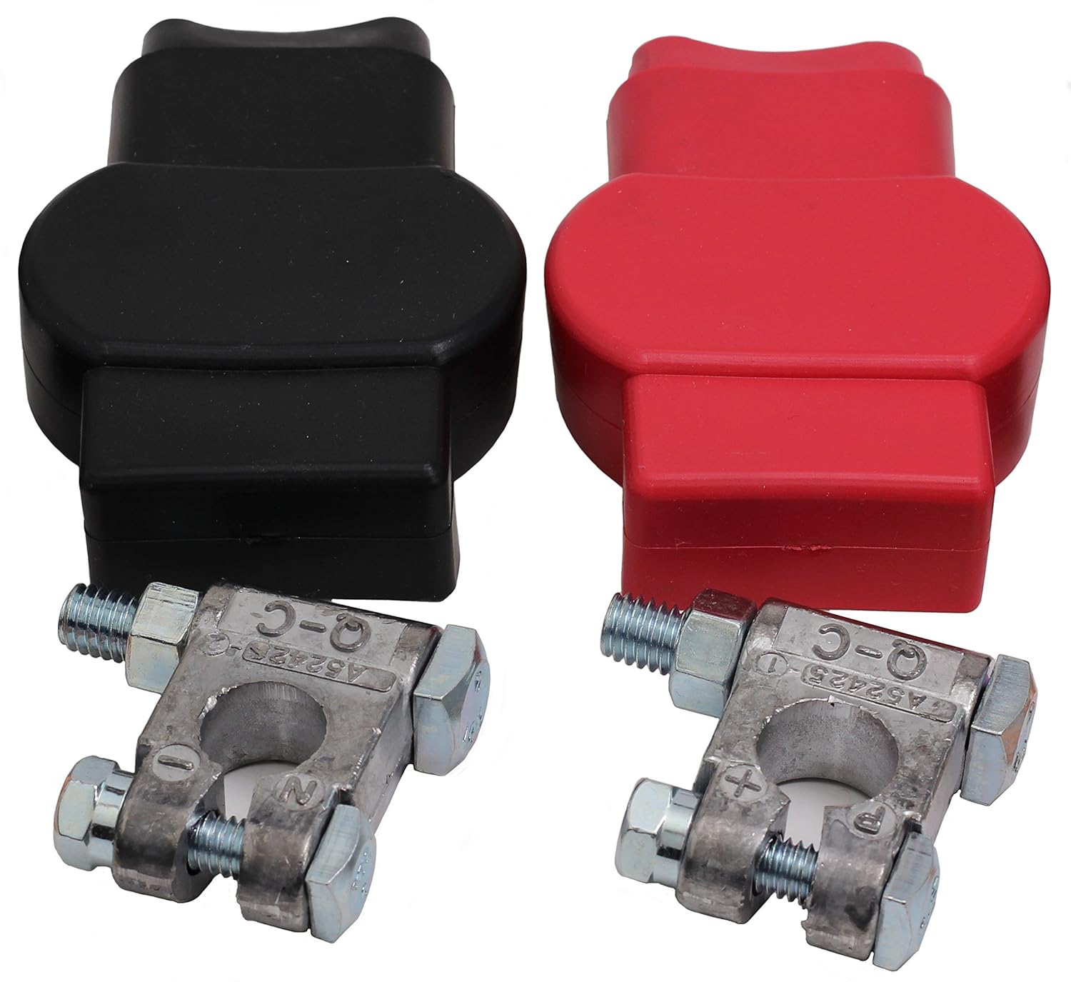

I use an anti-corrosion paste such as Penertox, NoAlox, CU/AL Aid or the likes when making connections on batteries, grounds, crimps on vehicles. The surfaces are always cleaned first. I coat the cables before stuffing them into the crimp lugs or splices. When bolting ground lugs to steel, I clean the metal to bare and coat it well.
It may be useful to some that the side terminal batteries are tapped 3/8-16. With my own DIY studs, nuts and washers it allowed adding the thick 2/0 lugs for my winch/jumper connections.
