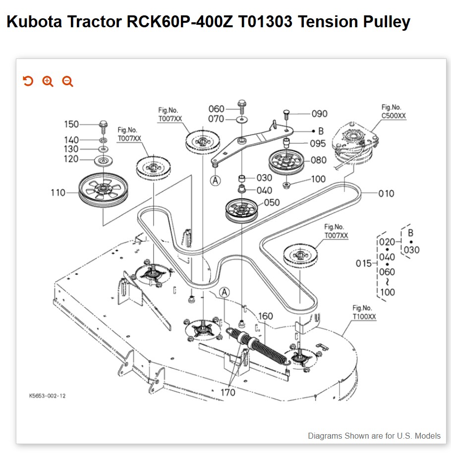

So because of work I still haven't got time to take the deck off and inspect the damage...with any luck it will just be the belt. I added up all the possible parts that could possibly need replacing (the nuts for the spring and tension bar etc) just those few parts were like 40$ So I will just order a belt from Messicks as i know it is broken. So glad I had somewhere to go for advice....
Has anyone ever tried to access that belt by removing the gas tank? probably not a good idea....
So now i just need to locate a diagram for the mower deck as i want to see the belt diagram. I cant find it on that kubota site... sorry to ask so many questions I appreciate the help
