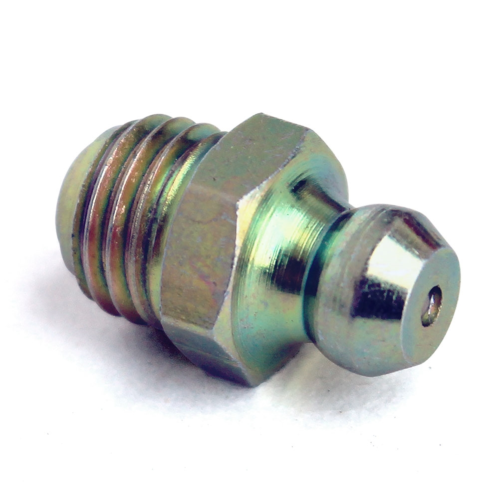

I'm assuming your zerk looks something like this. If so, you should be able to screw it back into where it came out.

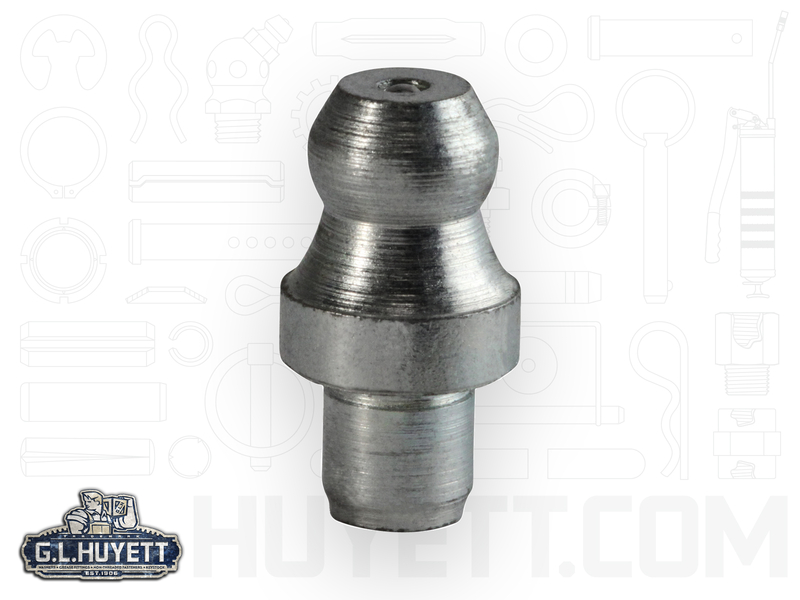

If it looks like this one, then it is a press in
