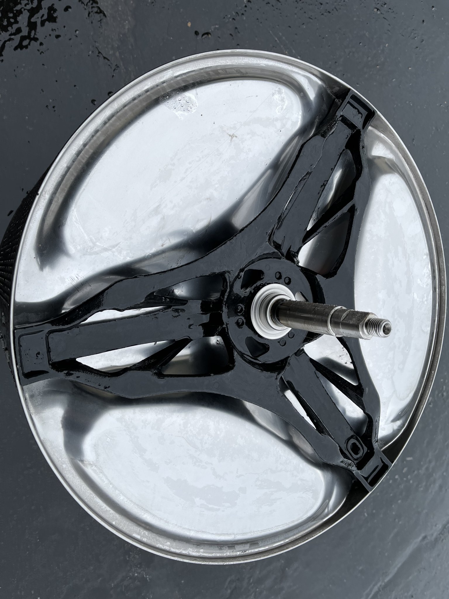

Many of you know what this is and where it lives. Replaced it 8 years ago. Slag blasted and coated the new part with Chassis Saver. Pulled it apart (again) last week to replace the bearings. Very pleased with the way it held up.
