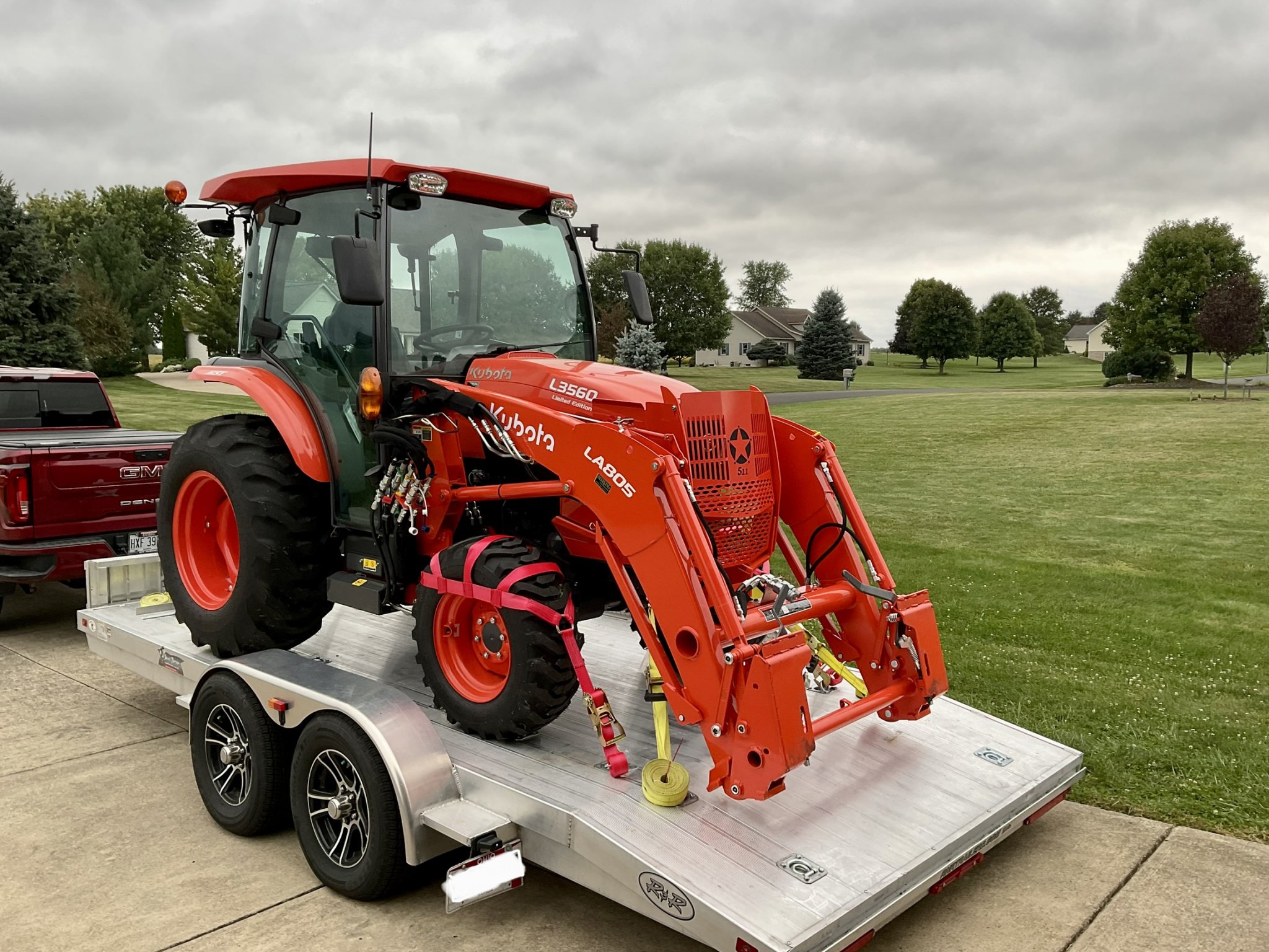

Trailering my L3560 LE 800 miles…my set up. ** New photos**

Here is what I get….tractor w/4wd and HST = 3,880 pounds, 805 loader = 1279 pounds
total = 5,159 pounds…yup….might have to rethink this. I have a friend that has a dump trailer with 10,000 pound capacity….
Lots of debate over the years about what these tractors actually weigh vs what is published. Usually they ended up being a little heavier. I'd suggest you run your setup across the nearest truck scale to get an actual number. You have a really nice towing setup but it may not be quite enough for your tractor.

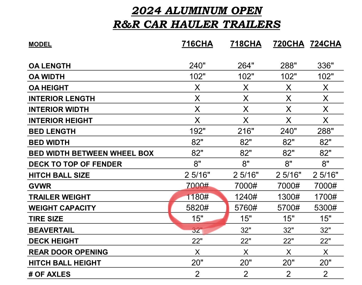

Ok…my memory just isn’t what it used to be for sure! Here is the spec sheet from the manufacturer…5820 pounds weight capacity. Subtract 5159 pounds for tractor and loader, there is still 600 pounds to go. So there is excess capacity for the trailer. I had originally put the tractor on facing forward, but didn’t like it. So tomorrow I will turn it around and see how it looks….stay tuned.

Guessing around 4,000 as it rolls down the road. A pair of 5,000 WLL straps up front and a chain through the draw bar. Of course, the loader and BB are also strapped down too.

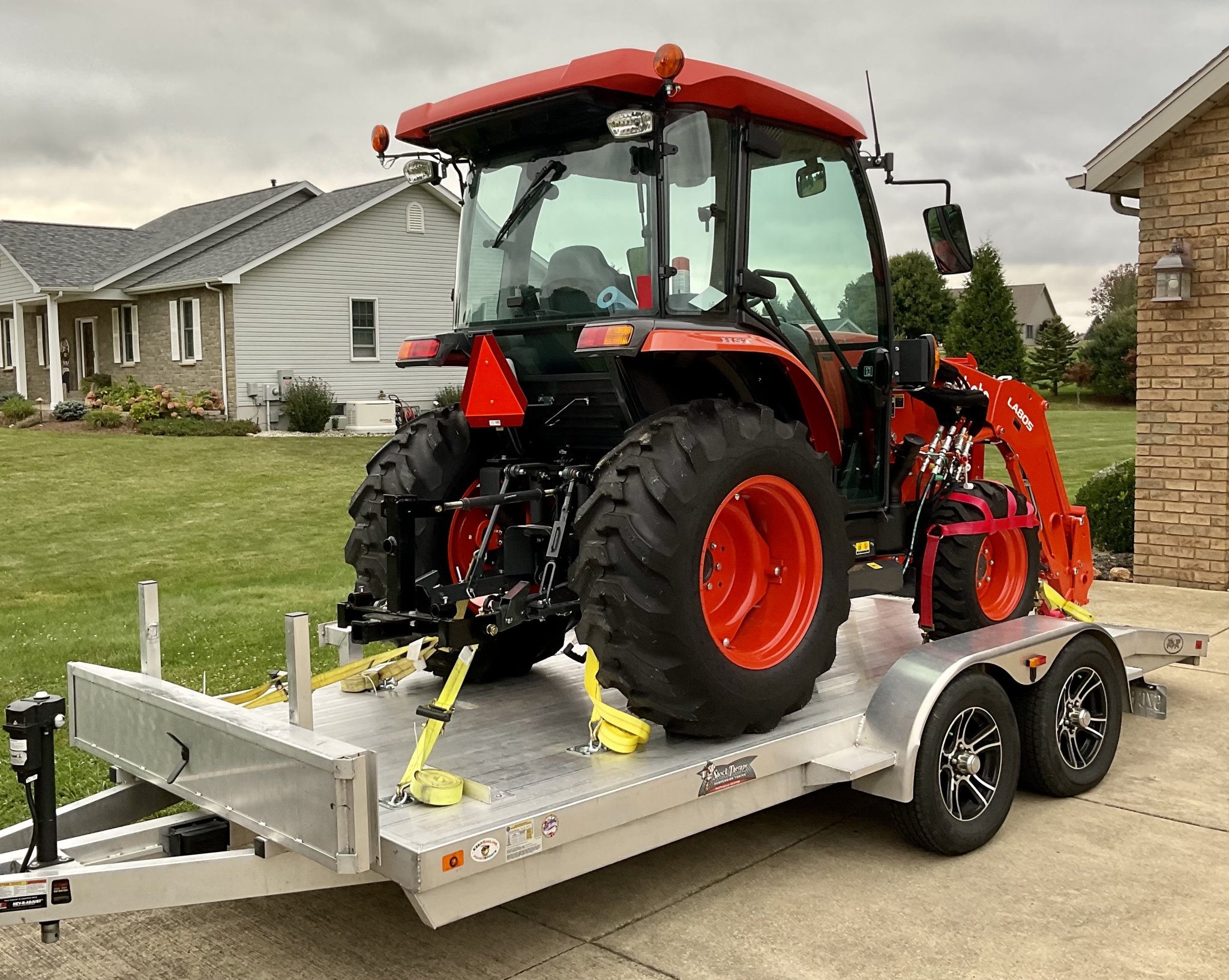

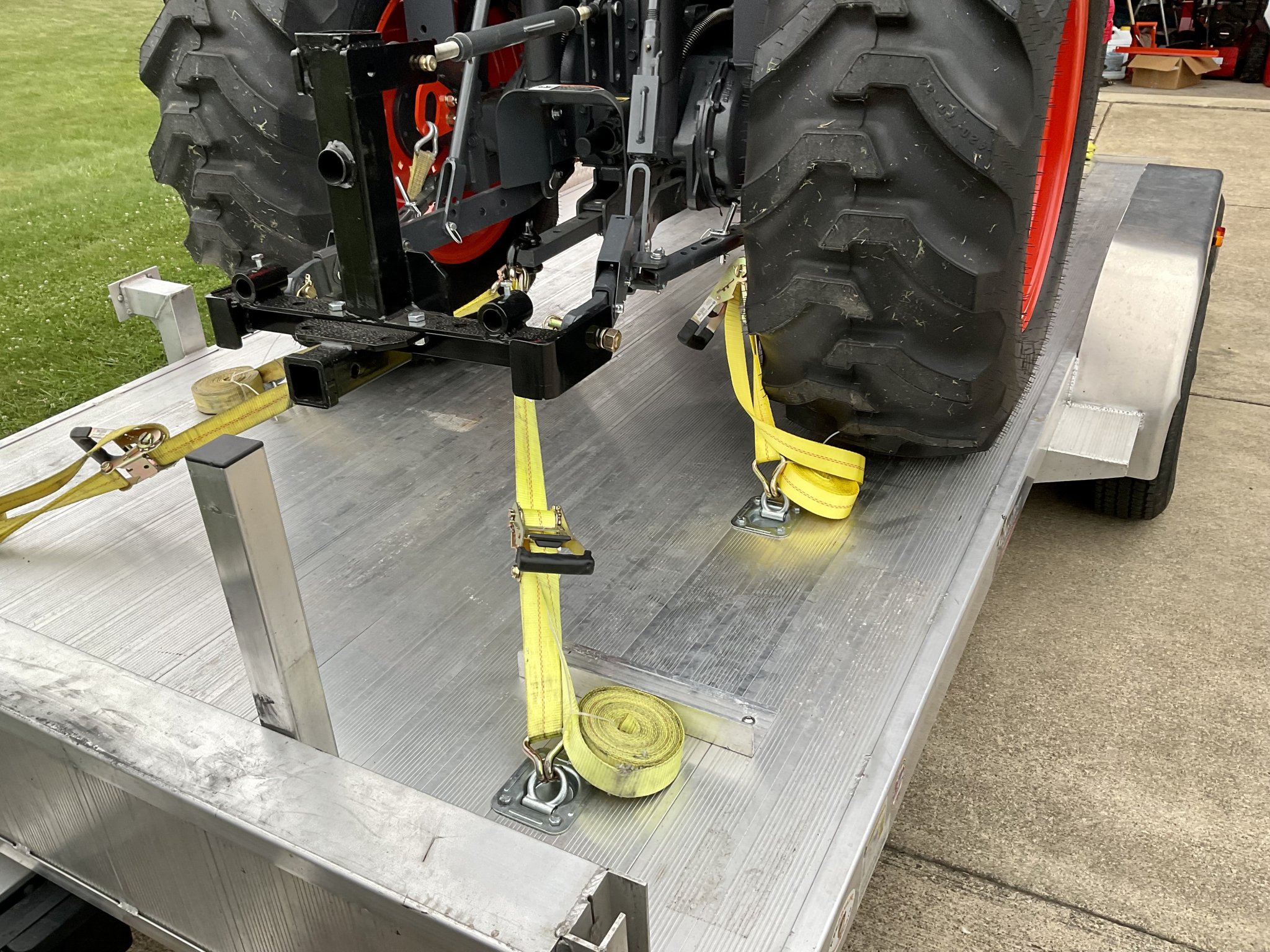

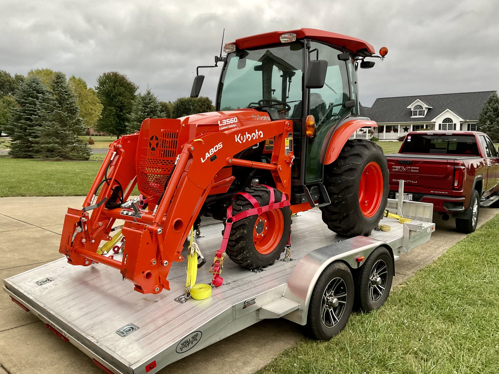

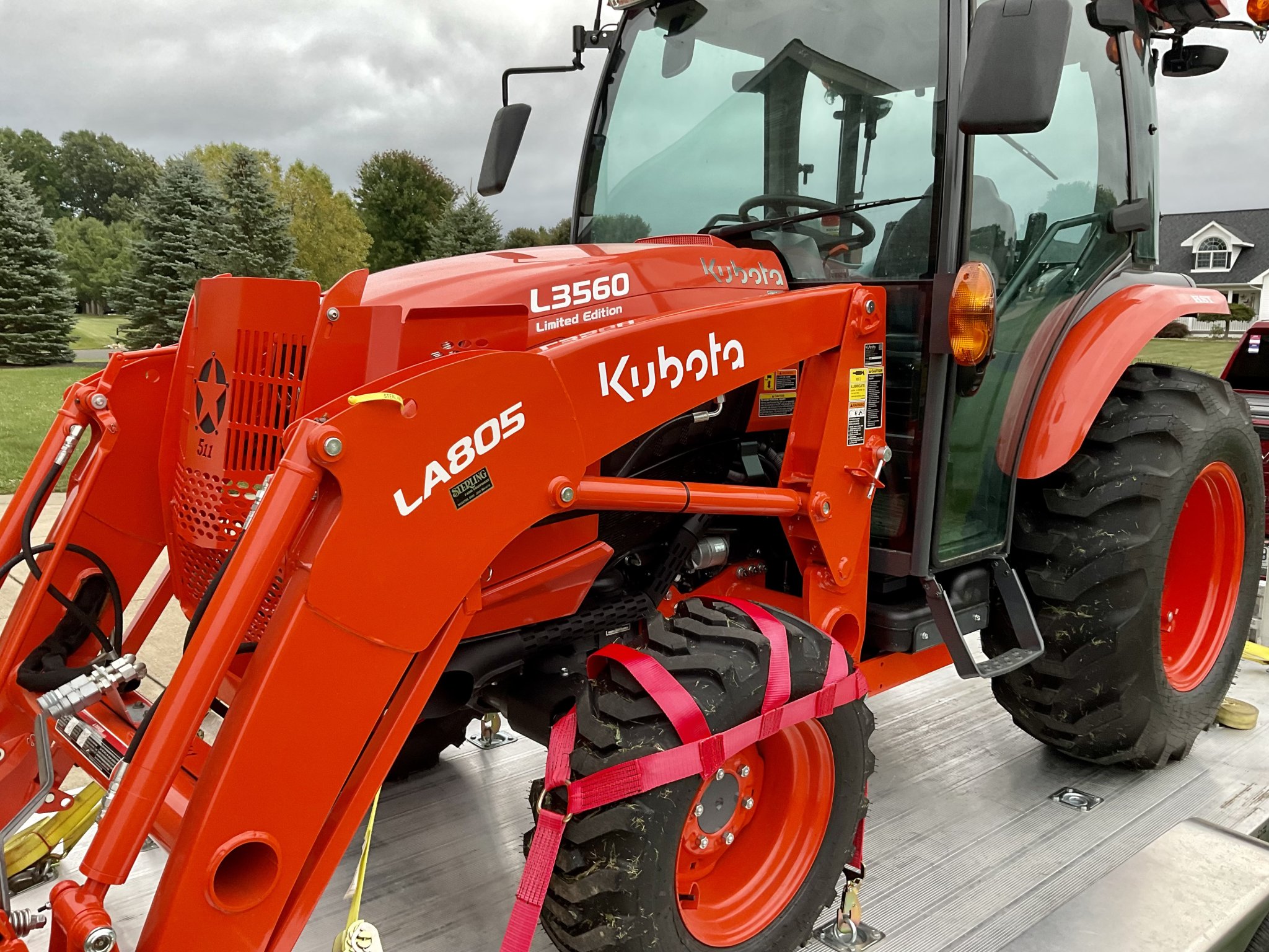

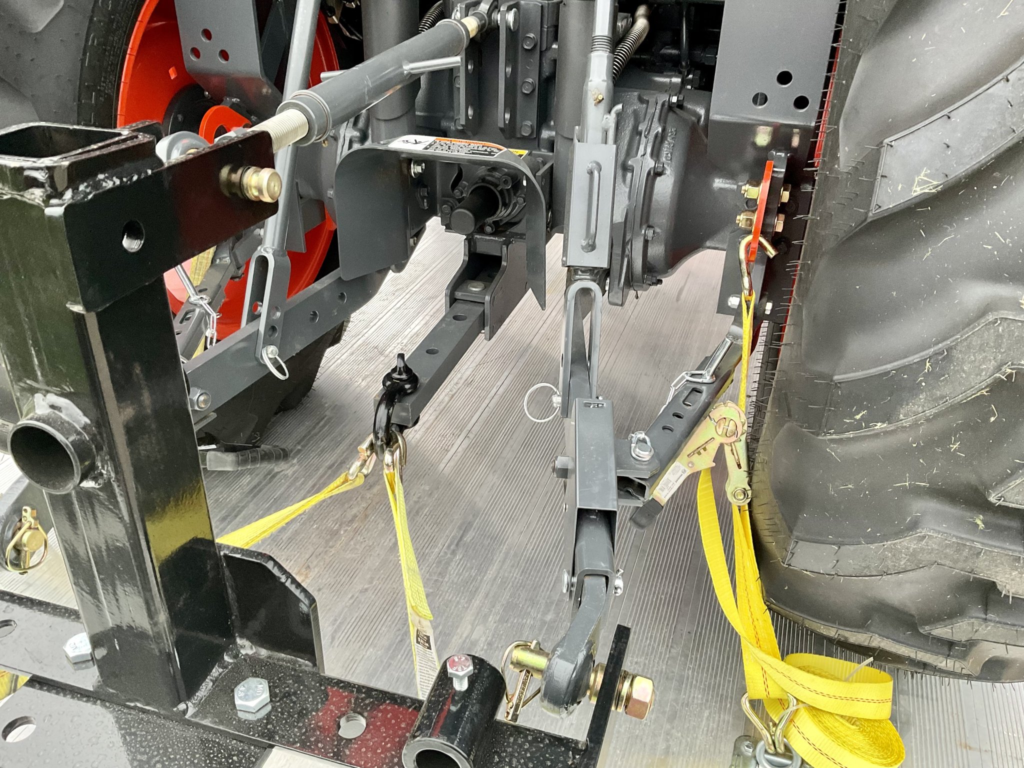

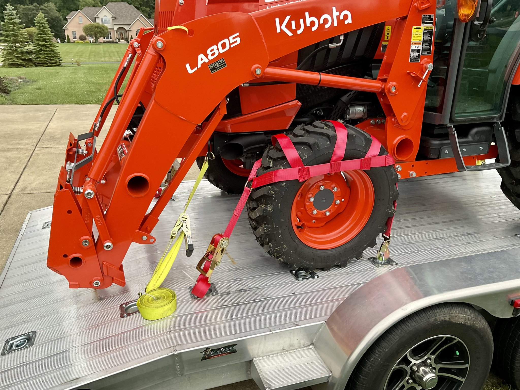

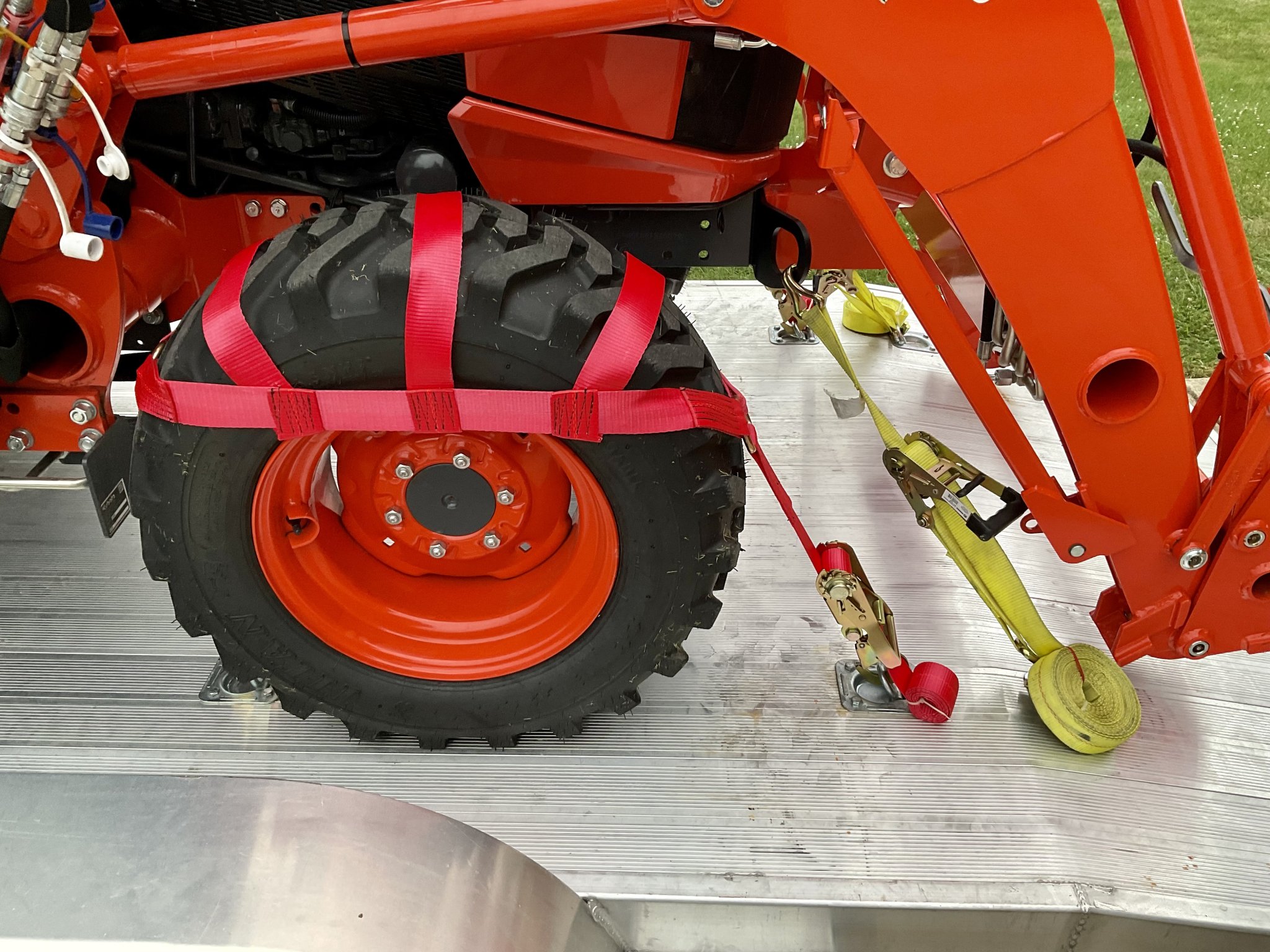

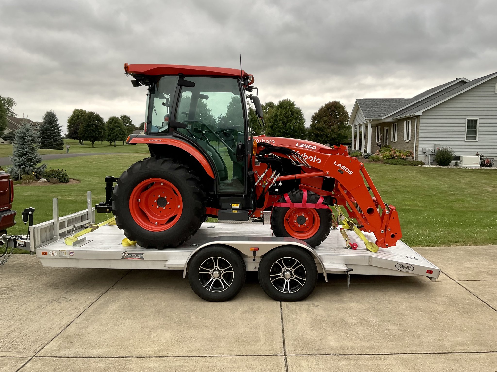

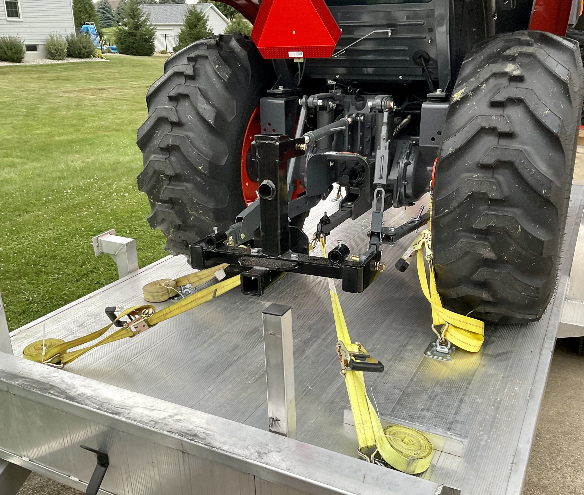

The photos below show my set up. Each set of straps has a 3,000 pound working load limit with a 9,000 safety limit. The trailer has a total load limit of 6,000 pounds. The trailer itself weighs 1,000 pounds leaving a load limit on top of the trailer of 5,000 pounds. The tractor and loader weigh about 4,500 pounds leaving a gap of 500 pounds. Took it out for a trial run and to get the straps to settle in and tighten additionally where necessary. Comments?
View attachment 112472 View attachment 112473
I suspect that you either have too much tractor, for that trailer (at highway speeds), or simply not enough trailer for that tractor.
50-60..... maybe OK?
60-70......NOT!
Magnificent looking rig though!

rule of thumb I've always followed is tongue weight should be 10-12% of total trailer and load weight. I would concur with turning the tractor around to minimize wind or the turbulence from passing trucks forcing the cab doors open

My comments are based only in my own fails. I hope these help:
I was a fan of straps until one frayed and snapped….went to chains after that. Straps are fine until a load shifts and they frayed and break.
Are you aware of your tire age load and speed ratings? Have a spare? Check it as well.
it’s hard to tell from pics, but from the side shot it looks like sloped slightly to the rear…maybe check that.

Make sure your tires air aired up properly.
Under inflated tires will overheat and blow out quickly.
I'd tuck in my mirrors too. Otherwise, they will act like mini parachutes while you're going down the road.

I don't agree or understand the comments about the doors blowing open. Did you guys and gals know that they are suicide doors?
The Hinge is in the back of the cab, the latch and handle in front.
Backing onto the trailer should prevent the doors blowing open as mentioned. Unless I'm missing something. Educate me please.

Think about the doors facing backwards. Is there any way to prevent them from getting too much air forced on them that could pop the door open? Maybe use some cardboard to cushion the windows and then wrap the cab in the shipping wrap that is used on pallets to keep the load from falling apart.
The doors are backwards. "Suicide doors". The reverse of a modern day card door.

I would put the draw bar as far into the tractor as it will go and then attach to it. You have a huge moment arm that is twisting around the bolts and putting load on the tractor that is not needed.
The draw bar is in all the way. It bumps into the transmission/engine. It can’t go in any further.
