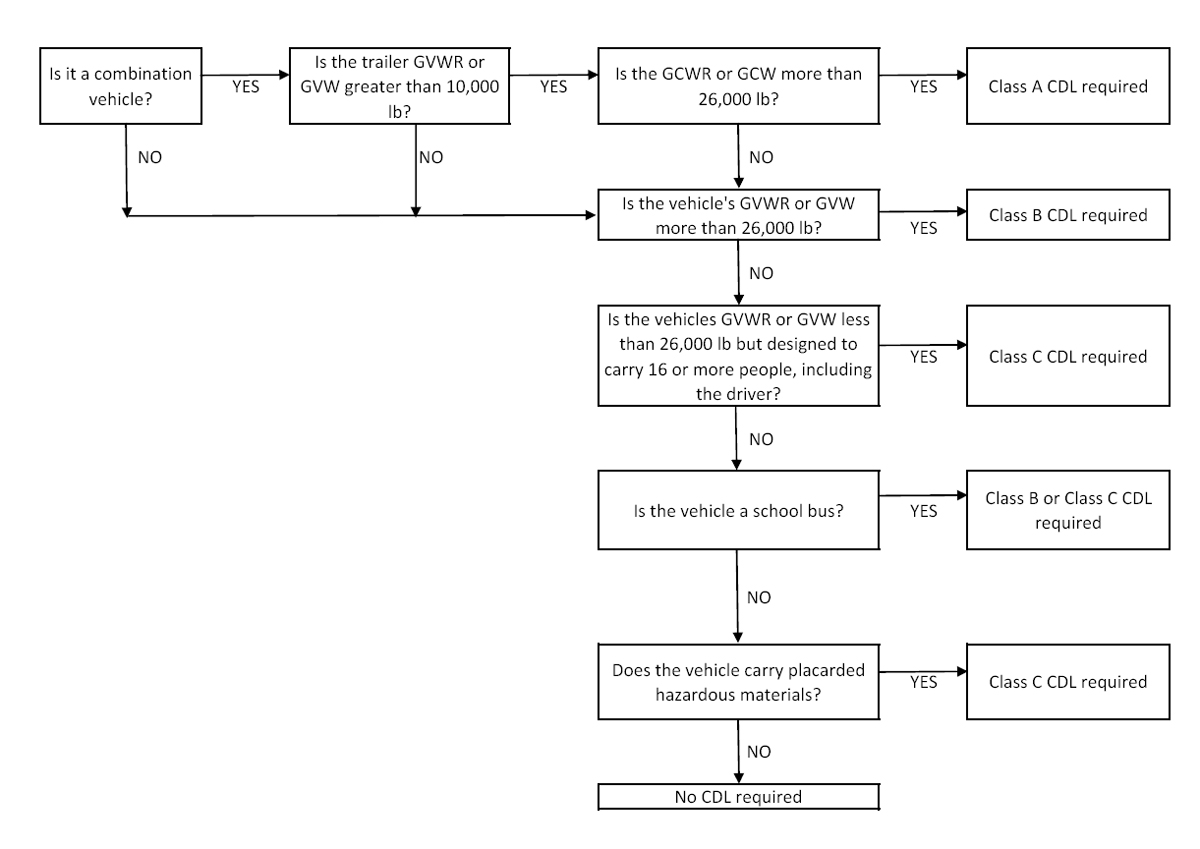

I've posted this before, but here's a GVWR/CDL guide that I put together. There is an incredible amount of mythology and misinformation regarding state and federal requirements as they pertain to hauling or towing. It's no surprise that there are "officials" out there that don't know the law either.
This flow chart is only applicable to "commercial" use of a vehicle and is not necessarily applicable to private use of a vehicle. Most of us are not engaged in a commercial enterprise when we haul our tractors around so are not held to the same regulations. This is why we see people hauling massive campers around all summer long without a CDL, and we don't see huge lines of non-commercial truck/camper or truck/trailer combinations stuck at weigh stations. There's a clue in the Commercial part of Commercial Driver License. If you're not involved in commerce then you don't require a CDL.
If you have a commercial sign or logo on your tow vehicle you might want to take a look at the flow chart below. The Kubota dealer in Sheridan, WY and the one near me have been stopped many times when hauling a tractor or other piece of equipment but they're towing for commercial reasons so they're held to a different standard.

I'm not sure about the second item on your flow-chart. What exactly does the trailer being 10k have to do with it? The rule on CDL is 26,001lbs or more, whether achieved as a truck and trailer or single vehicle. The type of CDL is determined by other factors which you list. Here's an example: if you are driving a RAM 5500 dump truck, it has a GVWR of 19,500lbs. This means if you tow a trailer behind that truck, it can only weigh 6500lbs. One more pound, even though the trailer is well under 10k, requires a CDL.
Furthermore, the "hotshot trucking" industry thrives on drivers operating a 3/4 ton pickup and a long gooseneck trailer rated at 16k. Together, they make up 26k GCWR and fall under CDL requirements. There are still other requirements, such as logbooks, weigh stations, etc but no CDL is required.
One of the dumbest rules is how a 3/4 ton pickup can tow a gooseneck grossing 16k but a 1-ton, single rear wheel truck cannot pull the same trailer without a CDL. There is essentially no different between a 3/4 ton and 1-ton SRW truck aside from some minor suspension / axle differences.
Because that's Federal Law as it pertains to the commercial use of a trailer. If the trailer GVW/GVWR is 10,000lb or over a Class A CDL is required, but if the GVW/GVWR of the trailer is less than 10,000lb a Class B CDL is required ... for commercial use. Follow the arrows ... it's kind of obvious.
I'm going to respectfully disagree. My employee has been pulled over by State Police for speeding while driving my 2500 truck and a 30 foot 15,900lb gooseneck. The employee's standard non commercial license was not an issue.

I will respectfully disagree too. Whether or not a State Trooper (or whatever he/she was) cited your employee for not having a Class A license is absolutely irrelevant as to whether or not a Class A CDL was required in that situation. The Federal rules for commercial use of a tow vehicle with or without a trailer are very clear, regardless of whether or not they are enforced by a LE officer during a stop.
If your truck is being used for a business, and your employee was pulling that trailer for your business, then he should absolutely have a CDL according to Federal regulations. This is not my opinion, just a statement of fact based on readily available regulations.

MCMXI stated it correctly.
Its GCWR of 26,001 or greater. Many people mess up on the GVWR of the towed vehicle (trailer). That 10K requirement ONLY determines which CLASS of CDL that you would need on once you cross the 26,001 threshold. Class A for 10,001 and over, Class B for 10,000 and under for the towed vehicle.
In your example Troverman, Ram 5500 at 19.5K GVWR plus a trailer at say, 9K requires a Class B CDL. That same truck pulling a heavier trailer in excess 10,000 lbs (GVWR) would require a Class A CDL.
Also, what a lot of people miss, is you have to use the GVW"R" (rating) of both vehicles. It doesn't matter if the trailer is empty or not.
The larger question is if you are actually "commercial" in your state.

Troverman, I would agree with almost all of your answers.
- any combination over 26K is CDL territory, but trailer under 10K is Class B, trailer over 10K is Class A. Of course, Class A would also cover any Class B setup as well.
Regarding under 26K GCWR, you do not need a CDL regardless of the trailer GVWR. I have heard from some folks that suggest a medical card when towing a trailer over 10K. I have not seen that requirement in writing.
I also have a 14K GVWR truck that I could pull up to 12K trailer to stay under CDL requirement. However, the GCWR on that truck (specified by manufacturer) is only 24K. I don't think LEO's care about what the manufacturer recommends...only that you are under 26K combined and that you don't exceed the GVWR on either the tow vehicle or trailer.
