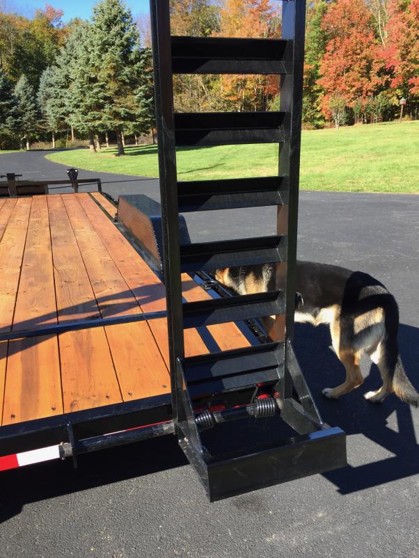

I got my equalizer hitch in the mail a few days ago. It wants the load on the trailer to set it up properly. So I was preparing to drive the 2650 on the trailer for the first time.
When I was with the salesman and ordering the trailer I told him it was for the 2650 and my zero turn. I was concerned that because the zero turn had such a narrow wheel base in the front I wouldnt be able to get it on and wasn't sure if I should upgrade the ramp to the mesh one and he said dont worry about it! the ramps are adjustable! You'll be fine...
I ordered some extra D rings and rub rails. I thought it would be good to have some extra tie down points. It became a custom order. When it came in I went to pick it up and the sales guy said hey look they added some extra wood on the sides to give you more working room. I thought nothing of it. I was just like Oh cool.
I moved the ramps inwards as far as they could go. When i started to drive towards the ramp is when I noticed the front wheels of the 2650 just touch the inside edges of the ramps.

Your cheapest solution is to add another pipe mount and a longer pipe. Only need to move one ramp inward to accomodate mower.

Probably a picture issue but... it looks like your pivot pipe allows you to wiggle the ramps inward but you are saying that is still not enough... I agree, unless your zero turn fits on the aft end of the trailer, trying to drive over the wheel boxes is dumb but, if you need the full width of the trailer, then its of use.
Yeah, if the ramps are set too far out, cutting the hinge bar off like TJ said is the easiest and cheapest alternative. Or, a welding shop could cut the bar mounts off and move each one in 4-6" and re-weld them. A third alternative would be to add a 6" strip up the inside of each ramp topped with mesh for better traction. That alternative makes the ramps heavier to lift though...
I bet a good welding shop could fabricate and install you just what you need for well under $200. And, you could add any little custom features like extra skid plates or tie down tabs while there. Then you'll have a truly "custom" trailer. Otherwise, the trailer looks awesome.

The ramps do not move close enough together. Here is a better photo.
Its as close as can be and its 39 inches from the inside edges. I would need at least 30 inches to accommodate the B2650 front tires and 26 inches to accommodate the Scag.

Looks like the easiest way to solve your problem is to have someone cut off the ears, (the round bar goes through) on the inside of each ramp.
Then have them welded closer to the center of the trailer. The only additional part needed would be a couple of longer solid rods. (and some paint)

The gate you show in post #11 is what you need to solve the problem with both machines. I has the width and it has the expanded metal mesh which will allow the safe loading of the 0-turn.
I'd go back to the dealer and ask them to modify or add as you want. Let them foot the bill.
Get the ramps as long as you can because it will help getting over the hinged area with your 0-turn.

much better picture this time...
in post #11 is the best looking solution for you... but it will be heavier to fold up.
a real easy way to fix this is to get a longer bar & move the ears..
or you could do a full width bar... thats pretty easy for you too.. you dont even have to cut the ears off that way.. you can just take out the bar, move the ramps over to clear the other ear & put the bar back in..
just a note for you: your turf tiger is NOT going to like those ramps if you dont put some mesh on them. & depending on your tires size (24's?) you will drop down in those spaces a pretty good bit.. making you kinda "hop" up that ramp.

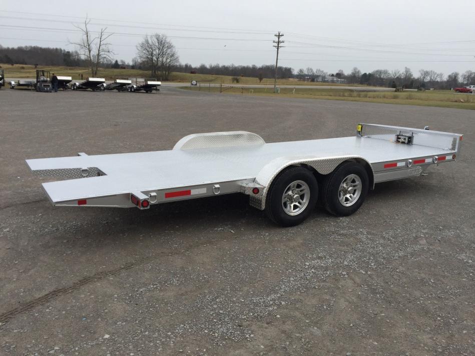

That's what I would like to get but with the back end solid across. I borrow my buddy's trailer that is a tilt like that but is a HD steel trailer that he uses for small excavators and rollers. They sure are nice, aluminum where I live would be a plus with all the road salt, one I saw locally for sale at a dealer was $9K :eek: Cost to borrow one he two times a year I use it.... bottle of rum :rolleyes: tough to beat that price.

I looked at the aluminum trailers too. Its much more $$ than I could justify.
