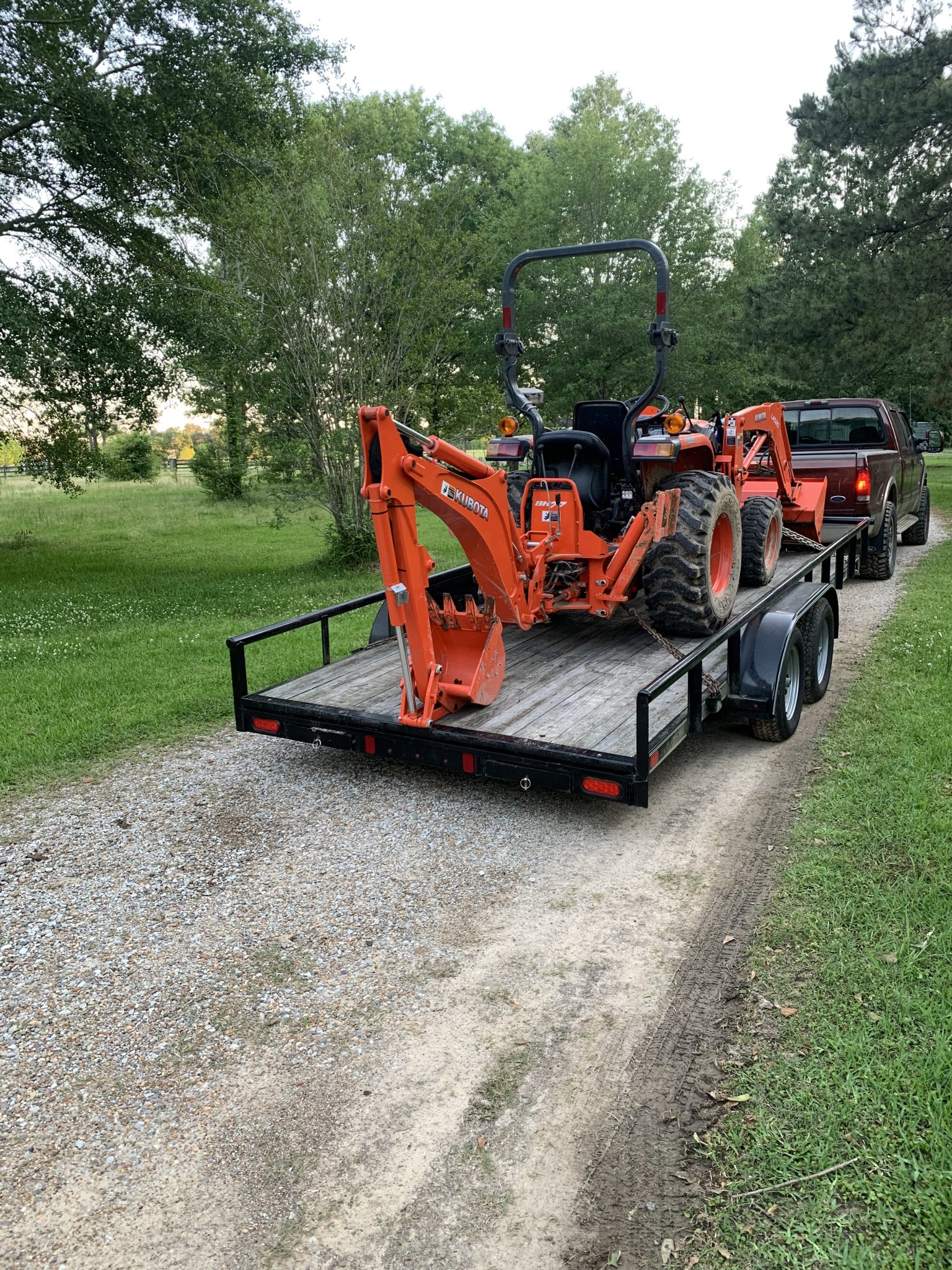

My L is the previous series to yours but very similar. On an 18 ft trailer. 16 ft may be fine without any implements. If I were to do it again I would probably get a 20 ft, with loader and bush hog the mower hangs off about two feet. I don’t trailer it very often tho.

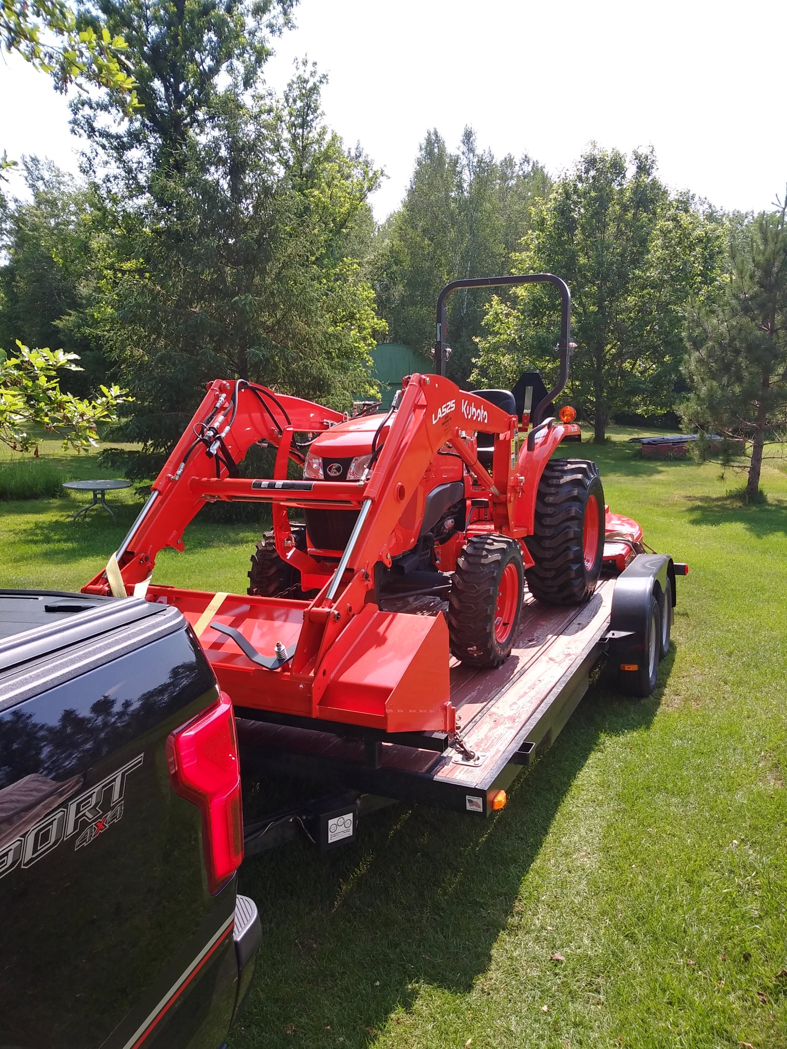

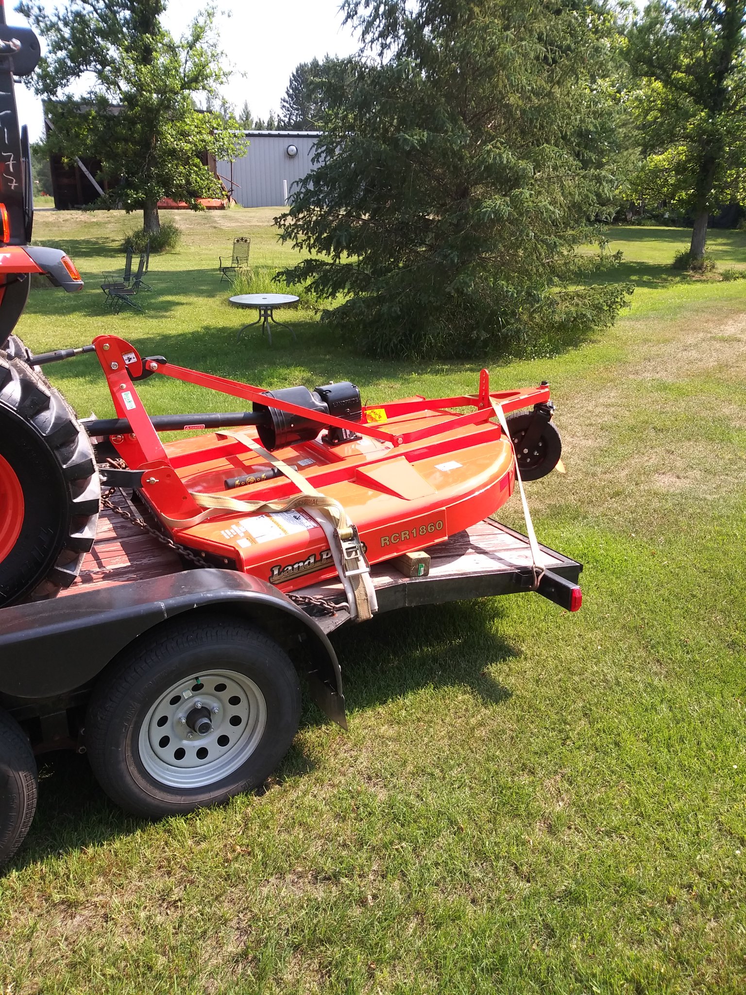

This is my brand new L3301 with the 60" rotary mower. With the bucket placed like it is, the mower hung about 18-20" off the back of my 18' trailer. An 18' trailer would be perfect without any attachments. Tires are filled with Rim Guard and the trailer really squatted while I was loading.
Never had any rub or scraping issues while towing.
