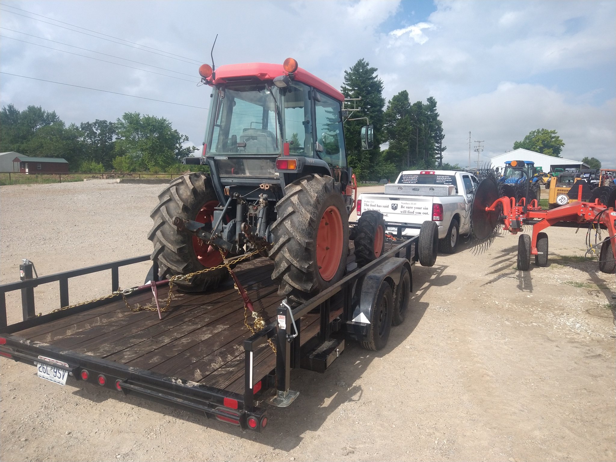

My cabbed Grand L is about 4300 Lbs, tires are NOT loaded ... It doesn't max out my truck or trailer, I really have not much reason to take it with anything anywhere, but could legally ...

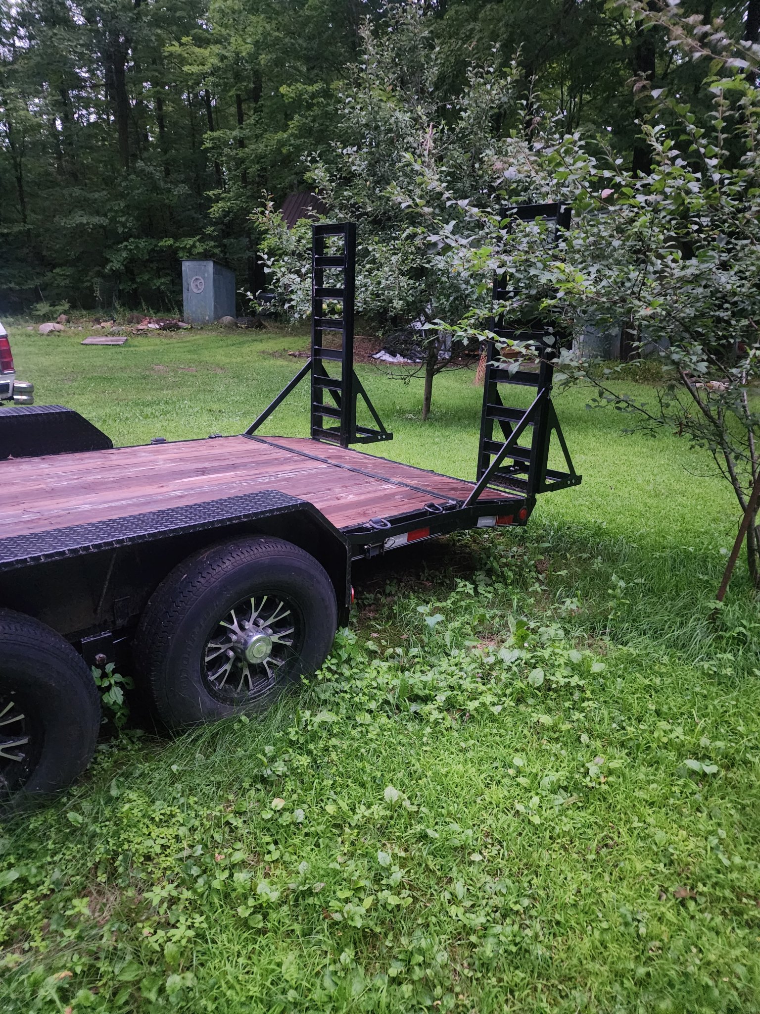

Rear jacks are handy for loading and preventing the "run-away" scene in the video above, also is easier on your rear axle.

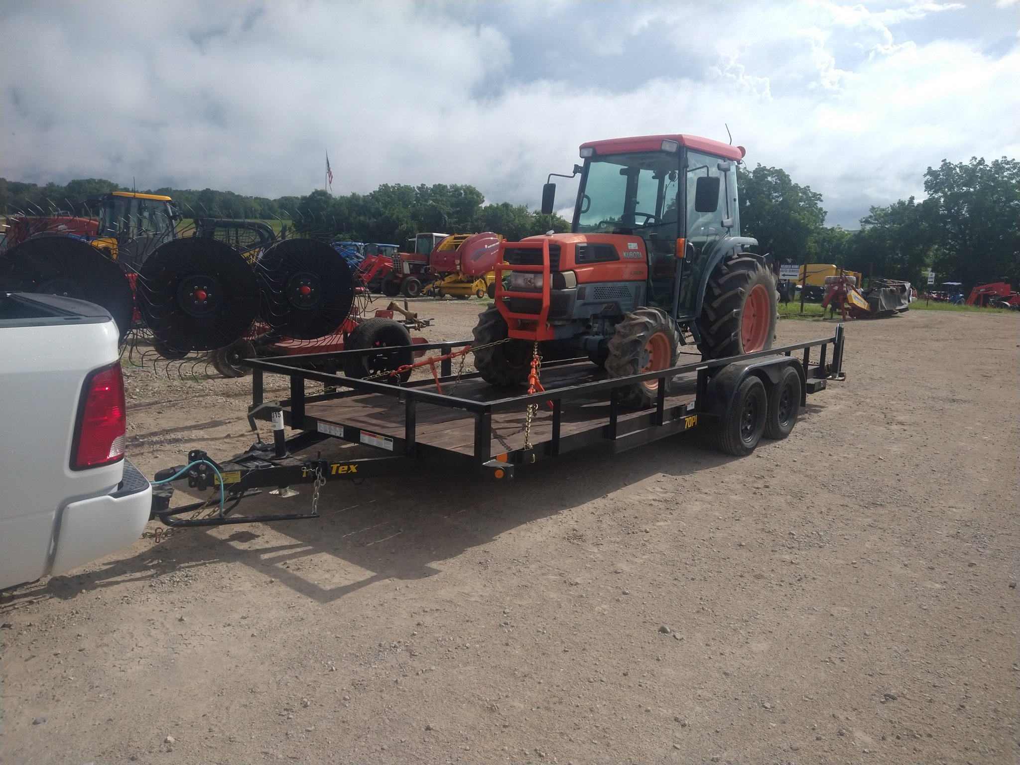

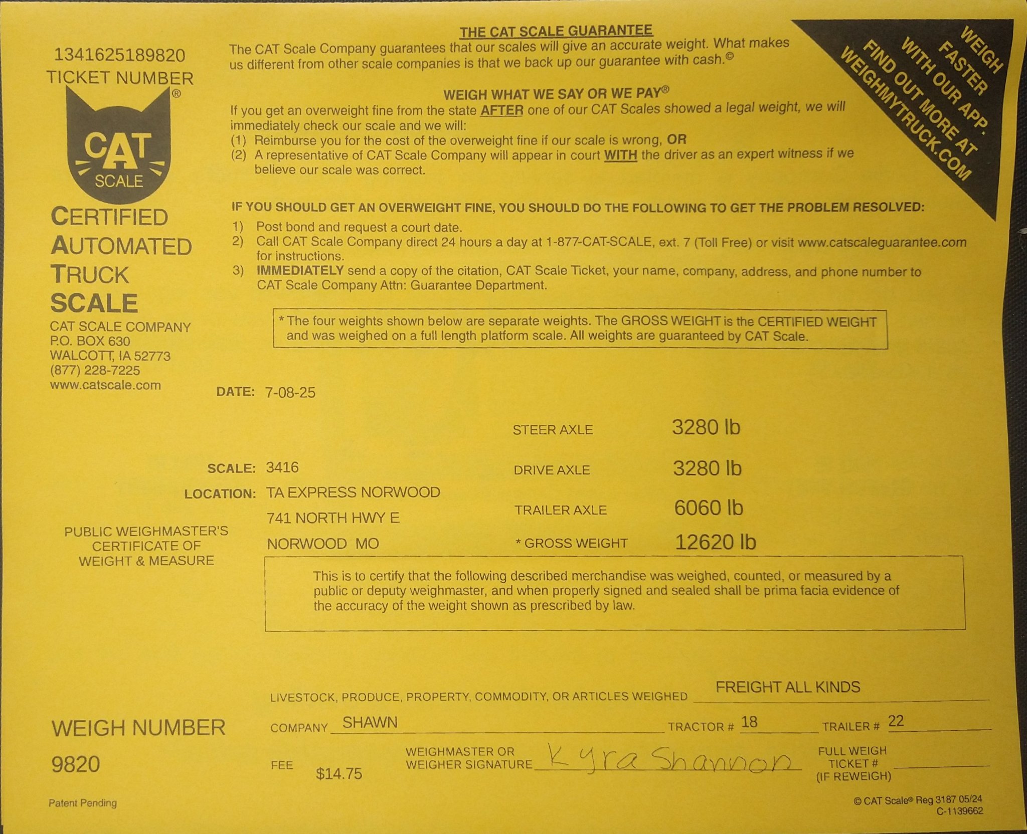

Proper tongue weight is important ... This is on a 20' 7,000 Lb rated trailer, which has an empty weight of just over 2,000 Lbs ... I use a weight distribution hitch. (Recommended by manufacturer on my RAM 1500 on loads over 5K gross)
By eyeball adjustment while loading it, inching it forward until it looked fairly level on both the truck and trailer, I got the following weights ...
It pulled good, too light on the tongue will/would cause swaying ... I made a mental note of where I had placed it ...

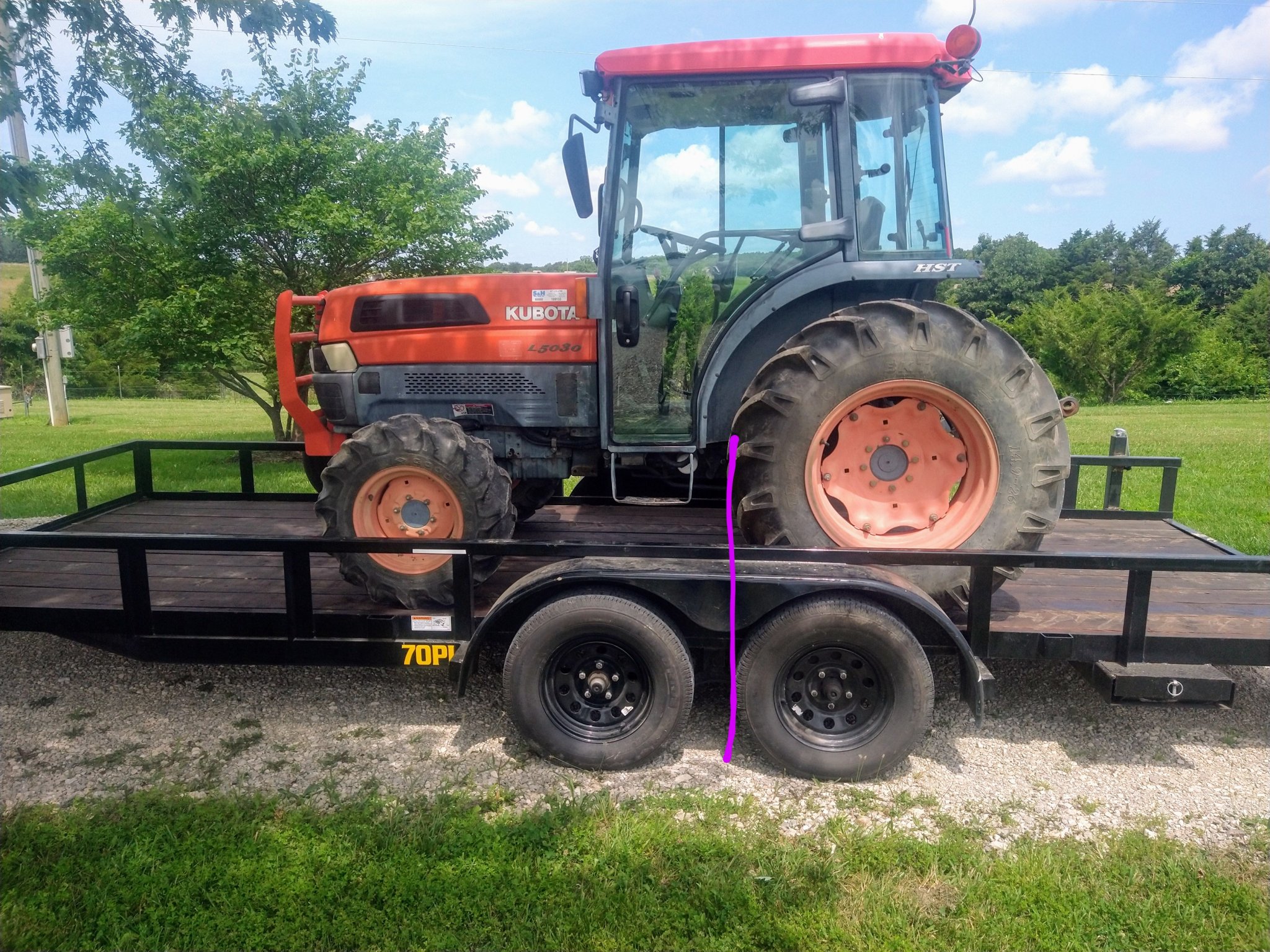

I'd put a mark on the top of the rail so I'd be able to see from the seat of the tractor where I need to land next time! Centerline of front or rear axle.

One thing that is a must have if you get a trailer with ramps is stabbleizer jacks onthe back (been there don that ).

My trailer has jacks built into the ramps... no issues. 22' 14K dovetail.

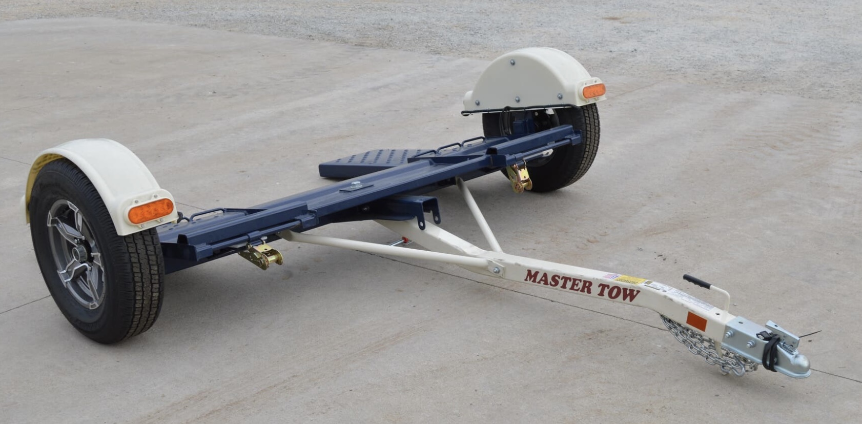

instead of another trailer you could probably make a dolly with a long tongue to pull the trailers you already own?
Like this with a ball in the middle

Interesting idea. I've thought about a long section of box section with sufficient wall thickness that pins to the underside of the smaller dump trailer and has a coupler on one end. I have my eye on Berkelmans Welding trailers for a turnkey solution but they're around $10k for something I would want. Perhaps 5% of the cost of a trailer for some steel and a coupler to get 50% of the function and utility of a Berkelmans might be a much better investment. I still really like those Berkelmans though.

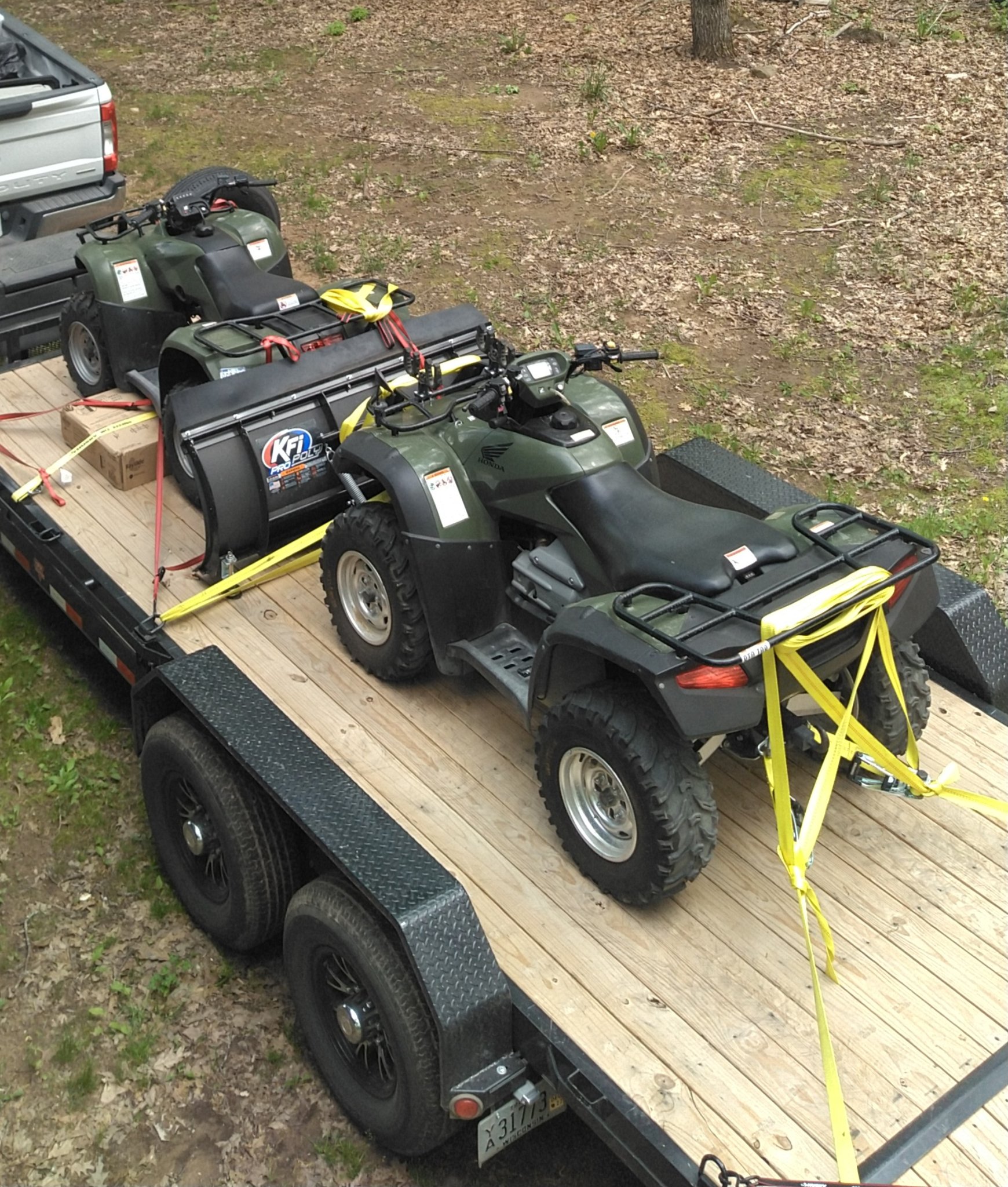

20’ 10K flat bed for my B2650. I regularly put an implement, like my grader-scraper, at the front, then grab another item for the tractor and load up. With the grader, tractor, and box blade I have about a foot left and still put the ramps up.
Loaded as described, my total combo is 7,600# on the trailer axles. Tows like a dream behind my Tundra. I do have brakes on both axles and everything is very well maintained. I did bump up to 235/80-16 tires when ordering the trailer, which helped with towing stability.
I would not want less trailer for my use.

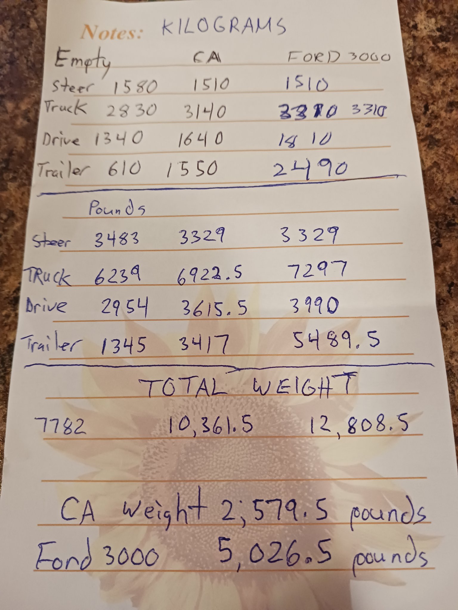

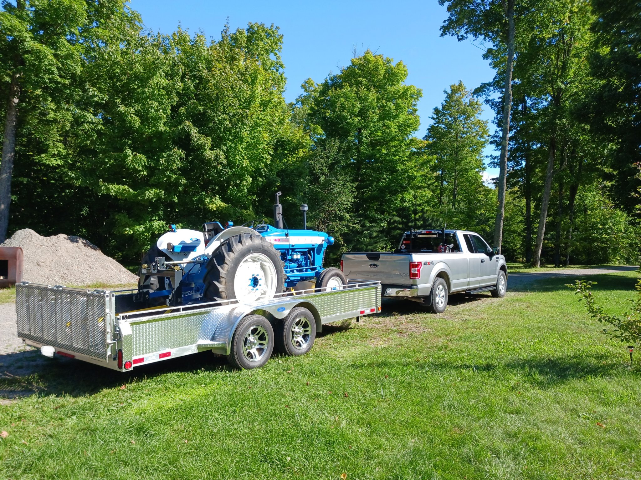

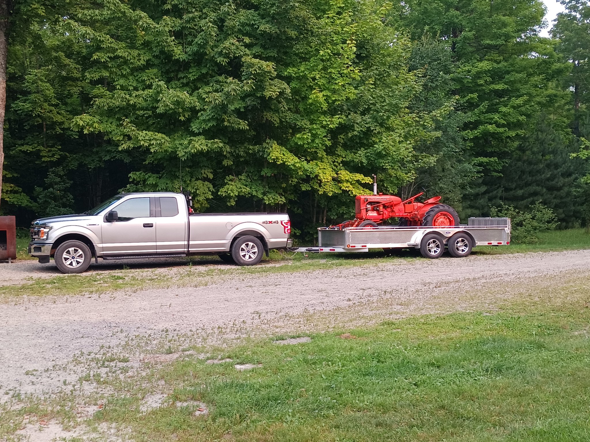

On my aluminum trailer I used to put wood blocks under the rear and the ramp when loading/unloading but my new trailer has the rear jacks which is way nice.
Here were my axle weights when I scaled one time while hauling a couple of the antiques to a show.
First column is truck and trailer, second is with the CA on the trailer, third is the Ford 3000 on trailer.
Top box is in KG's middle is pounds.
And where it says "truck" that is both truck axles on plate.
With my tractors I generally put the rear axle over the center of the trailer tandem and it tows and handles good like that.
