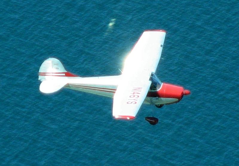

No soap. 3 cups WD40 in a 5-gal bucket….forcefully add water…used for soap/detergent. It dissolves grease, and leaves a “chamois” finish that water beads-up and runs off. Lubricates rubber weatherstripping and gets into crevices, lubricates hinges/latches and prevents rust. (This is an old “Hints from Heloise” trick…only she recommended kerosene in water instead of WD40 for car wash. I use this same formula on my never-polished in over 20+ -years, 1953 airplane instead of soap (which dulls aluminum.) Blah! No Soap!)
Sweet looking 170B !!!
