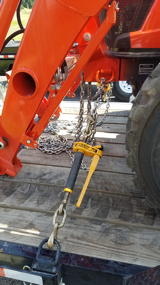

I found existing bolt points and grade 8 bolts on my BX - D rings from Harbor Freight

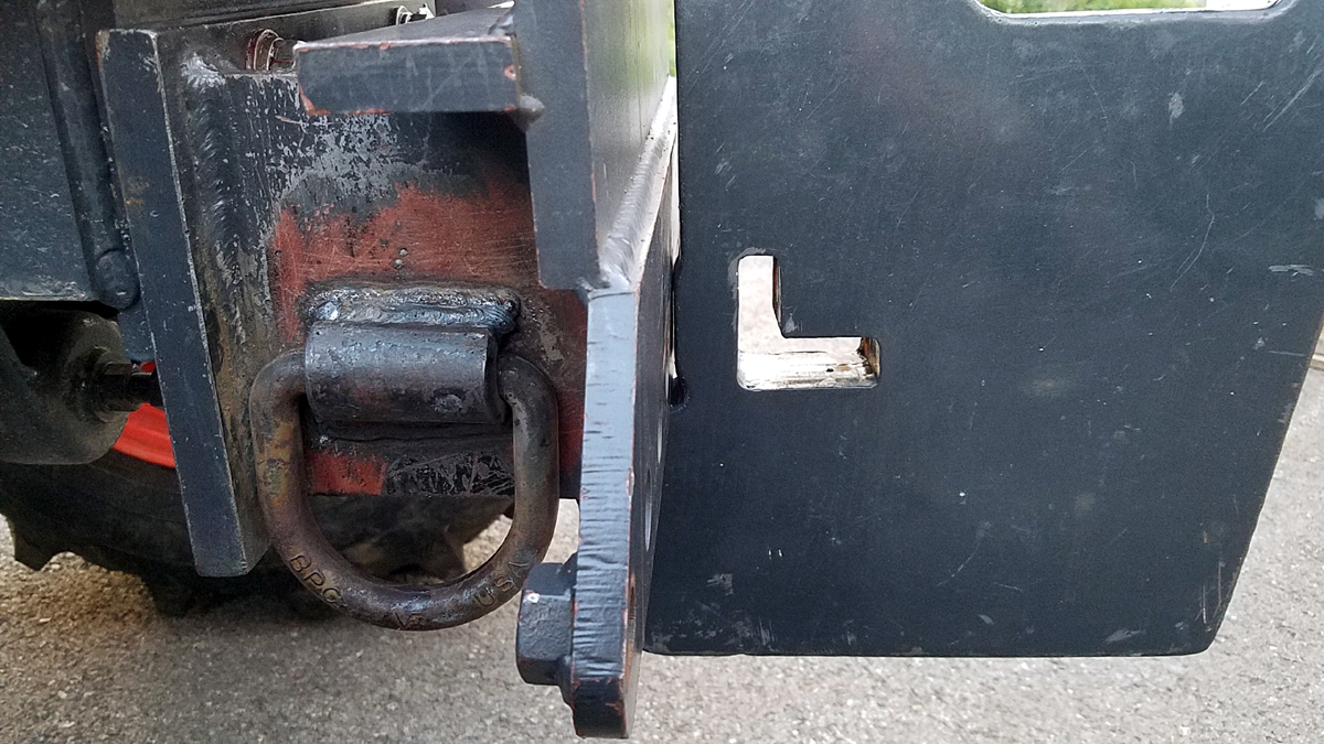

I welded on D-rings to the front "bumper" or weight bracket on both tractors. I have a spare front bumper for the MX and will redo the D-rings when I finally get around to fabricating a custom grill guard.

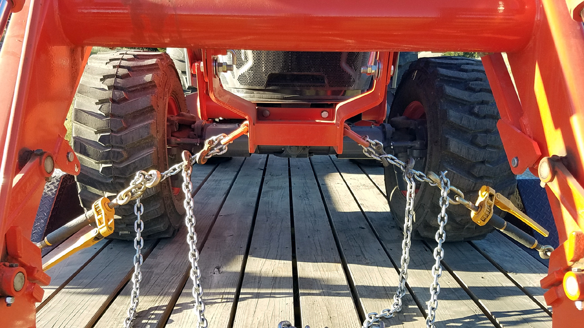

I don’t have photos, but I’ll explain the best I can. What I do on the dump trailer:
The rear is chained through a D ring shackle that is attached to the draw bar.
The front end is strapped around the loader mounting tubes with chokers. On the flatbed trailer I use the chokers on the front tires like a car.
6,566
3,967
Throw a chain over the axle-housings. Simple.
