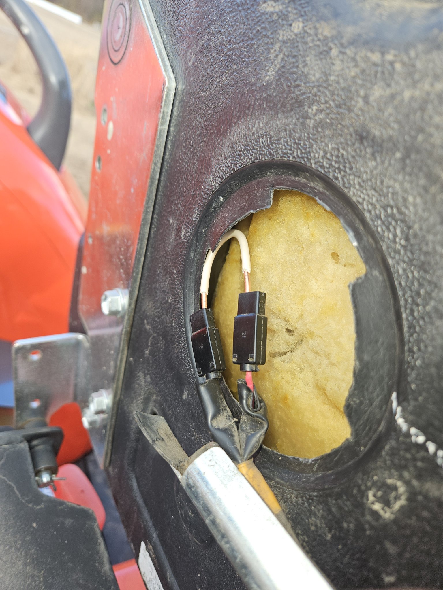

I have an l3902 bought new 2022. 97 hours on it. When I hit the hst pedal, the tractor dies. It throttle up all the way and idled at the 540 rpm mark for 15 minutes. I bypassed the seat safety switch with a 12 guage wire. I tightened the pedal safety switch nut. I have no idea what else it could be other than a wiring issue which kubota will not cover because it is 2 year amd 6 months old.

How did you bypass the seat switch? Picture? Has it worked before the problems you’re having today?

I didnt need a bypass until today. And it worked when I parked it a few days ago.
That wire looks awful big to make a good connection. Male spade connectors fit better. If you have a multimeter, you can test the switch easily.

Thank you. I will try to get a spade connection and see what happens.

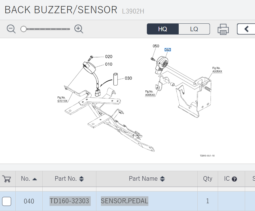

The safety switch above the pedal or something separate? Got to find a part number i can order.
Before you just throw parts at it use the WSM (aka service manual) to verify that is really the issue.
32,819
8,315
This is the part you will test then replace if needed.
