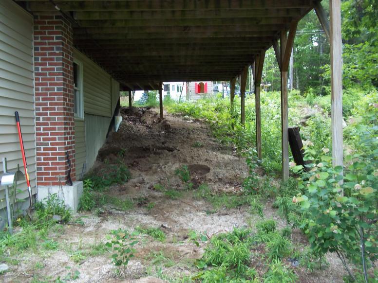

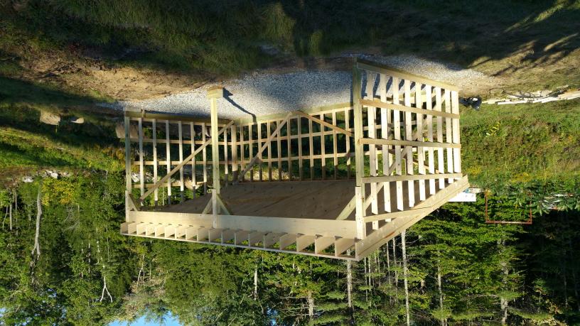

I don't have a pic of when I park my tractor. But I had this built this past summer. 12' x 24' - Steel roofing on the roof and the walls. $3600. , I have my rotary mower- woodmaxx chipper-Toyota corolla-riding lawn mower-bicycles ect stored for the winter. I can't believe I don't have a finished photo of it. But its very basic and keeps the implements under cover summer and winter.
(what the hell....its up side down)http://www.orangetractortalks.com/forums/attachment.php?attachmentid=9073&d=1385247979
http://www.orangetractortalks.com/forums/attachment.php?attachmentid=9074&d=1385248279
Theses were from 2013 posts where I made an area under my deck to store my new tractor. Works great for me. Keeps it out of the weather.(I hope the copy/paste thing works)
