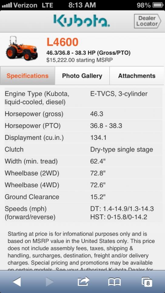

I have an L4600 HST and it is a great tractor. I think you're going to love it!
One thing about your post though - L4600 has a 3 cylinder engine. Plenty of other threads on here about why that may be the reason it runs so smooth.
The specs on the Kubota L3200/L3800/L4600 brochure as well as Kubota website both indicate a 4 cylinder engine on the L4600. Both the L3200 and L3800 share the same 3 cyl engine.
Here is another link also indicating 4cyl on the L4600.
http://www.tractordata.com/farm-tractors/007/2/1/7210-kubota-l4600-engine.html
Why do you think the 3 cyl runs smoother than the 4 cyl?

The L4600 is a very good rig and 4cyl like you said. I likely would have gone with a L4400 or L4600 if my dealer would have had one at the time and if he had not offered me a L3800DT W/5' Land Pride mower for 16k out the door. :cool:
