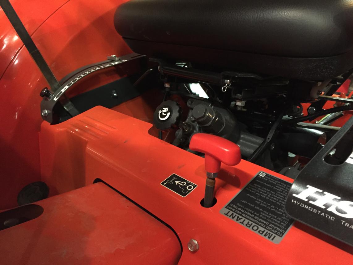

Hi Gents, I have a L3301. I believe this knob to be the adjuster for the TPH lifting speed. I'm not able to turn it either way. Should this turn fairly freely or am I doing something wrong? I haven't applied a ton of force because I don't want to break anything. Any thoughts?

If it's never been turned it's just stuck, turn it counter clockwise as it probably is set all the way fast. ;)

It changes your lowering speed and will lock it fronm dropping. If its going down quickly now, i would try moving it clockwise. If three point is lowering slowly i would try moving it anti-clockwise. A little penetrating oil down shaft and sometimes a rag wrapped around knob and s pair of pliers to persuade it. Be gentle yet forceful.

Your original question was about 3pt lift speed. You do understand the knob you're talking about only controls the lowering speed, not the raise speed.

I wasn't aware it was strictly for lowering. Thanks for the clarification. I haven't been able to adjust it. In the manual it also shows a "lock" position but I'm sure how to get it there.

I have had to do like tooljunkie said and spray some penetrating on the shaft and let it soak in for a few minutes. Then rock it back and forth, normally some gentle force will break it loose. Last time I needed to turn mine I had to use oil and then clamp a pair of vise grips on the shaft so I could rock it from side to side. Broke free real easy without any damage.
To use it as a lock is simple. Raise the 3pt to where you need it to be and turn the knob fully to the right (clockwise) and it locks the arms in position. Nice feature when you need to get under a implement and not worry about it falling on you.

TPH adjuster seems quite stuck. I sprayed penetrating oil down the shaft but I'm still not able to turn it. I only used my hands, I could put a wrench on it put I don't want to break it.

I had to use vise grips on mine. Just make small moves from side to side and more than likely it will break loose without doing any damage.

Shaft is stuck from lack of use.

I wrapped it in a rag and used a big set of channel locks and it broke free. the channel locks still marked up the knob. took a lot of force.
