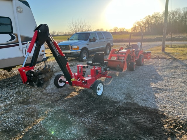

I am with you. I would be interested to see one converted. Heck, if someone did it and did a decent job I may even be convinced to pay them to convert mine. The biggest drawback I have found so far with this one is the mobility issue.

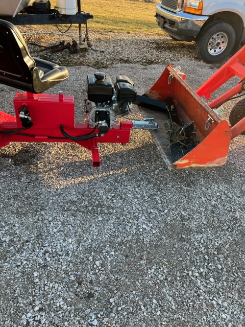

Might not technically be an attachment, but I use the BX to move it around the property.

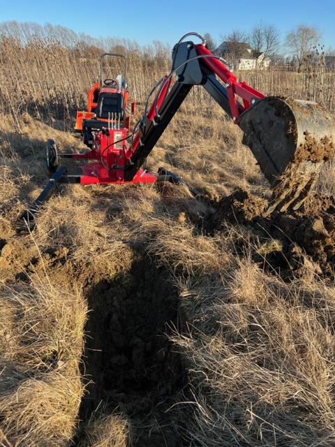

Got delivered on Friday. Put it together and tested it out today. It’s going to take some practice to get efficient with it, but still a whole lot better than a shovel.

Just "spit-ballin" here, but maybe some sort of front axle and a hydraulic motor to a chain drive, similar to an old school Go-Cart?
Obviously nothing high speed or fancy, just enough to make it easier to move or possibly independent of the tractor.

It could be done. There is a guy who built axles and can drive it around.
it is all a matter of time, money and fabrication skills.

yes, if you FF the video to +-17 minutes you can see the additional front wheels. a great 'upgrade' and not that expensive to do.
They used an ATV to tow it, though even a 'riding mower' could,it'd free up the Kubota !
