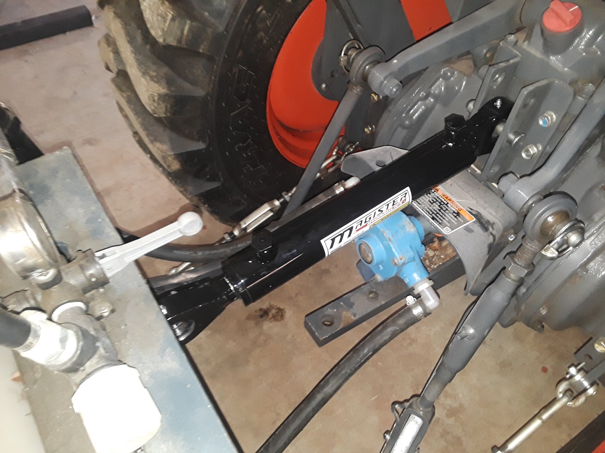

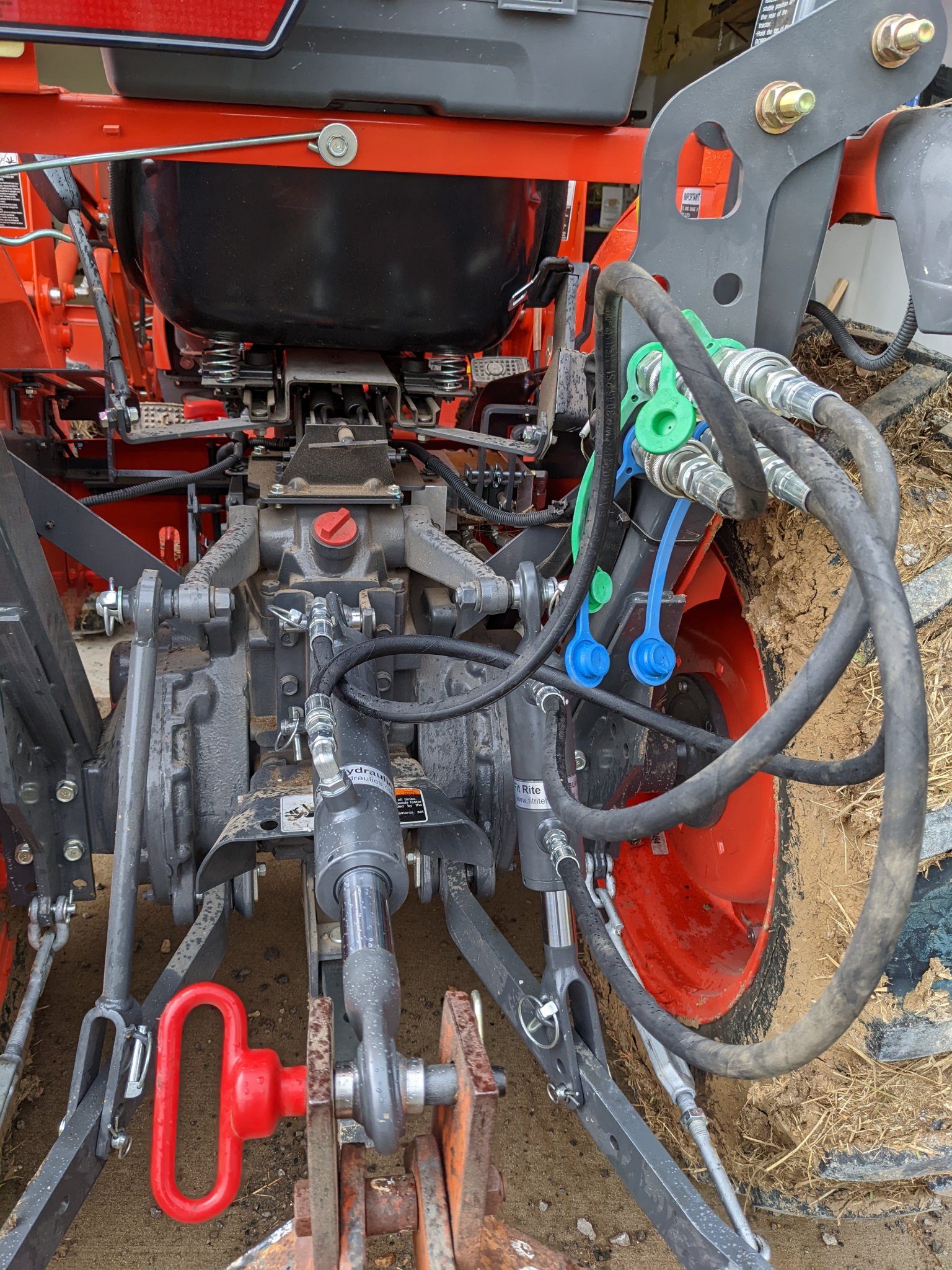

Just got mine installed today. Quality is top notch and worth the wait. I'm still working on the hose routing as I like to drop the box blade below the tires sometimes.

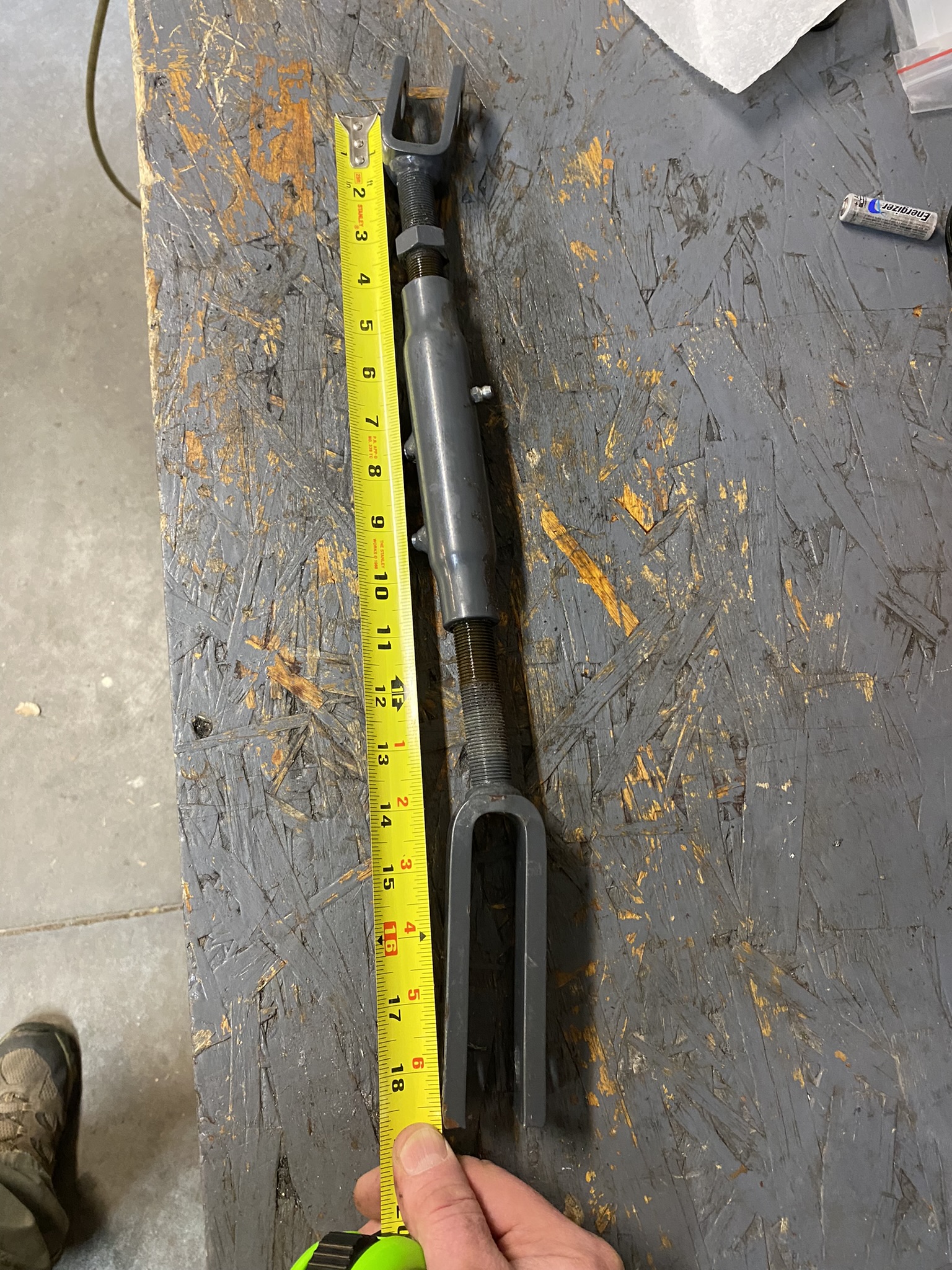

I've looked through a lot of threads to find a source for a side link tilt cylinder for the LX2610, other than Fitrite. I would love to have one from Brian but the current wait time is 36 weeks....9 months! Can anyone point me in the right direction of another source for a short cylinder with angled clevis ends? Thanks.

That sounds like its going to be a custom cylinder. Picture and length of the OEM you want to replace.

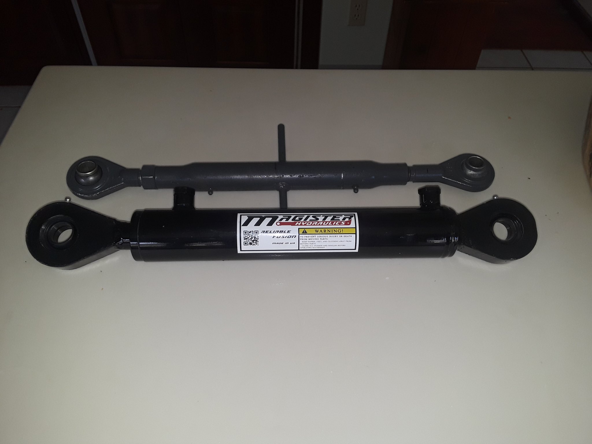

I had no sooner posted my previous replay when Fedex pulled up with this Magister cylinder that I ordered YESTERDAY. It was $169 dollars delivered.
Its a scant 1/2" longer than the OEM top link on my L3901 and will need two Cat 2 to Cat 1 reducing bushings. Otherwise it fits the hitch on the tractor just fine and will be operational later today. This will make one heavy duty top link.

Thanks--that should work.
Al
The only thing I would mention is with a 6" stroke cylinder you will be limited on how much you can raise the lift arm from level before you bottom out the cylinder.
I used a 4" stroke cylinder for the one I made. I also bought a spare fixed side lift rod to cut up to make the ends for the cylinder as it was easier and faster than fabbing up my own. If I were to do it over again I would have gotten the 1.5" bore cylinder as the 2" one I think was overkill. But it did give me more area for welding the brackets on.
I don’t think that monsterous rod end will fit my little B2601, even if the lengths were equal. I know for the smaller compact and subcompact kubota tractors they require a smaller diameter rod end than what is normally available.
The tractor innovation top link was not as nice as the previous one I had for my BX from fit rite, but with the much shorter lead time and lower cost it was worth taking a chance on. So far I’ve been happy with it and I changed my top link order with fit rite to a side link so I’ll have a top and tilt.
Hope what you found works for you, but I don’t think it would work on the B01 or LX series.

That particular cylinder was chosen for an L3901 and is way too big for a B or BX. It will barely pin on to my old B7200. The LX is really a rebadged B so it may be too big for them as well.
