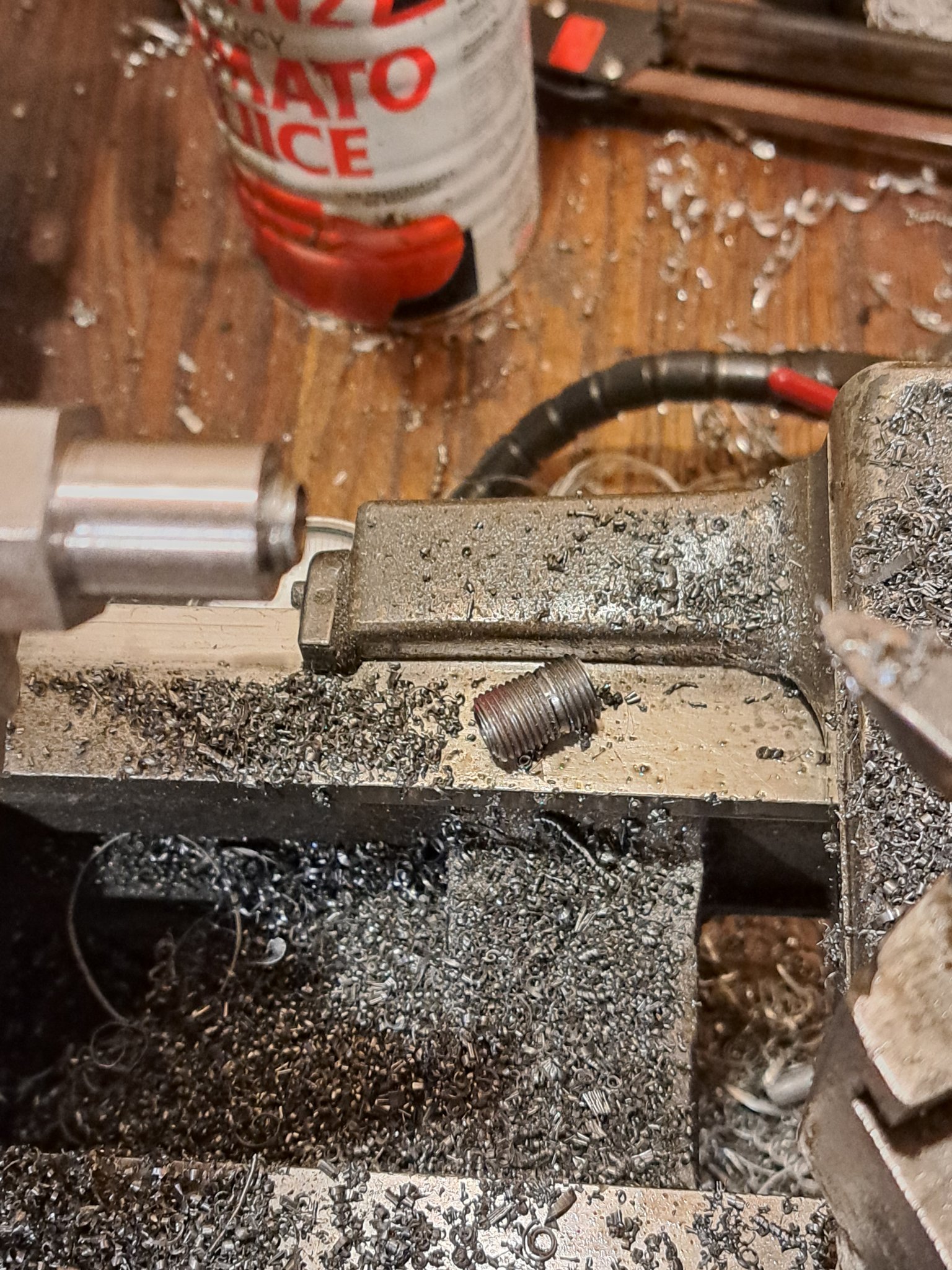

I am very happy with the 'tightness" of the fit, but I do see that the threaded part is a "wee bit" too long so I gotta trim it down a little.
No problem, I break out the facing bit again,and as soon as I touch it..BAM
FU@@ ME!!!!!!!!!!!!!!!!!!!!!!!!!!!!!!!!!!!!!!!!!!!
It breaks the fu@k off

At this point I turn the lights off and go mow some grass. You have learned a lot so bill it to your educational expense account.
Next time drill a bit smaller. Find a drill bit that fits the hole in the JIC end of the banjo or even a bit smaller. And get/use some better bits. A 1/8" cutoff blade is perfect for that thread undercut. you dont need much depth or width Chamfer the end of the thread before single pointing.

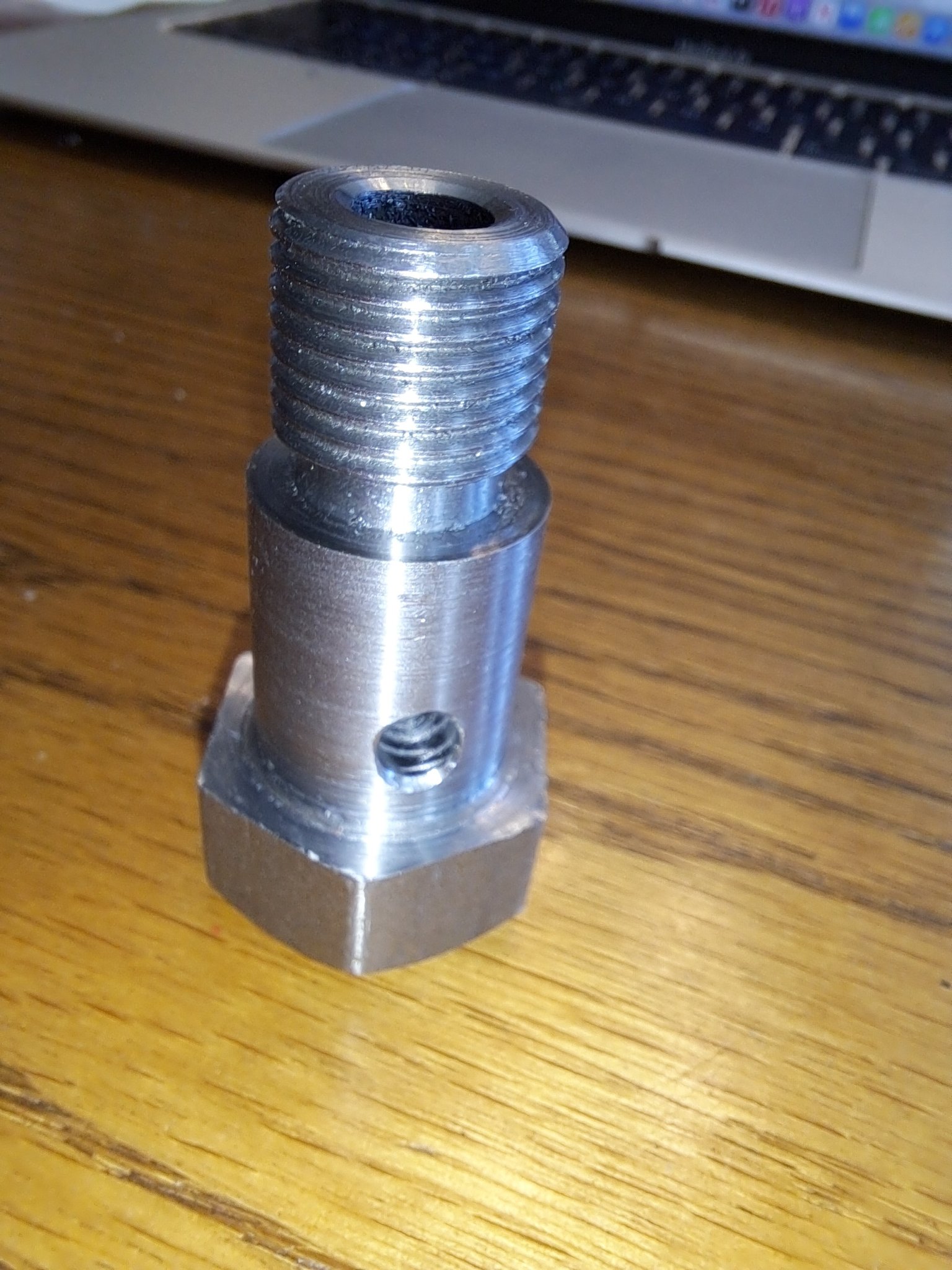

Looking back I made the "main hole" too big and "hogged out" too much for my "under cut"
I wont make that mistake again.......
Now I'm in some sort of mental "state of shock"
It put me in a sort of "fight or flight" mode, and I decide there is no way this motherfu@@er is going to win.....
I decide to Double Down, so I cut another piece off and have at it again......I did every thing right......
Except for taking too much off when I was threading it.....so the threads were too loose.........DAMN IT TO HELLLL!!!!!!!!!

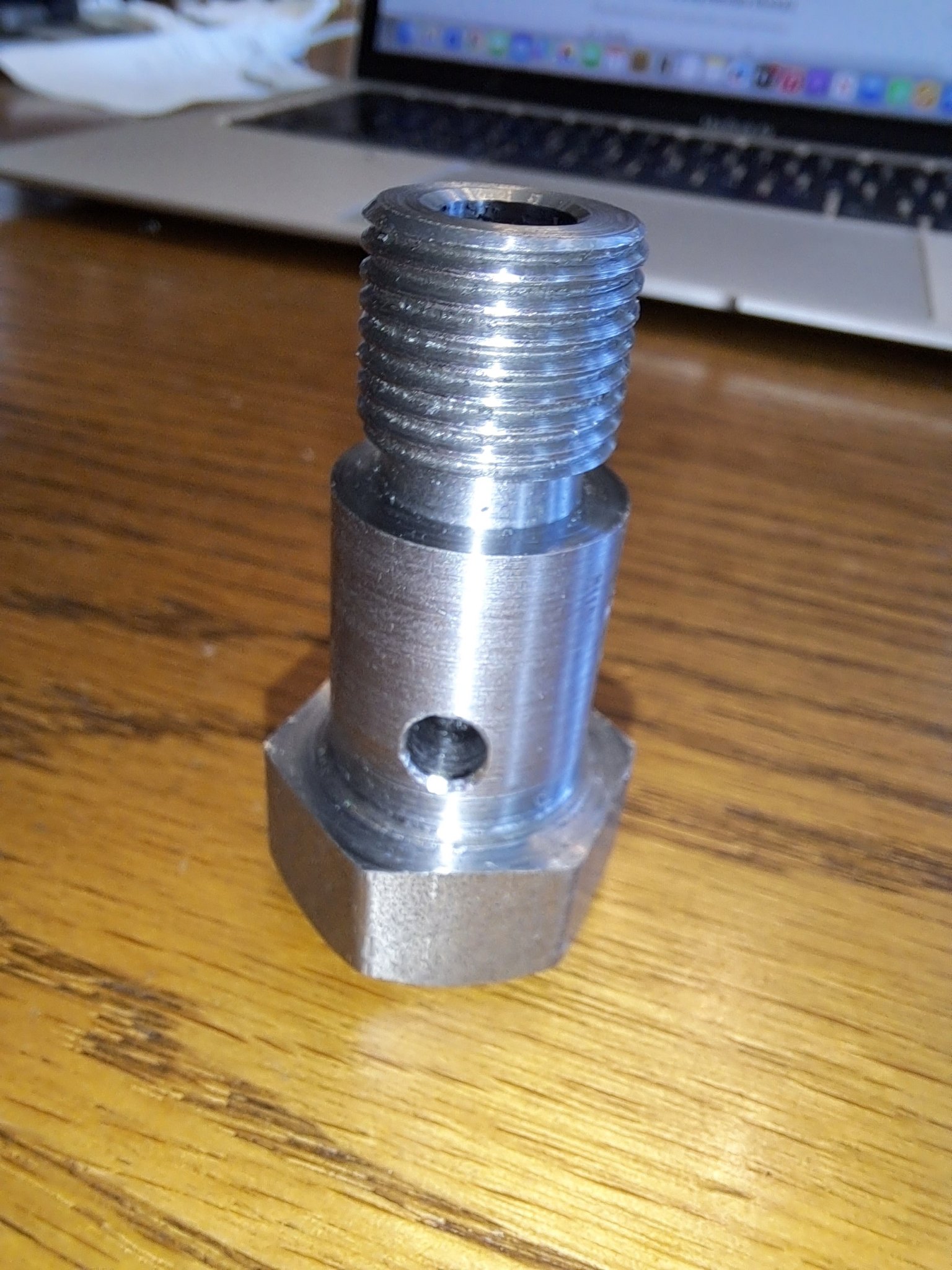

I cut another piece off and do it again.....................
FINALLY!!!!!!!!!!!!!!!!!!!!!!!!!!!!! SUCCESS!!!!!!!!!!!!!!!!!!!!!!!!!!!!!!!!!!!!
Now I feel like this
2,597
3,031
So after 14 hours, and an "emotional roller coaster ride", I had "my first custom bolt"

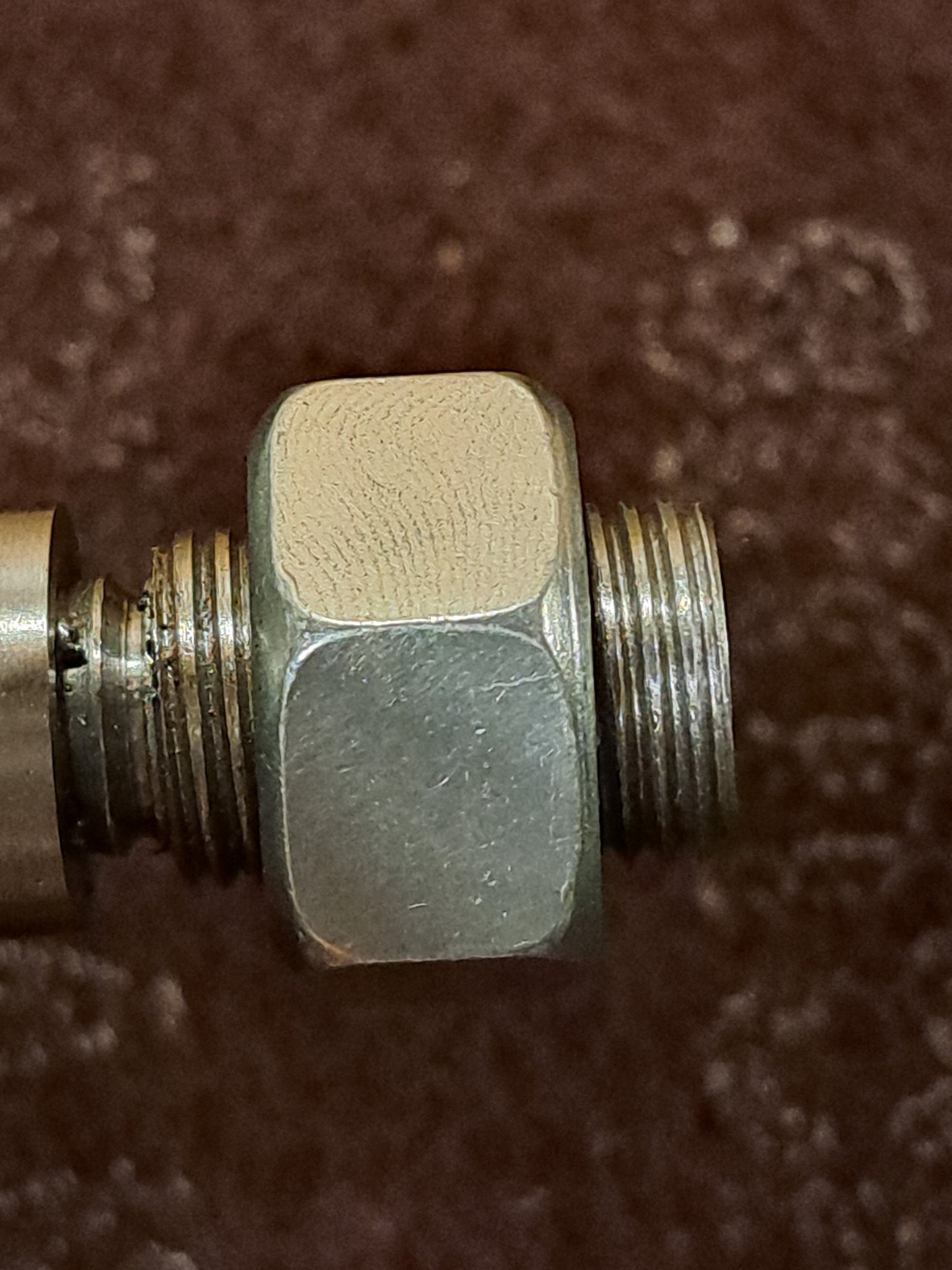

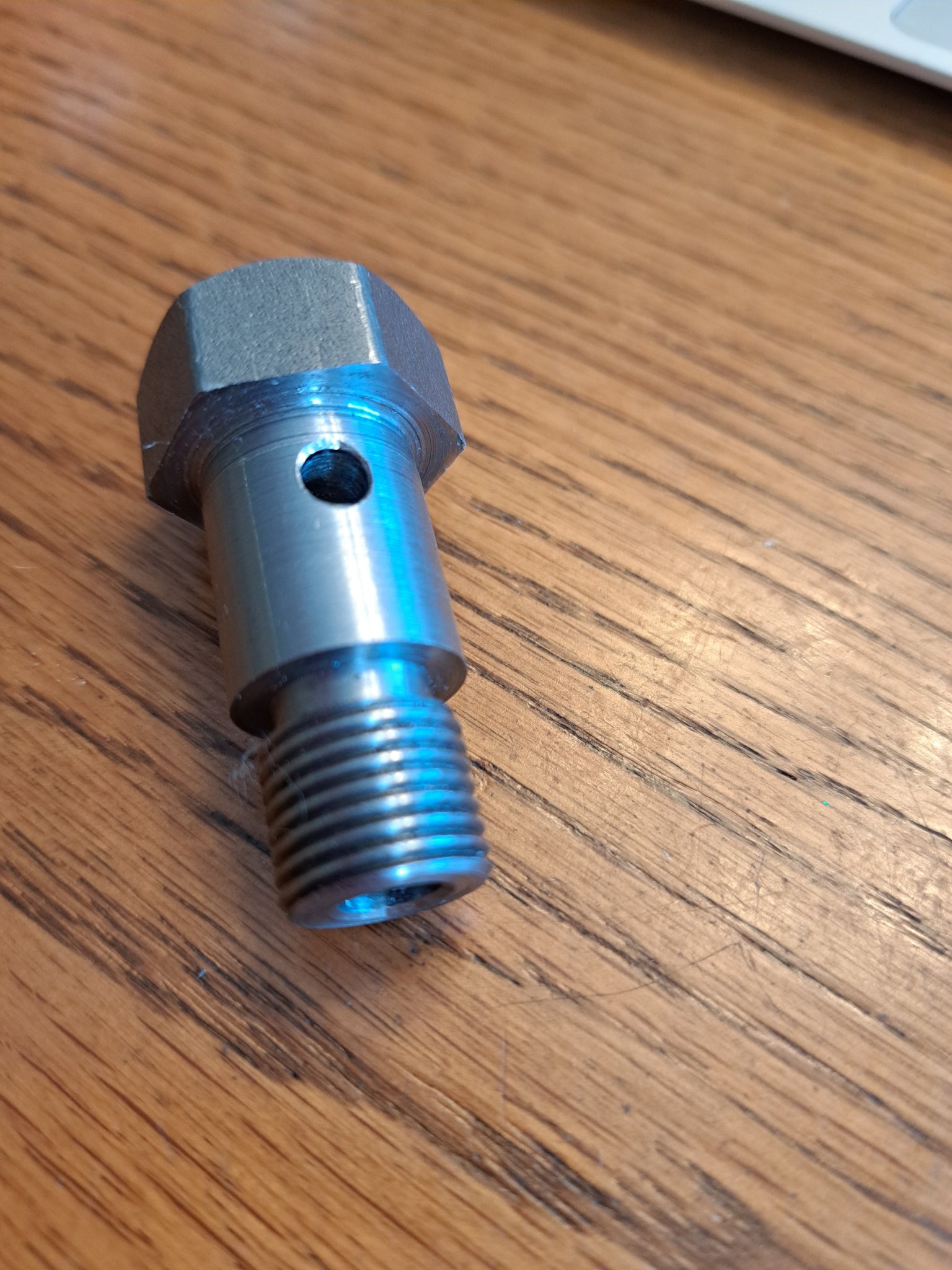

I forgot to add that I am super happy with the fit as compared to the "test nut", my bolt has no "slop" at all.
Here she is "naked"

Sometimes you just have to put lipstick on a pig and call it a day and start over tomorrow. Been there done that, and lived to enjoy another day. Best of luck in getting it finished before 2024! LOL..

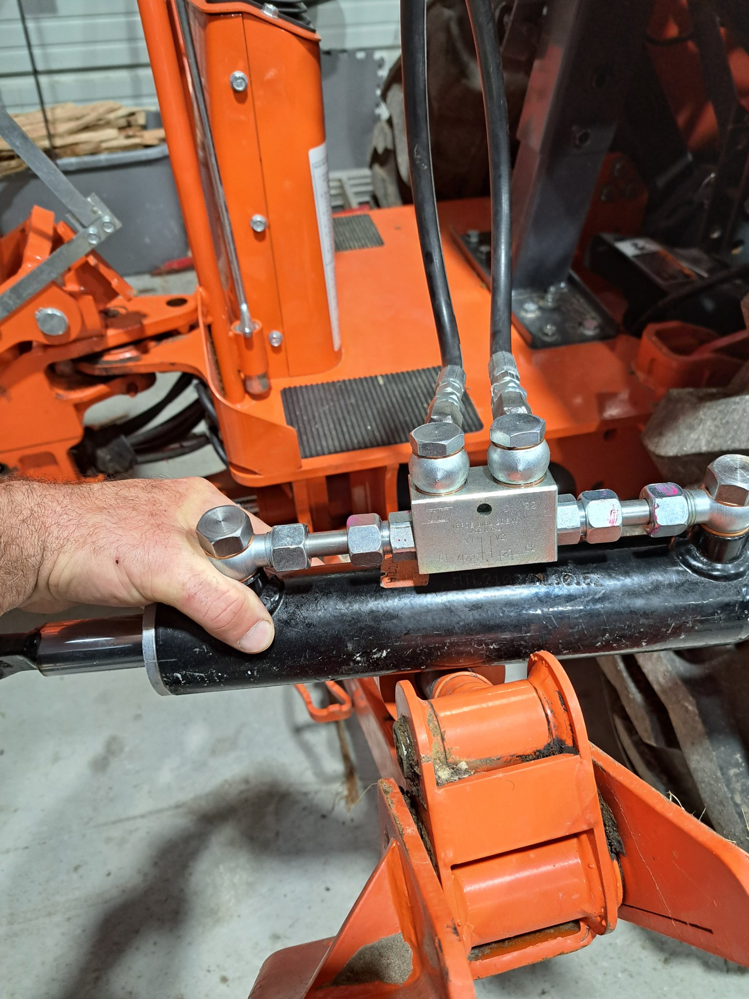

And a pic of the "final product"
I would like to say thanks to all that participated in this little endeavor and especially to Dan for his guidance and expertise.
from this cluster F ( EDIT: the more I look at this top pic, the more it reminds me of something you would see in a Dr. Suess drawing.....(LOL a "Who-Ville Check Valve" 😂 )
to this
