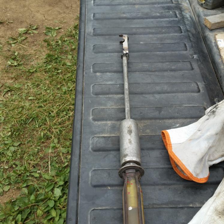

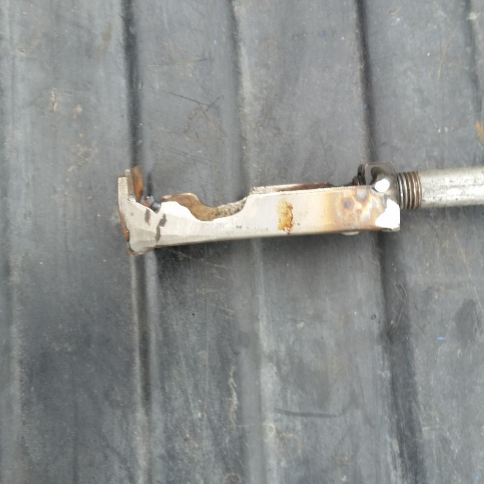

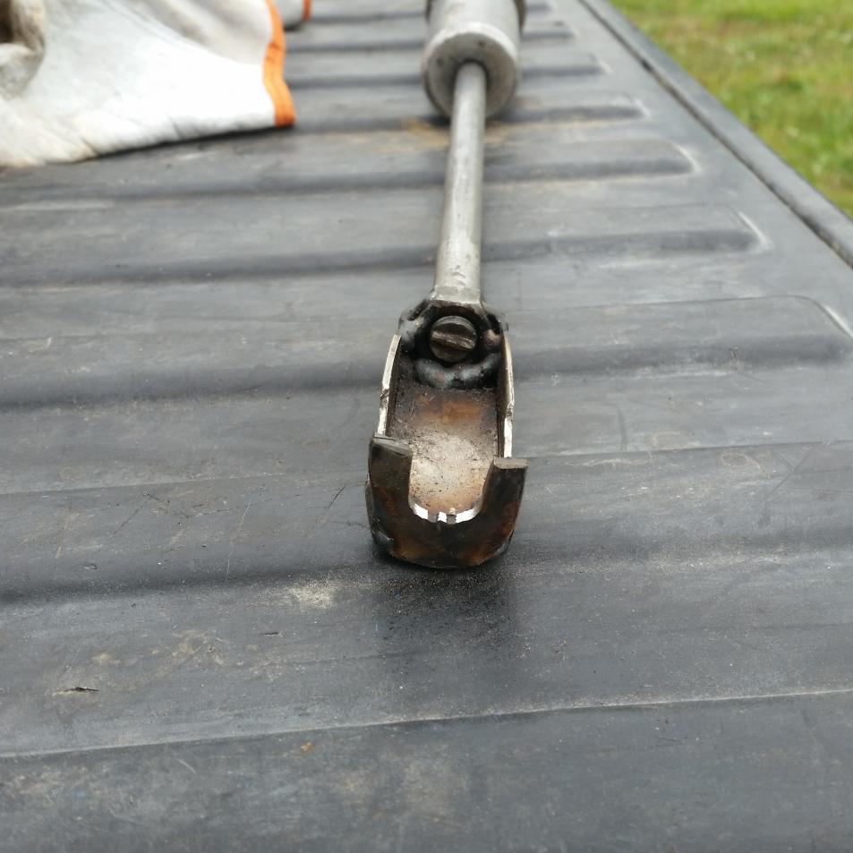

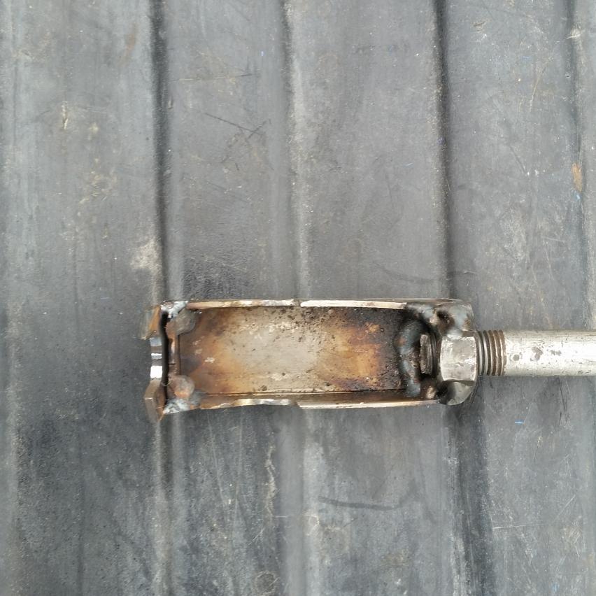

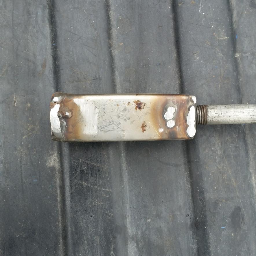

I needed to pull a pencil style injector a while back and didn't want to spend $100 to pull one injector. I had a slide hammer I seldom used so I adapted that and made the end piece of of parts from my "bone pile".
It was a piece of stainless that I modified by grinding where the injector clamp need space to allow the end to fit up tight, welded a nut for the slide hammer, welded a washer on the end and ground to fit in the injector slot.
Not pretty, but I've used it a few times now and it still works.

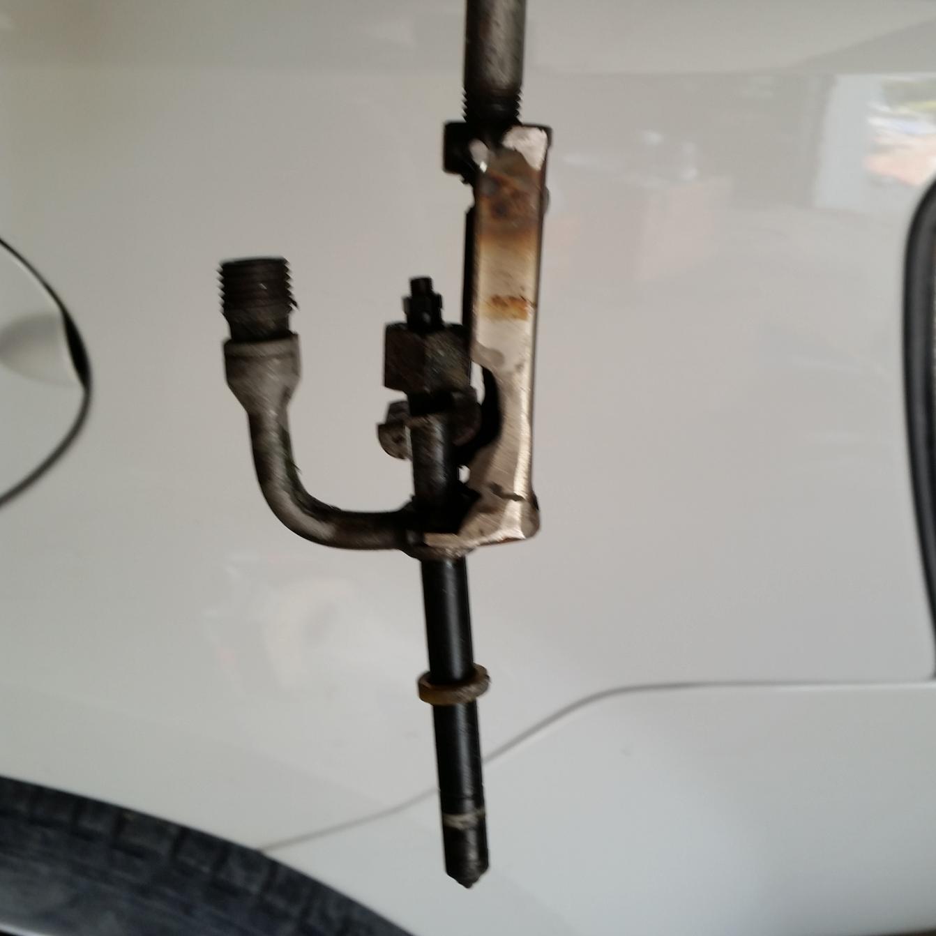

...needed to pull a pencil style injector a while back and didn't want to spend $100 to pull one injector....Not pretty, but I've used it a few times now and it still works.
Can you take a pic of it in use when you get the chance.

Coach, here's a picture of it on the injector. The pencil injectors are held in by a clamp (and a couple of TIGHT seals).
sorry for being a bit dim lol:p Makes sense now.

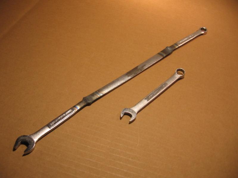

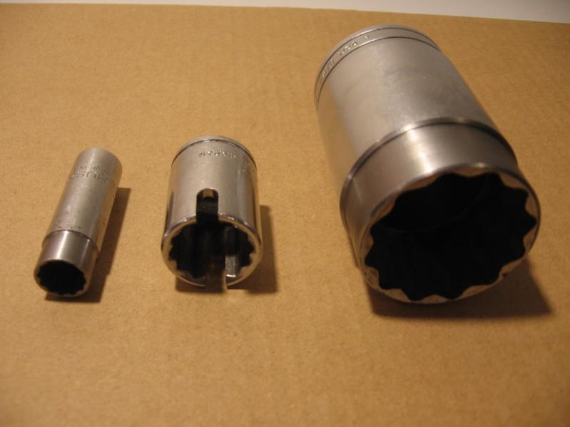

Another thread showing modified wrench for removing glow plugs reminded me of wrenches I have altered over the years.
I have some more, but they're at my place in the mountains.

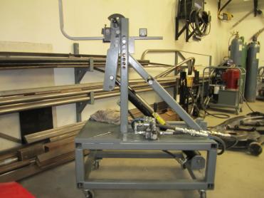

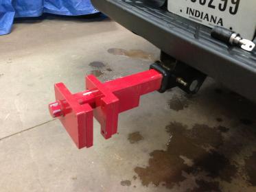

I built a press brake for bending brackets for stabilizers; I've got about $10 in it, and I've bent over 3000 brackets with it.

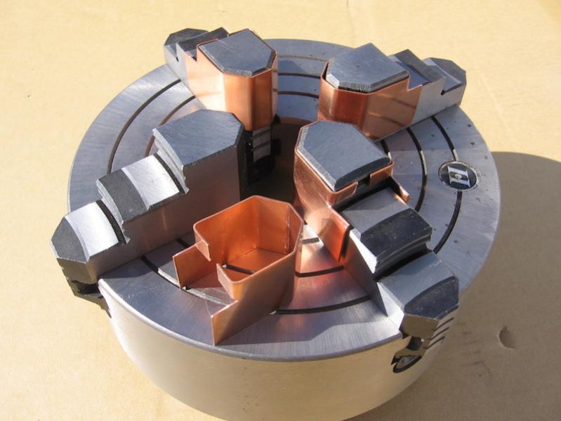

Whipped up some new copper jaw pads for the 4 jaw chuck this morning. I prefer thicker material, but this is what I had on hand.

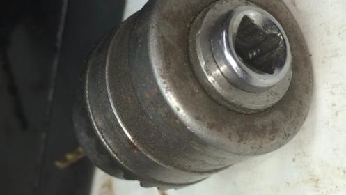

70D32F3B-C57F-416E-872C-400791759ECA.jpg the square adapter to fit a 3/8 drill chuck. Goes in my air ratchet. 1/4” drive. Made from a broken extension. Very handy.

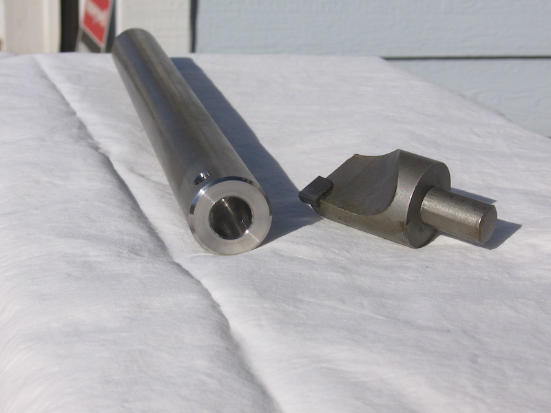

Needed a 12" extension boring bar holder, so I made this from some old ground stock I had in the stash. Nothing exceptional about the job, (cut to length, face & chamfer both ends, drill & ream .500 x 1.200 dp, drill & tap hole for 1/4-28 clamp screw, deburr) but the material made it challenging- Inconel 718.
It's probably been 15yrs since I worked with this stuff, and it was just as PITA as I remember, but a fun challenge. And I didn't have to buy any material.:)
