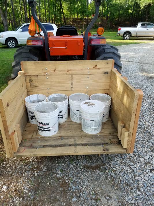

I built a carryall to use for misc. chores and to oalso use as a ballast, multipurpose.
I built the box which weighs in around 200 pounds then filled 5 gallon buckets with 80# of cement each, cost 4.00 per bucket, I can add as many as I need or remove as need for work I intend to do.
Currently I have found that 6 buckets give me 480 pounds and the box 200 pounds total weight 680 pounds of ballast.
Just an idea for you total cost less than $200 bucks and the uses for the carryall unlimited.

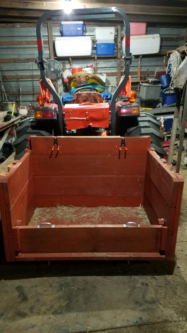

Second, I stopped doing any further work and picked up a ballast box right away the next day, now realizing my oversight and the concern about safety. Its a B5320 box - I filled it with gravel and based on my calculations, I believe it weighs about 400 lbs. (according to the B2601 manual, my 3-Pt Hitch can only lift 660 lbs). in addition , my back tires are filled, and I also put aside a couple of really heavy granite rocks I dug up on the property that I can add to the top if needed.
I went back at the gravel pile and it was a world of difference. Very stable over the bumps and uneven terrain. Wow. I also took the unit deep into the back woods to grapple some branches and blocked wood piled there, and it is really uneven terrain back there, as you can imagine, and the tractor stayed down and stable as I lifted and carried debris without any "scary" moments, even on really uneven ground.
So,Happy Ending!
Thanks to all of you for taking so much time to stress how important this is. I am hoping now that it has its own Thread, that this will help other people new to tractors like me, because, honestly, if you hadn't all jumped in on this Thread and provided me all this info, I would have just assumed that the tractor coming off the ground was just normal and would have assumed that I didn't need Ballast at all.

Very nice. Looks good.
