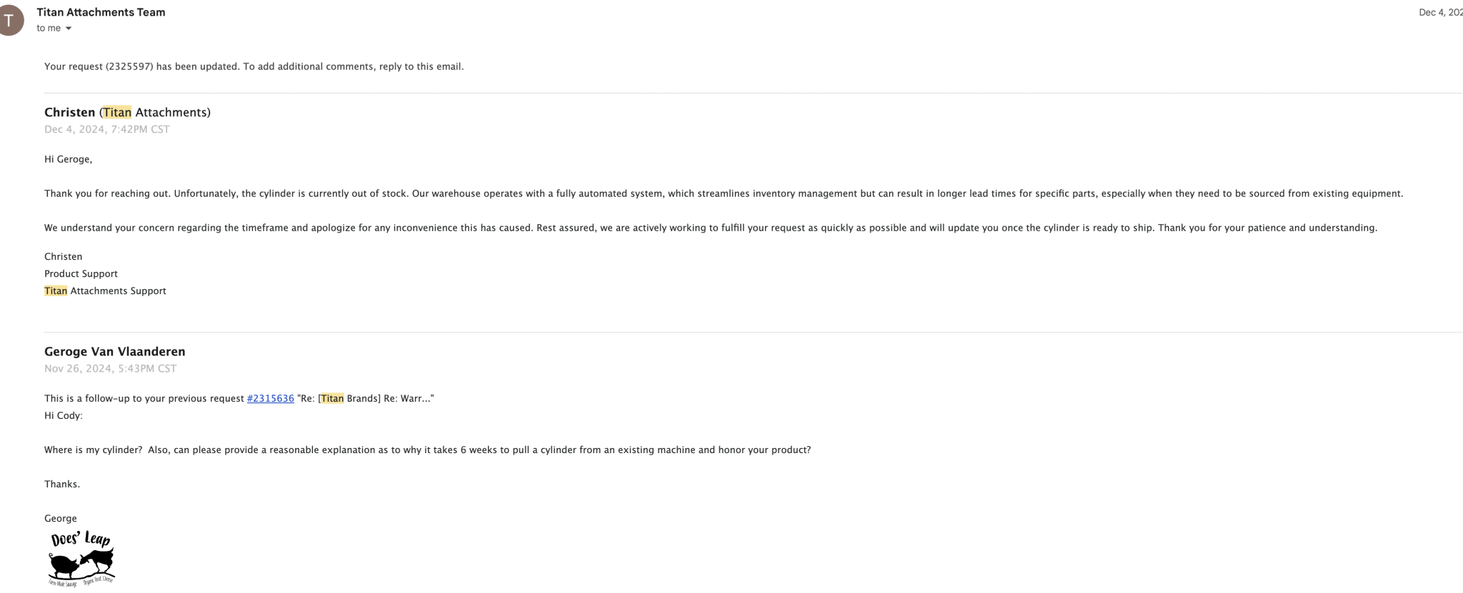

I don't usually do this sort of thing but I want to share a terrible experience that I have had with this manufacturer. I purchased this round bale grabber back in August https://palletforks.com/products/ro...ygHFnAIxz7kdf4BIWppfK0wanrrBxkYQaAmuWEALw_wcB
I tried to use it for the first time to unload a wagon of round bales in October and the cylinder was bad. We had to chain each bale to get it off etc, etc. I filed a warranty claim on 10/14/24 asking for a new cylinder. I have sent a total 8 emails over a 8 week period and I am still waiting on a replacement cylinder. I finally filed a dispute with my credit card company and we'll see what happens.

I have called numerous times. Here is the a latest communication:

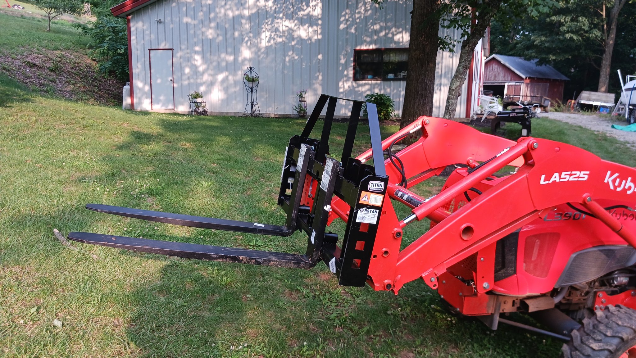

In the last 3 years I have actually purchased two items from Titan.
One was an SSQA adapter plate and the other was SSQA pallet forks. Both times delivery was very quick and the quality was quite acceptable. Maybe I am just lucky but I would not hesitate to buy again.

Pehaps you should take two minutes to actually check before you think in public. Titan has three offerings, economy, standard, and pro.
I purchased the standard duty and they are more capable than the LA525 loader they are used on. The Pro model would be a waste of money and added weight the loader can't spare.

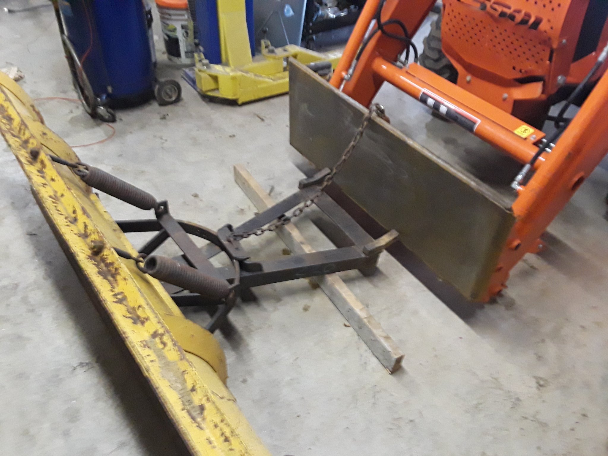

The SSQA adapter is 3/8 laser cut plate with a press brake formed perimeter all around. More than adequate for the base of my shop made snow plow mount. Also heavier and stronger than the SSQA back on the OEM loader bucket.
