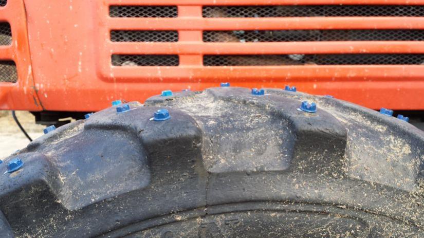

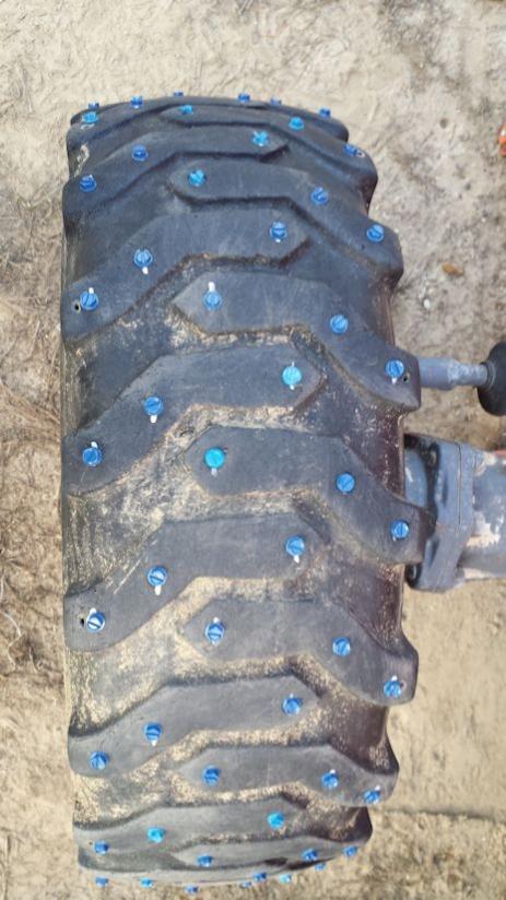

It was raining and sleeting when the temp dropped to the negatives, then some snow and warm and than cold again, Heck I could have a bob sled team practice on my drive way. It's not bad to get up it in the truck in 4 wheel drive, or the tractor with front studded tires. You could do this if your tires were foam filled, Killer traction!

hey wolf,
where you get those? They look like Tapcons! Aluminum concrete screws......
if they are - you be a genius !!!

DING, DING, DING, we have a semi winner! 85Hokie
Yes you are right they are Tapcon's, but they are not aluminum, they are hardened steel, very tough!
There are companies out there selling the same sort of thing for almost 10 times as much! I went the cheap route.

did you do anything special INSIDE the tire? and or did you drill a pilot hole? or just nut them in the rubber?:D

The real key to doing studs like these is to have your tires foam filled, then the screws screw right in and bite really well, I don't think that it's possible to pull them out of the tire!;) And yes they are 5/16" x 1 1/4" long screws. I thought I might have to go up to the 3/8" size heads to get enough traction out of them, but the 5/16 heads work great.
If you have air filled tires I wouldn't recommend doing this, as... well... you will have flat tires :eek:... HAHAHA :D
There are several companies out there that sell screw in studs that do work with air tires, just be prepared as they are not cheap to buy and because they are shorter they can pull out a lot easier than factory studs.
If you have a deep enough tread you could go with shorter screws, but I have not found any short ones that are hardened.
They do sell studded industrial tires from the factory, but they are expensive and I hear they don't last long.
