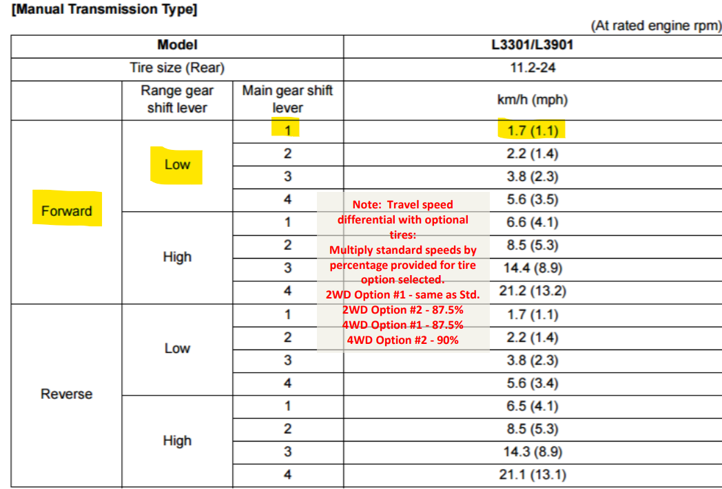

Looks like it should be about the same speed as my L225. You should be able to hop off and have a smoke before it get to the end of the garden...LOL And yes run it at 540 PTO RPM. It helps a lot if there s fair amount of moisture in the soil too.

Yes and it should take about 12.5 sec to traverse 20 ft. if he has 12.4x24 R1 tires. Even longer if smaller tires.
That is if the OP is using low gear and low range. To be honest I often am in a higher gear than low when tilling better soil, but hard clay and rocks it is low gear and takes many passes.
