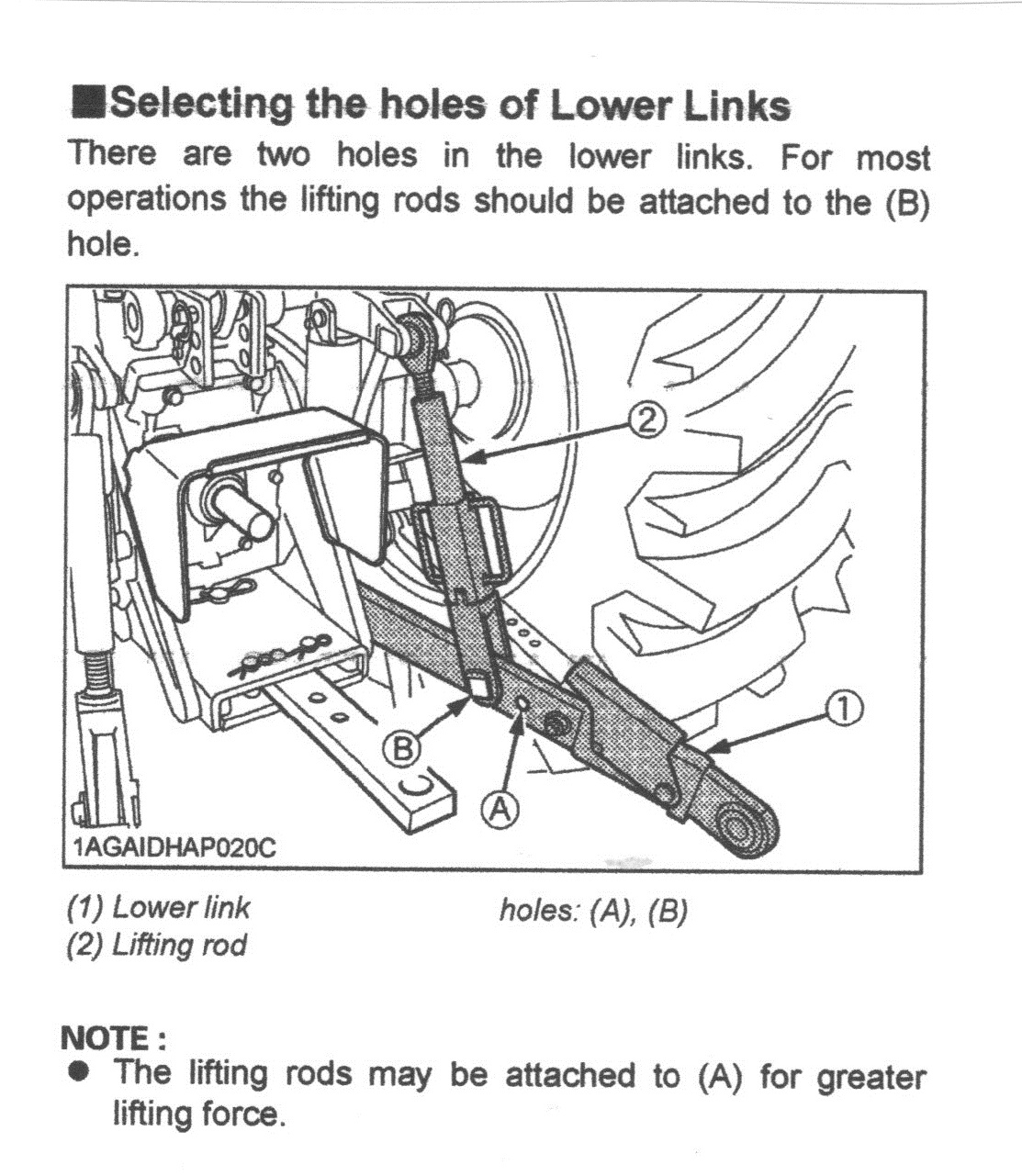

There are two holes in the lower lift arms. A & B in image below.
Make certain the lift rods are in the same hole on each side.

Dave_eng, nothing bent. Both rods in the forward holes.
