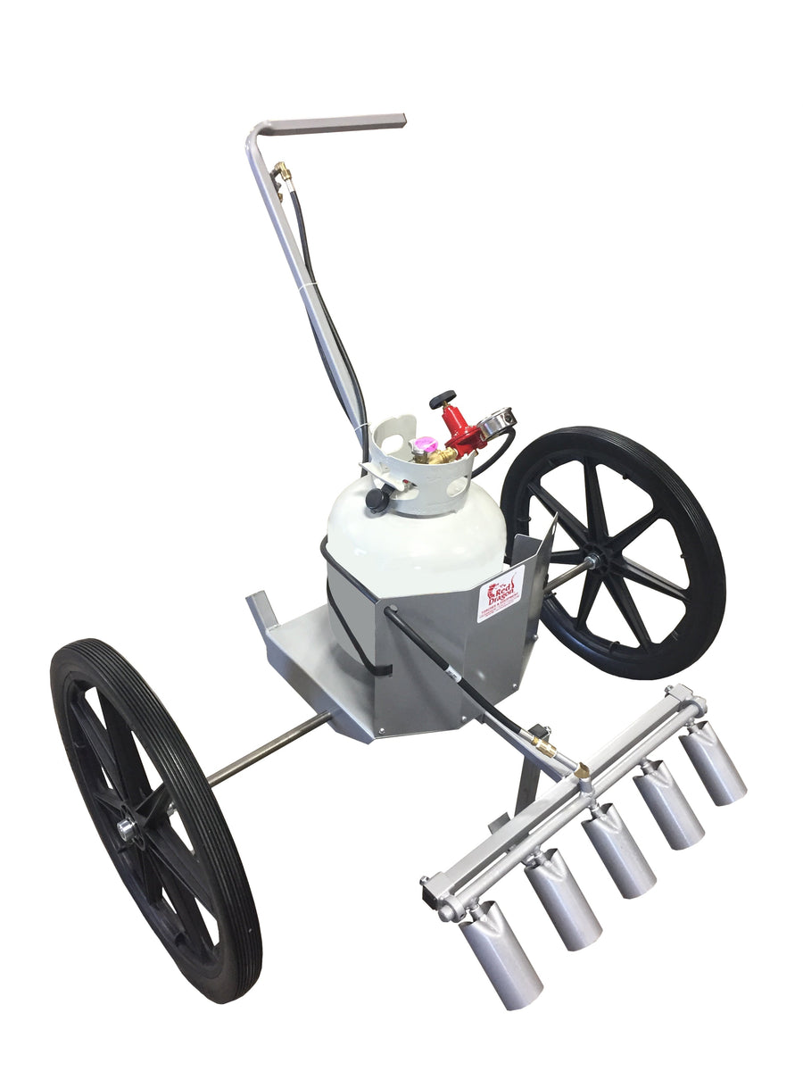

If you have a large area to cover, maybe consider a cart type. I’ve seen them, but don’t have one. Just a thought…
Heck he’s got a tractor so he might as well go with one of the pull behind agriculture models!
