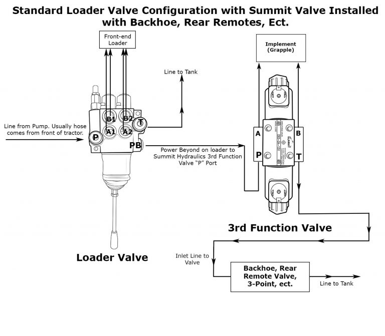

Thanks everyone so far for your help/replies. To make things more understandable I found a picture of the way I have it plumbed in as well as the valve. The directions that came with the valve kit showed basically swapping the hoses on the p and t ports, which I didn’t think was right so I installed as the diagram below shows.

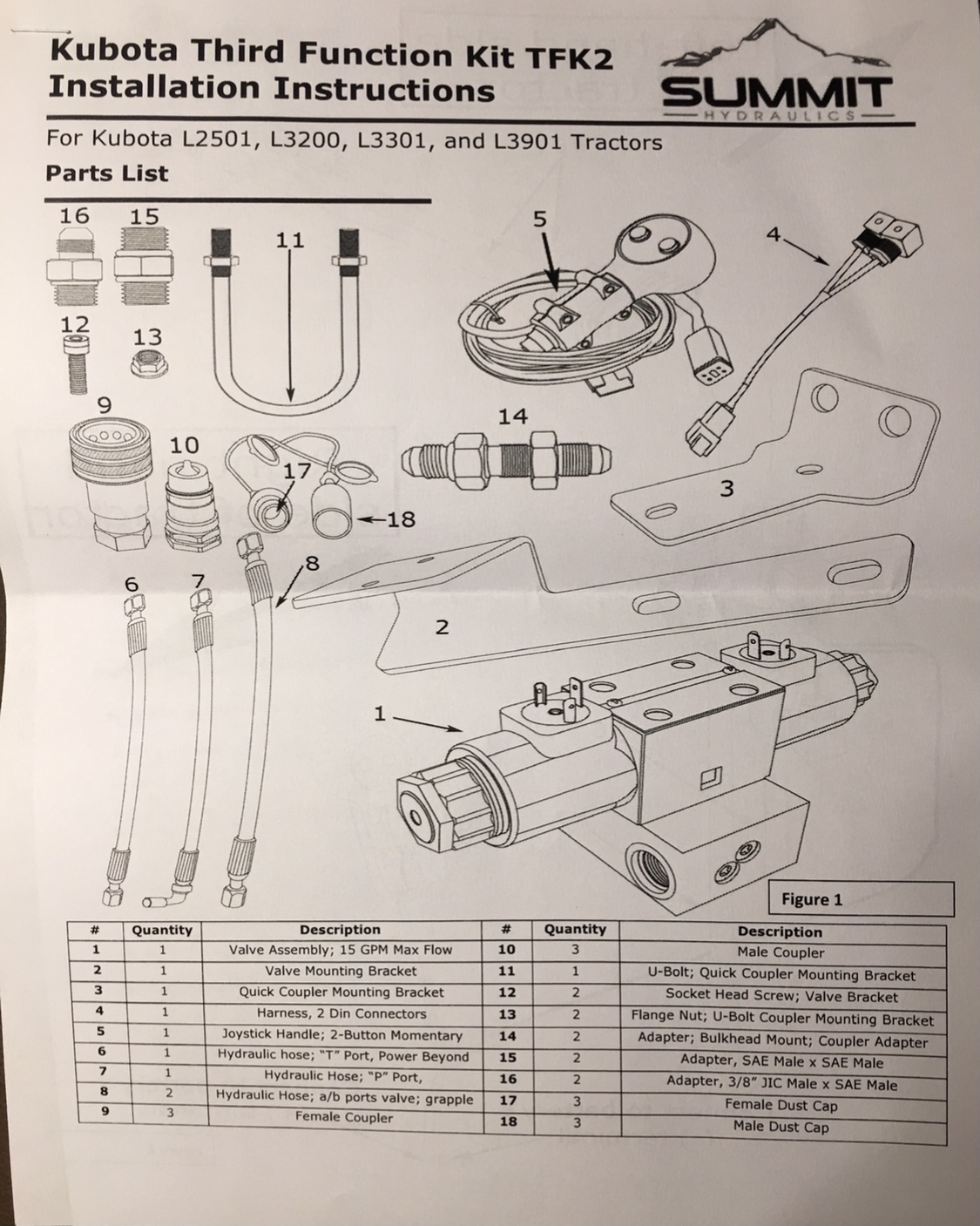

Installing the Summit 3rd function kit on my L3901 now, instructions say exactly as OP describes
Thanks for posting, beat me to it. The directions have you routing flow backwards through the valve. As the power beyond from the loader valve should feed the p port in my opinion. Not sure of the reasoning to feed through the t port. I plumbed mine the opposite of way the directions said. Just wondering if I’m missing something and should have followed the directions.

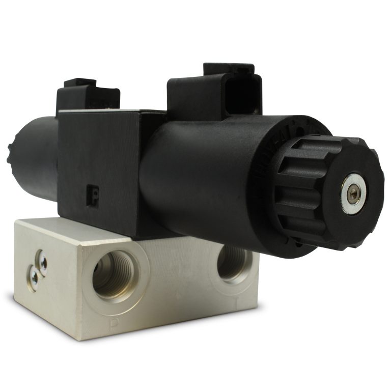

The valve in your diagram appears to be a single spool solenoid actuated open center directional control valve with no power beyond functionality. It will "work" for the most part as plumbed but is not the proper valve or plumbing for the circuit. The proper way would use a third function valve with power beyond port as shown below. Summit sells that kit less hoses and brackets as a "universal" third function kit for $459.
