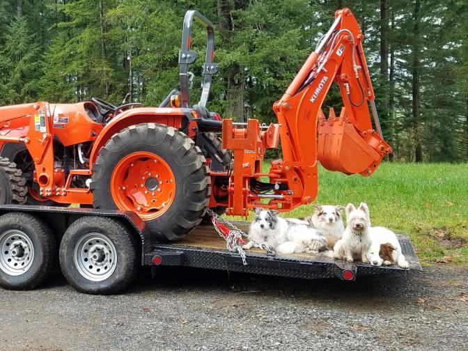

I have a BH92 with a hyd thumb on my MX4800.
From an economical point of view, it probably is wiser to rent one.
However, I live for enjoyment of life, and I enjoy my backhoe. It is easy to put on and take off, (the 3 point takes longer... if the stabilizers where pinned instead of bolted it would be faster).
I enjoy my equipment, it would probably be more economical to sell my small tractor (bx2660) and get a lawn mower, but I enjoy my BX, it is a handy little tractor.
Probably more economical to go out and buy an apple pie, but owning a stove, pie pans etc, and having a loving wife who enjoys baking me one is far more enjoyable. (I do love apple pie).
Sure, my BH92 spends a lot of time on it's cradle because I have other equipment mounted on my MX, but when I need a trench dug, need to remove a stump, need to clean out my canal, etc. I have the tools, and I enjoy using and maintaining my equipment.
For me, it is well worth the price, and I am having a bunch of fun with it.

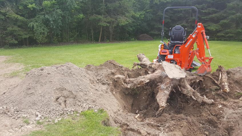

Hi Stil190
It has been a learning curve, but much faster now that the start. Some of the stumps came lose quickly but the BX23S struggled to get it out of the hole. Generally, if I guessed, I would say about 3 to 4 hours. Some less and some more. Some of the smaller ones were worse than the big ones. I had a crab apple tree beside the house and I don't think it took 15 minutes. But if you can grab the roots a few feet from the stump and curl the bucket to snap the roots one by one, you are golden. It can be a bit messy, but for me, trying to pop the roots too close to the root, caused me to waste time. I hope that helps. But I agree with others on here, the BH is used much more than I thought it would be. With the mechanical thumb, I can pick up a decent log and take the chain saw to cut it up. I think you will be pleased with the BH.

Here is a picture of the BX23S with one of the stumps.
I can't imagine being without the BH now. Great seat time!!

That’s pretty impressive with a BX!!! I’ve dug a lot of stumps with a decent sized mini excavator and it’s no easy task. Who says little tractors can’t do big work! Nice!

Wow. Very impressive work for you and your tractor. It sounds like you would also add a thumb to the BH?
Thanks for sharing your experience. It helps a lot in making my decision.
