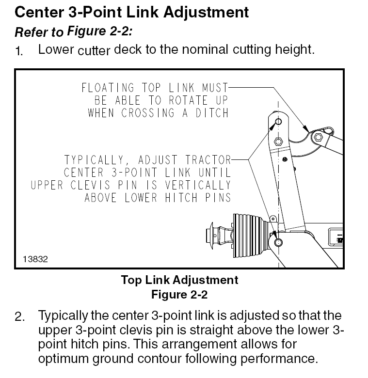

The earlier comment made by someone else regarding “compression” of the toplink can still be a concern. There’s an excellent video by AsktractorMike regarding how to avoid damage using a rotary cutter on the subject….but the bottom line is to use a swiveling bracket on the top pin of the shredder that will allow the tractor/shredder combo to drive into a swale and not damage the shredder, the tractor, or the PTO driveshaft when the swale creates that compression. I’ll try to find that video and post a link.
This entire video is worthwhile…but ESPECIALLY look at approx minute 7 and how to tear up a PTO shaft in a “swale” or “valloy/draw”. Notice Mike does NOT use a TopLink. If you DO use a TopLink… you should have a swiveling link-pin-attach (such as Mike has on his shredder) on your shredder to allow the compression to result in a flexible-connection so as to avoid damaging your TopLink or your implement.

The LP RCR1884 cutter has a floating top link which reduces stress on the 3-point center top link.

Lotta speculation about driving into ditches and implements and such…
I’d love to understand better how a compression load has stretched the side of the heim joint that only sees tension loads 👂
So would I.
